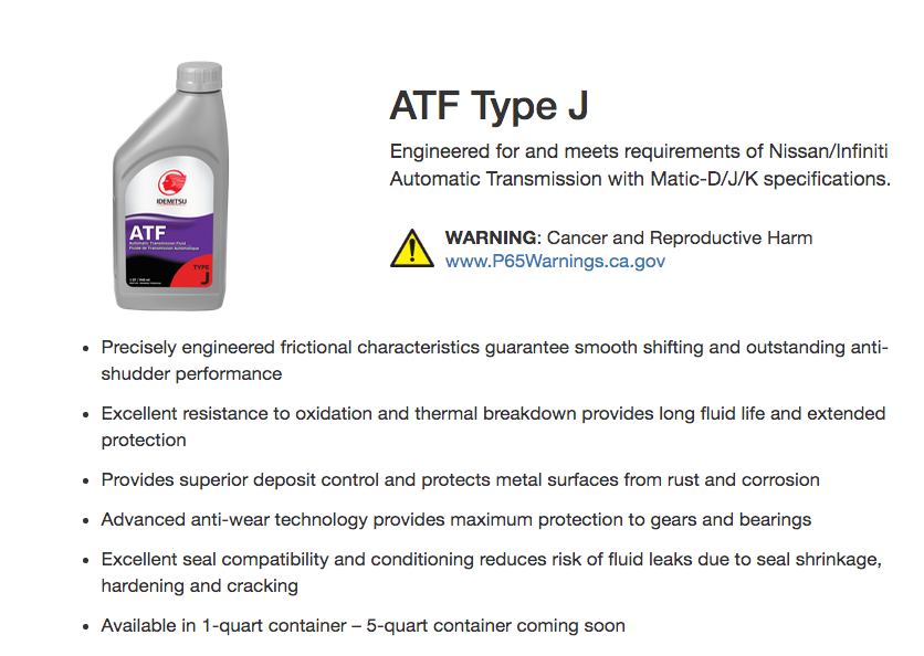

EDIT: Looks like edits blew away my other post. Had this happen on another forum too.
https://www.idemitsulubricants.com/product/atf-type-j

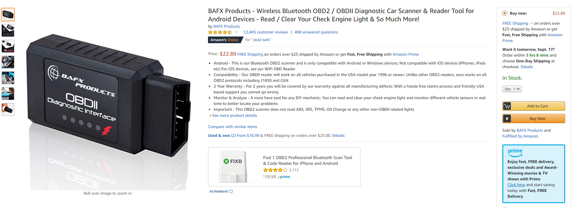

I received working adapter today. Observations:
• Would not pair with IOS.... I haven't had one that wouldn't pair in years. Said it was unsupported
• Paired up with my Android devices but took longer than usual / that being said it seemed to be quicker to connect than of the adapters I have
• Still no dice on access to AT ECU.
Hopefully we can find someone with a '07-'08 X model who can validate that issue is some kind of incompatibility with AT EVU or just some one off issue with my G. I have no known issues with my G. It is a 1/07 build.

Actually BT and the OBD Fusion/Link with my iPhone 7 works great on my Mazda CX-5 and Lexus GX 460. I can connect fine to the Infiniti... it just can't scan for any AT PIDs. It finds most of the other ECUs IMO: There is something here beyond the mobile device and connection method.
So far the only reported success is with OBD Fusion, 2007 G35 Journey and this adapter---->
Amazon Amazon
On IOS ...base software is $10 and then $10 for the model year specific expansion pack
https://apps.apple.com/us/app/obd-fusion/id650684932
The following is the official OBD Fusion/Link adapter. It also can't find any PIDs for AT ECU. Whereas with Fusion you have to buy every model year (assuming using 3rd party adapter)... if you use Link they give you all of them for the included price of the following Link adapter.
Amazon Amazon

Got my new Ultra Gauge ordered, but they didn't have it available with preprogramming for Infiniti, so I got it preprogrammed for Honda CANBUS and will tweak it as needed. The only thing they tell you to do is to get one with the same protocol as your car (CANBUS in our case). Also ordered the firmware update for my ScanGauge and will be sending it in tomorrow. Once I get it back I should be able to read the PIDs from the original post. I got Fusion downloaded and a BAF-X Adapter is en route. Once I get the adapter I'll see what I can find and if anything transfers from/to the Ultra Gauge or ScanGauge. I'll update as I find information.

Update: Haven't been able to decipher the codes for the UG yet. I get the ScanGauge back today, so I'll try it out tonight to see if the info from the original post works. I got the BAFX and Foseal OBD adapters and tried them out with OBD Fusion. The BAFX adapter works great, has no issue feeding the transmission data to my tablet. the Foseal adapter connects with the tablet, but it won't link within the app itself and therefore sends no information. I'm going to see if I can hack OBD Fusion on my computer to find the PIDs that it uses to get its info, if I can do that it may make it easier to input the info into the UG and SG.

It works for me using OBD Fusion and a BAFX OBD Adapter. the Foseal adapter hasn't done anything for me, connected to the tablet, but not the app.
ETA: The amazon page for this adapter states that it can't read TPMS. I played with it a little bit, while it can't read the pressures it will acknowledge the tire pressure light and allow you to clear it.

Thanks
ordered a BAFX and will see how it goes

Unfortunately my proprietary '07 G35x seems to want a full blown Nissan Consult 3 to read AT temps. BAFX like others doesn't find any PIDs for the AT ECU.
It will scan through the 0-100 with Fusion but nothing is ever found.
Perhaps it is models with Tech package & Radar Cruise like mine that have issues? If someone has a '07-'08 G35x with tech package I'd like to hear if you can pull AT temps from options listed in this thread.
