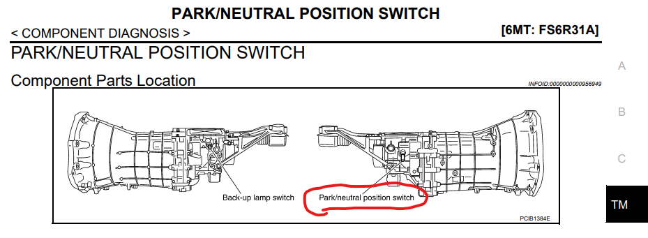

Does your car clearly show on the dash that you are in PARK, try starting the vehicle in both park and neutral, there is a PNP switch on the transmission that might have failed as well.
how do I test that relay inside the IPDM?
