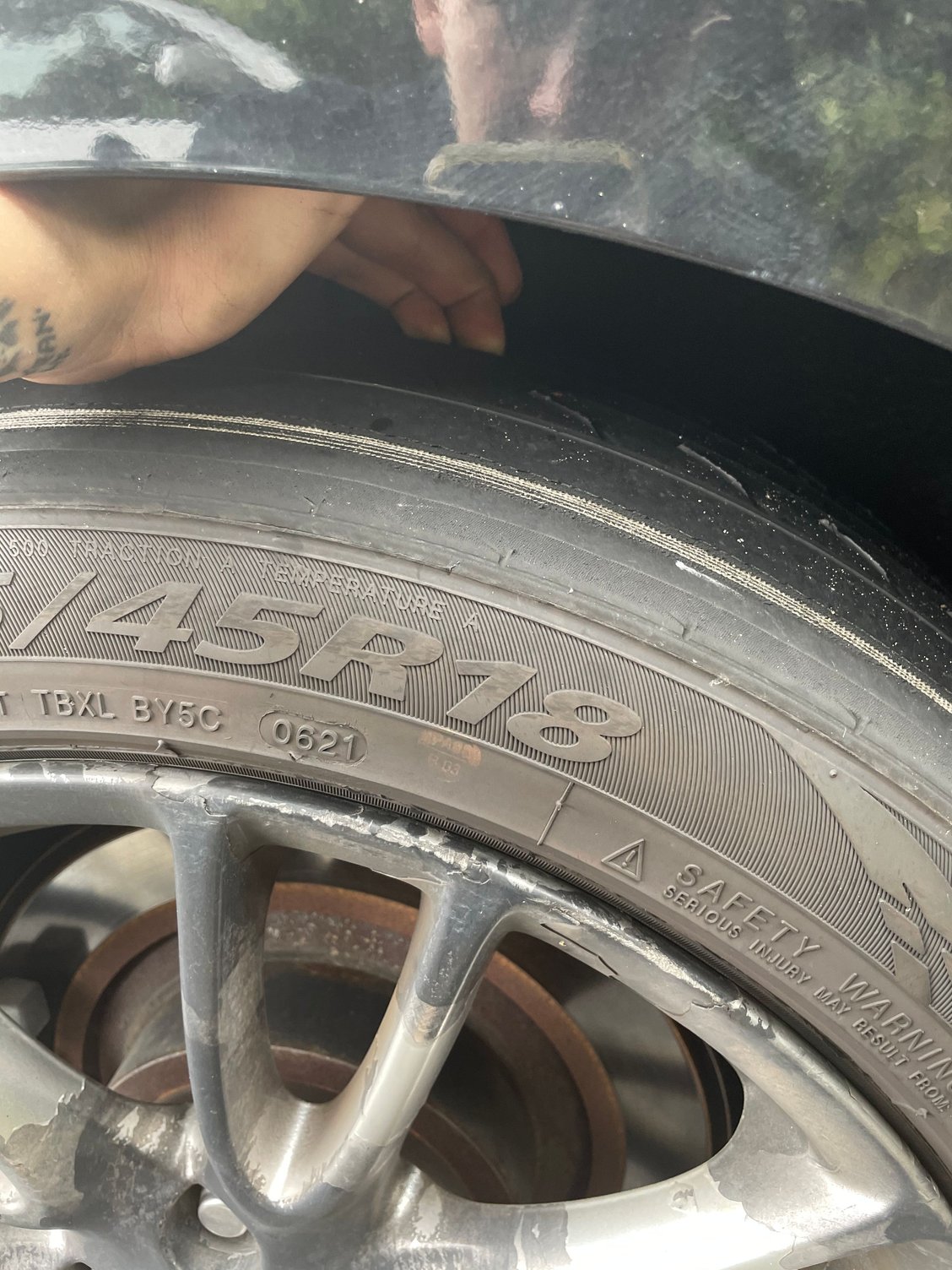

Alright I’m new at this so please tell me if I’m doing this right but anyway,
I recently got a 2007 G35s sedan (manual but I dont think that matters for this situation) and got new tires on July 2nd. The outside tim of the rear tires, more on drivers than passengers, is already bald and/or showing thread. The rest of the tire is slightly worn but not anything concerning. Front tires are doing fine and I got those done the same day I got the rear tires. I’m at a loss and am not too sure what to do or where to start with this issue tyia to anyone who can help out with this.
*photo is of the drivers side tire*

Get to a local reputable alignment center.

Have been drifting or doing burn outs and figure eights smoking the tires? If so the rear tires will wear that way. If not then you have something broken in the rear suspension, or the car was in an accident and you need to get the frame alignment checked and straightened.

Well are you lowered at all? That looks like toe wear.
