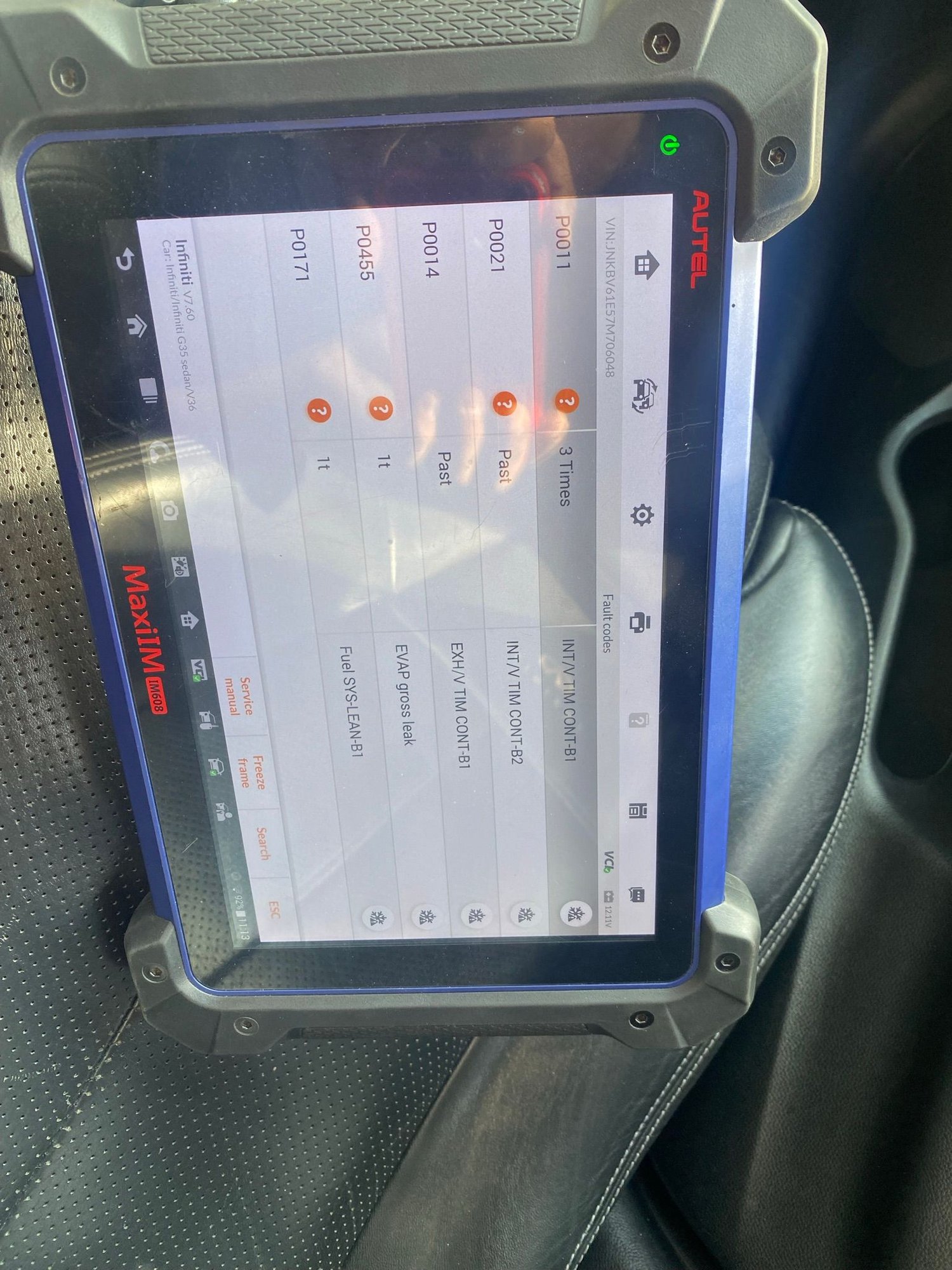

My g35 is in limp mode. i don’t see no problem on the transmission because i can feel the power holding back. only electrical problem that i noticed was that the main 12v charger stops working after a minute. and sometimes lights be dimming a little. i installed a new alternator, battery,4 cam shafts(autozone), crankshaft (dealer), and 2 throttle body (autozone). also did a muffler job on it. i sometimes get like a gas/burnt type of smell. when i let go off the gas the rev needle drops & bounce.
the car drives. i drive it to school every day and put some miles on it. just stuck on limp mode, not letting me pass 3k rpm.

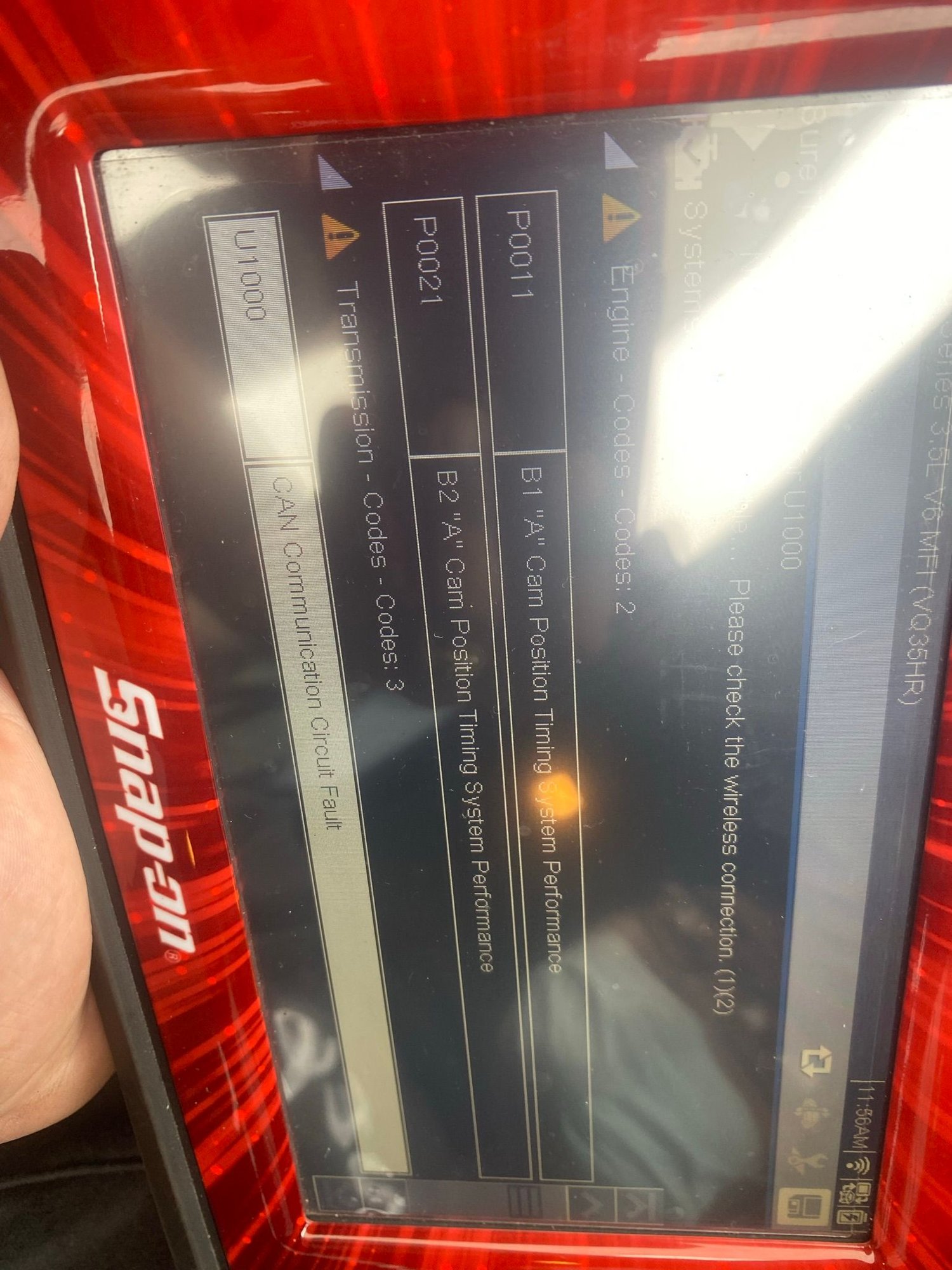

Clear all those codes and see what comes back, if the engine is almost stalling it can throw a whole cascade of codes like those P0011/P0021 as the oil pressure drops low enough to throw off the VCT.

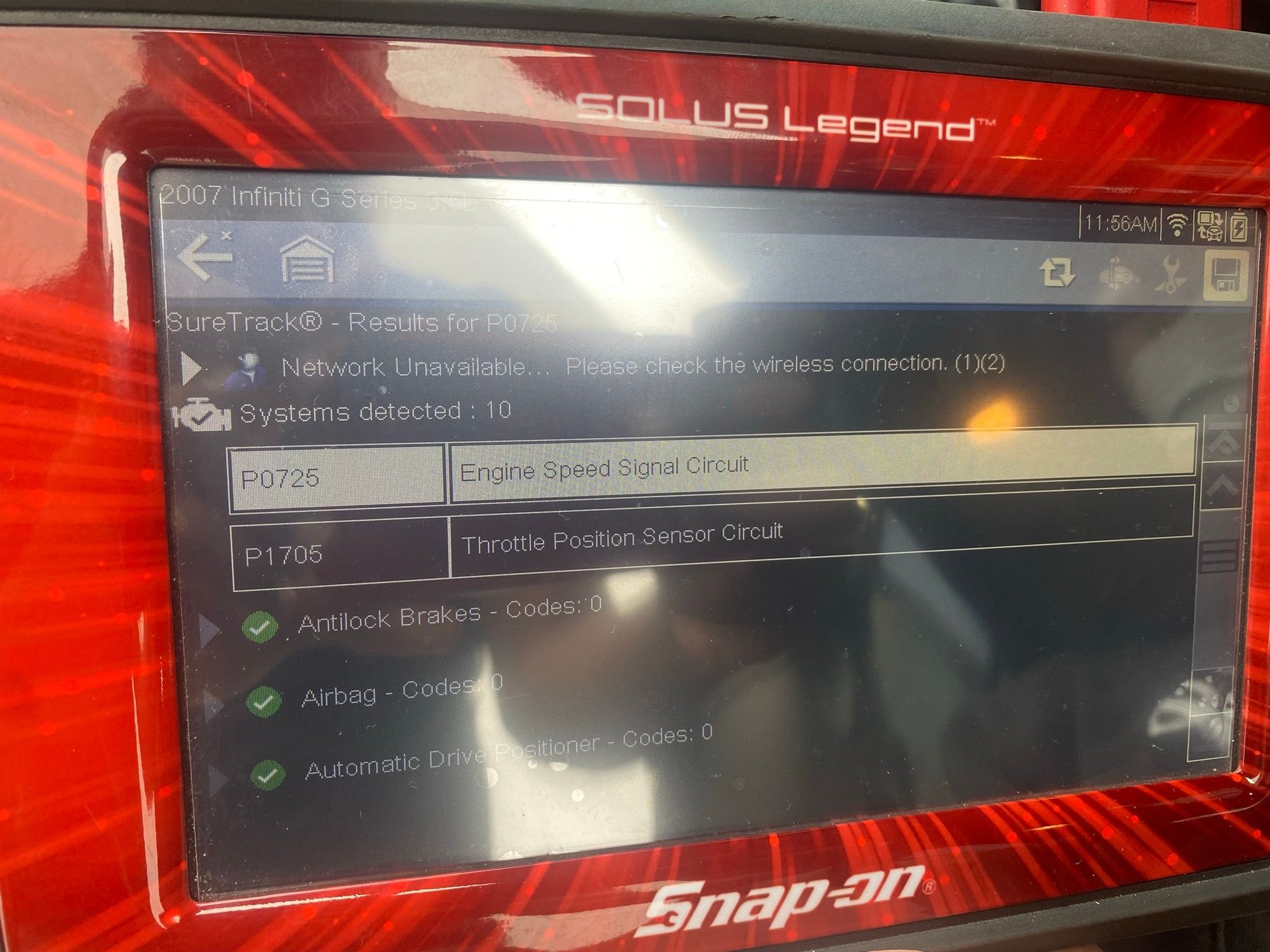

The P1705, P0725 are transmission codes that the TCM didn't receive throttle position or engine rpm data via CANBUS, this can be caused from the engine stalling as well since you are getting a bunch of other engine codes.
