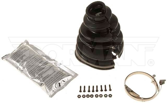

Napa makes an OEM replacement - Part #: UCV CVB556

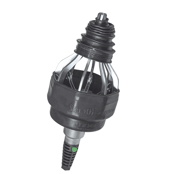

Needs a tool to stretch it , ( or a cone), plus the axle has to be removed . No thanks.
However, the napa part does give us some useful specs though :
Clamp Minimum Diameter Large End 2.885 in
Clamp Minimum Diameter Small End 0.823 in
Dorman makes a split boot - Part # 03613
Here are the specs :
Joint End Inside Diameter: 3.19 in
Shaft End Inside Diameter: 0.87 In
vs the Napa specs :
It's a bit bigger , so it's not going to be an exact fit .
It's made of neoprene . Maybe clamping it down is good enough,.... or maybe not .

Yes and since your boot is already torn it's easy to get an exact measurement for the inner/outer size you need.

Thanks! That Dorman one u posted actually says incompatible with the G35. Unless their database is wrong.

I haven't found one that is specifically made for our cars. As Cleric670 mentioned, we might have to settle with a universal boot that most closely matches ours.

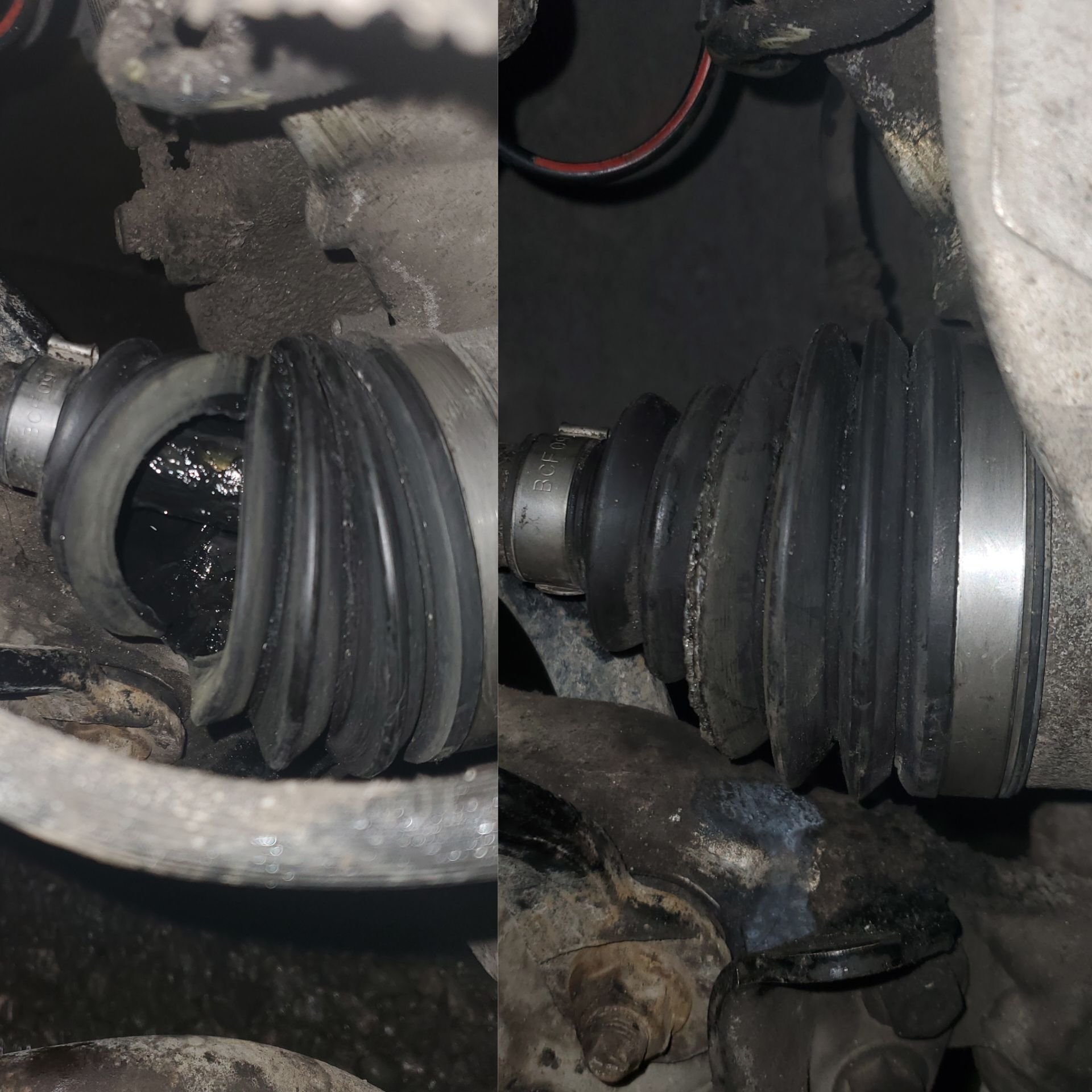

I'm still looking for a good CV split boot. Haven't found one yet. In the meantime, I tried my best to fix it temporarily.
Just be sure to line up the split properly, tighten the bands on each end just more than snug but not OVERLY tight or they'll eat into the rubber in the future (sometimes the kit comes with an irreversible crimp band but the worm drive clamp ones are better I think). I prefer the beck-arnley style that uses a series of bolts down the side of the split on the boot rather than the kind that uses the irreversible crimps that you squeeze with a pair of pliers.
Thanks. For now, I've cleaned out the old grease with brake cleaner. Packed with CV joint grease. Reglued with cyanoacrylate. Sealed and reinforced the joint with permatex RTV black silicone.
