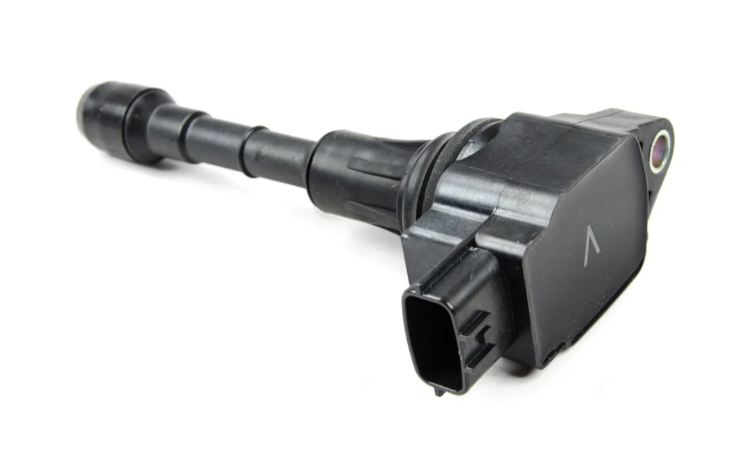

So I was changing my coil pack since I had a Misfire and seen my car has the same ignition coils as a DE and mine is an 08 but the also I looked at my friends 08 coil packs and his has the ones that I attached to the thread is there any reason why my has the DE ones?

Looks like someone screwed up. Throw a set of HRs in there along with new OE plugs. Z1 carries high spark coils for less $$ than OEM. They work really well.

So I tried one of my friends coil packs and it didn't fit so I'm not fs why but I had someone tell me they have a 07 and also have the same coil pack as the ones mine has is there maybe a early model 08 and also maybe a latest model 08? Just how there is with the older DE's?

Someone told me they have a 07 HR and their car also has the DE similar coil packs as mine but if anything does that affect anything?

Yea I have the HR it has the dual intakes put my vin to get the parts I need and pops up the hr coils but my car wouldn't fit those coils

Well they go in it's just the connector won't connect to the coil

Take a picture of the harness, I have a feeling either you got sent the wrong coil packs, or someone has cut/spliced the harness to run some kind of aftermarket coil packs.

Would it matter if it got sliced/cut? The car still runs fine and also I looked up the difference of the volts it pushes through and they're the exact same thing but I will post some here soon if not tomorrow

No it wouldn't matter at all.

OK well that's good because I ended up buying new Hitachi coil packs to try and see if it gets rid of this misfire and hopefully it's not a vacuum leak! But also can a misfire cause the car to idle at 1k? Or is that normal to idle at because I took it to my mechanic and he said its a vacuum leak but my idle needle doesn't drop or raise it was missing a bolt to hold in the tb but didn't seem to fix it next I'ma buy the tb gaskets and if that don't help I'ma just pay to get it inspected
