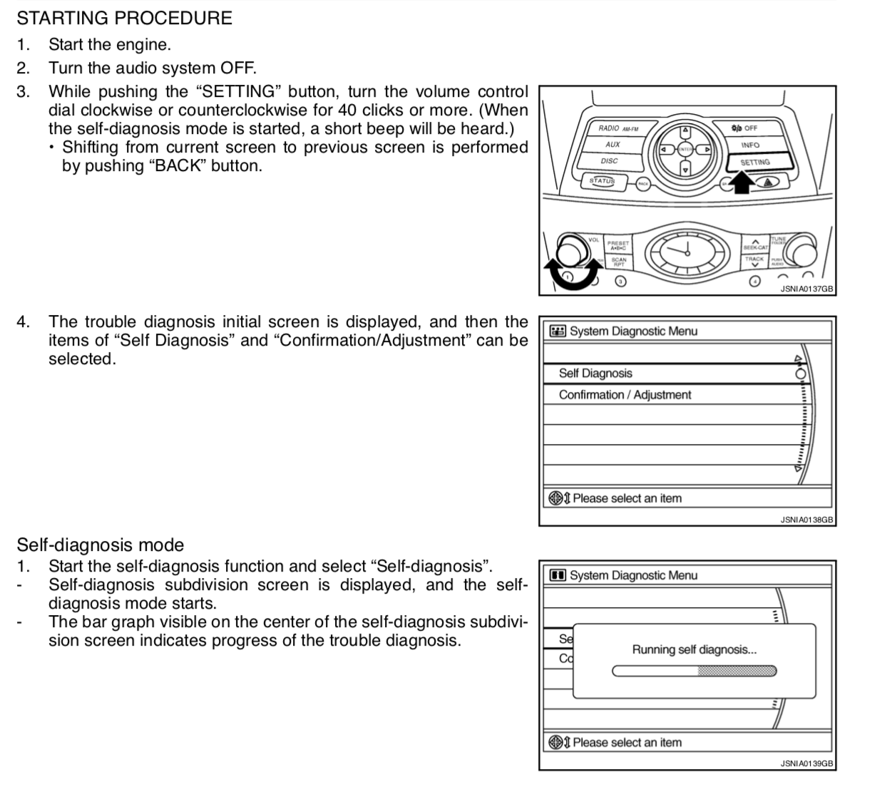

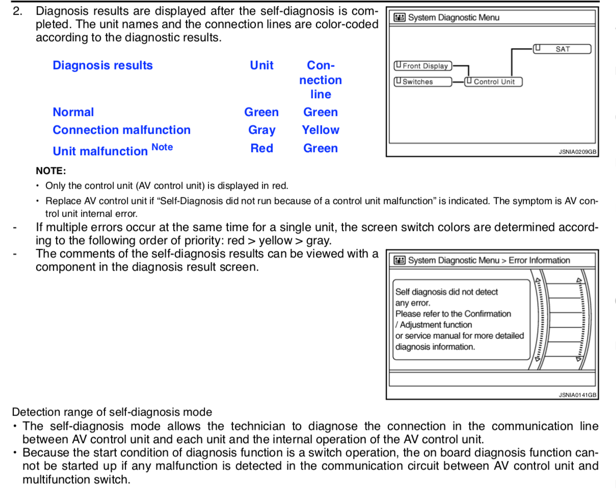

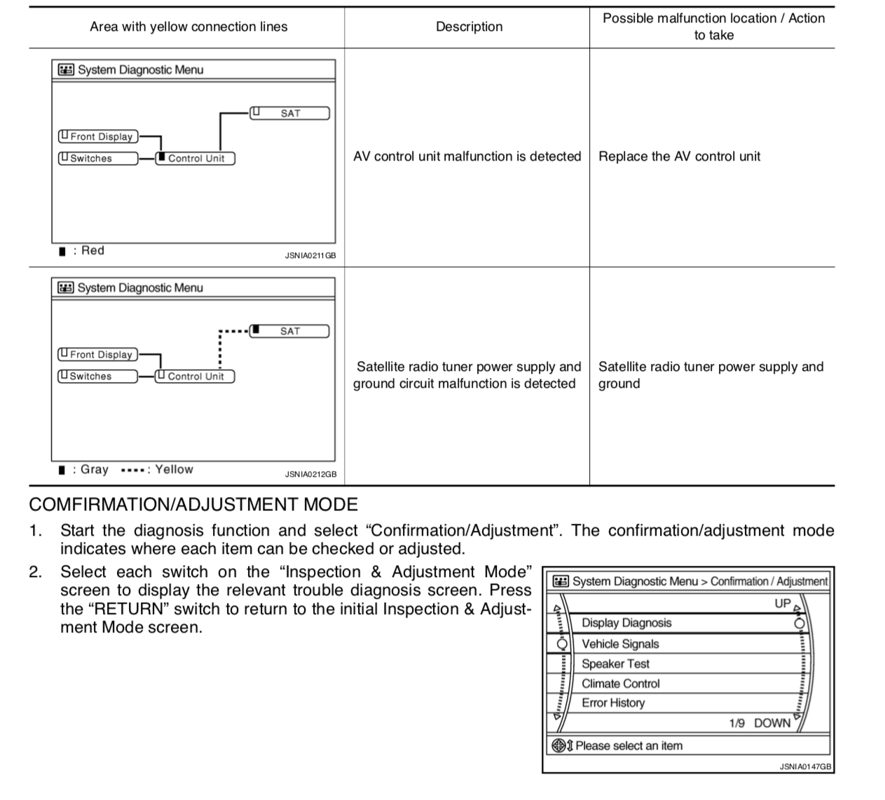

I'd have to dig into FSM but might want to see what codes come up with diagnostics. My pictures from back then are long gone.
Looking back at my nearly 15 year old post
https://g35driver.com/forums/g35-sed...ml#post2441526
"Pressing Setting button and turn radio volume 40 clicks either way. Radio must be off."
