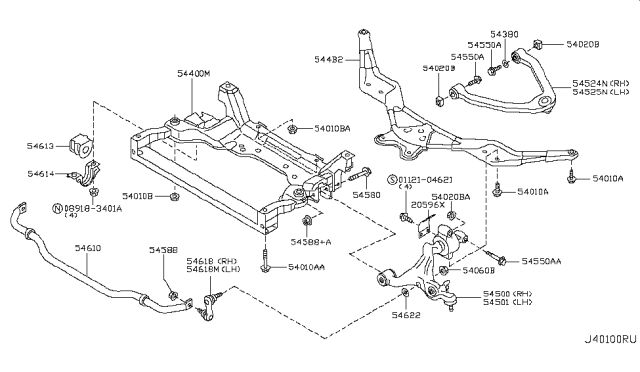

This may not be the exact diagram, but you posted in the V36 HR G35 sedan section. But get the wheel off the ground and see if you can repeat the pop sound by shaking the wheel. Could be coming from one of the many bushings, ball joints, wheel bearings, sway bar end links, etc. just depends on what’s loose / worn out.
could also take wheel off and lightly use a pry bar around the suspension arms to see if you get any odd movement.
In my very recent experience, popping came from the front lower ball joints. Being low wears them out faster too.
