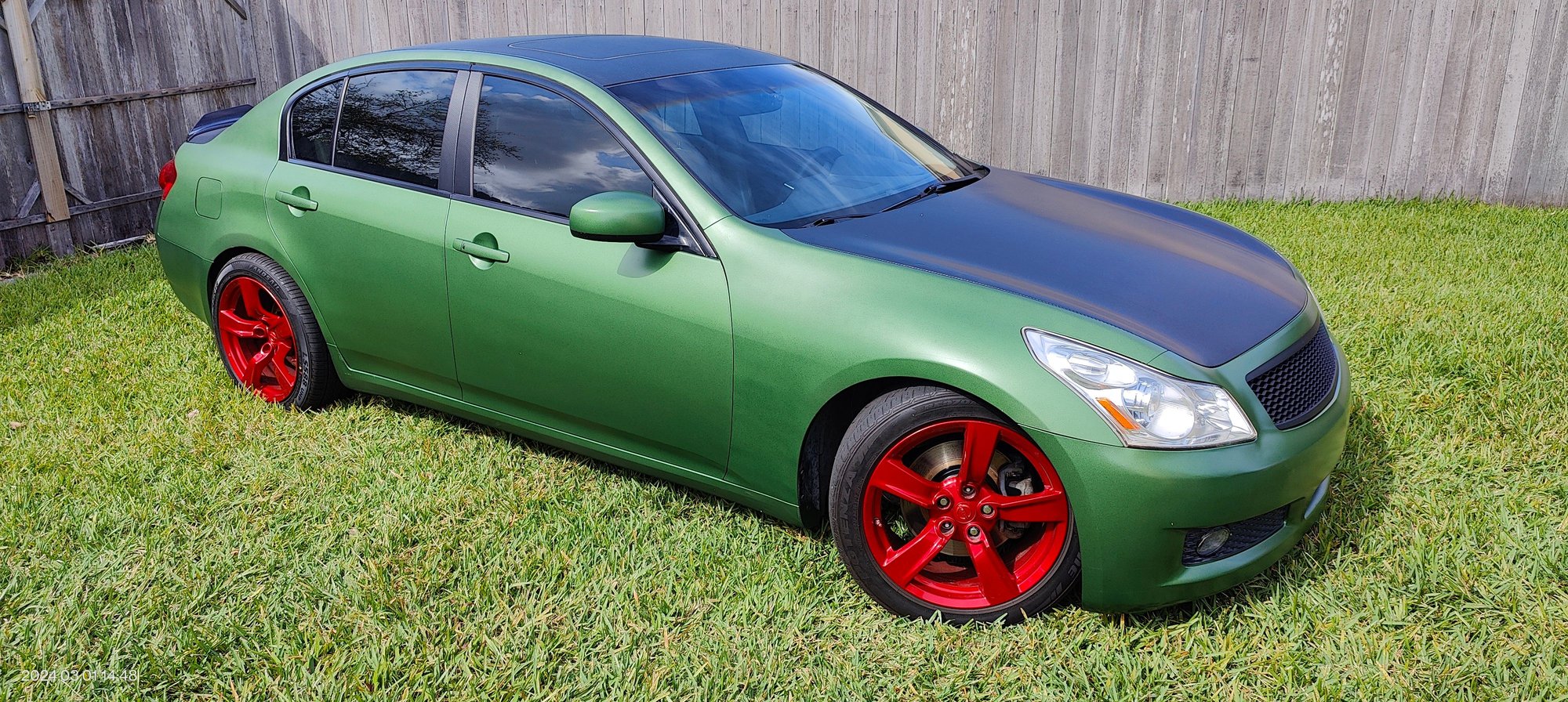

I have a 07 Sedan and i always hear the front wheel bearings on the highway even tho i've replaced both sides and still that humming noise is there. Granted, i do have all Nismo shocks and springs from a 370z and it's 1.5" lowered front nd back and I also have new brakes, straight wheels and good tires.
These V36s were not the best design as to being 'cabin quiet'. It's more of a 4 door 350z than an Infiniti..
2007 G35 5AT V36 VQ35HR Hot Rod Flatz Medium Green Metallic.
