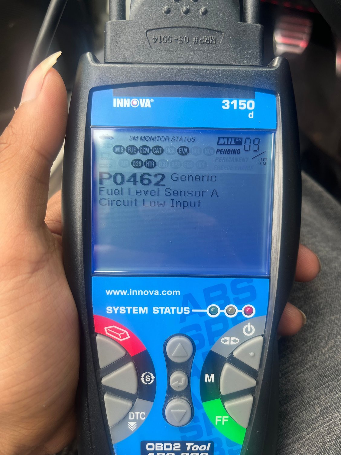

hi, my name is kp. I have a 2008 infiniti g35s sedan 6m/t I have fixed all my issues but I'm getting one error code which is P0462. I have changed my fuel pump already. I have also changed my throttle body's, Crankshaft position sensors, Camshaft position sensor, spark plug and coils. I have also check my fuse box near the battery and everything looks solid and fixed. Now I'm on a dead zone where it cranks healthy and doesn't want to start..... Could anyone help me out and try to figure out what the issue could be???

Sad news, they were not able to work on the diagnosis for this problem today because they ran out of time. There are multiple issues that can cause that code, so they have to work through the FSM troubleshooting steps to isolate it. Sorry. I'm going to try to get it back to them soon, but you may have to chase this on your own.
Have you verified that there is fuel in the tank? If the gauge is not accurate for whatever reason, it could be an issue. Are you getting gas to the injectors?

The gas gauge isn't accurate it has almost full tank and im getting the gauge reading at quarter tank, but the car has gas and the injectors are getting fuel. im getting spark as well. I've been on this issue for awhile now and still getting dead ends
Could be the gauge cluster solder too.
