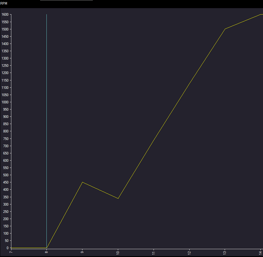

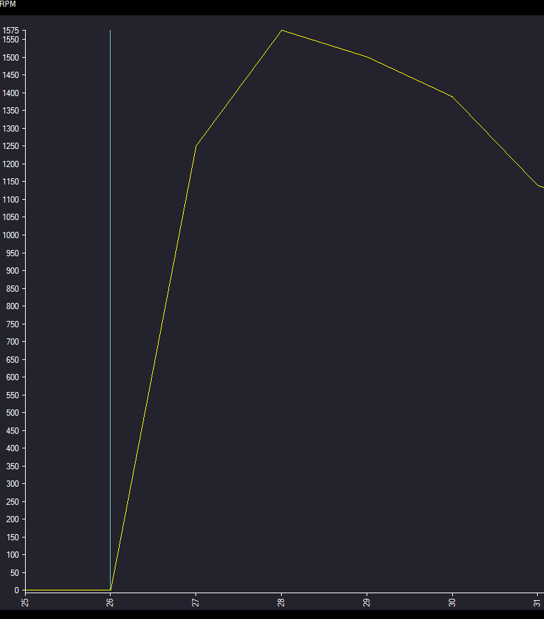

Was able to borrow a scanner and did some realtime monitoring. It's appearing to be something with the crankshaft sensor or at least what that circuit is reporting, as you can see what the monitor picked up on a good start vs what it's seeing on a bad start.
During an extended crank start the rpm's were being reported as being slower and even goes down 100rpm before going back up and engine firing. In reality, the extended crank is as fast or faster than a normal start and never actually slows down while its happening.
Crank sensor is a brand new Denso and the extended crank is exactly like it was with the original. Going to look at the manual for more ideas on what to look at next.
