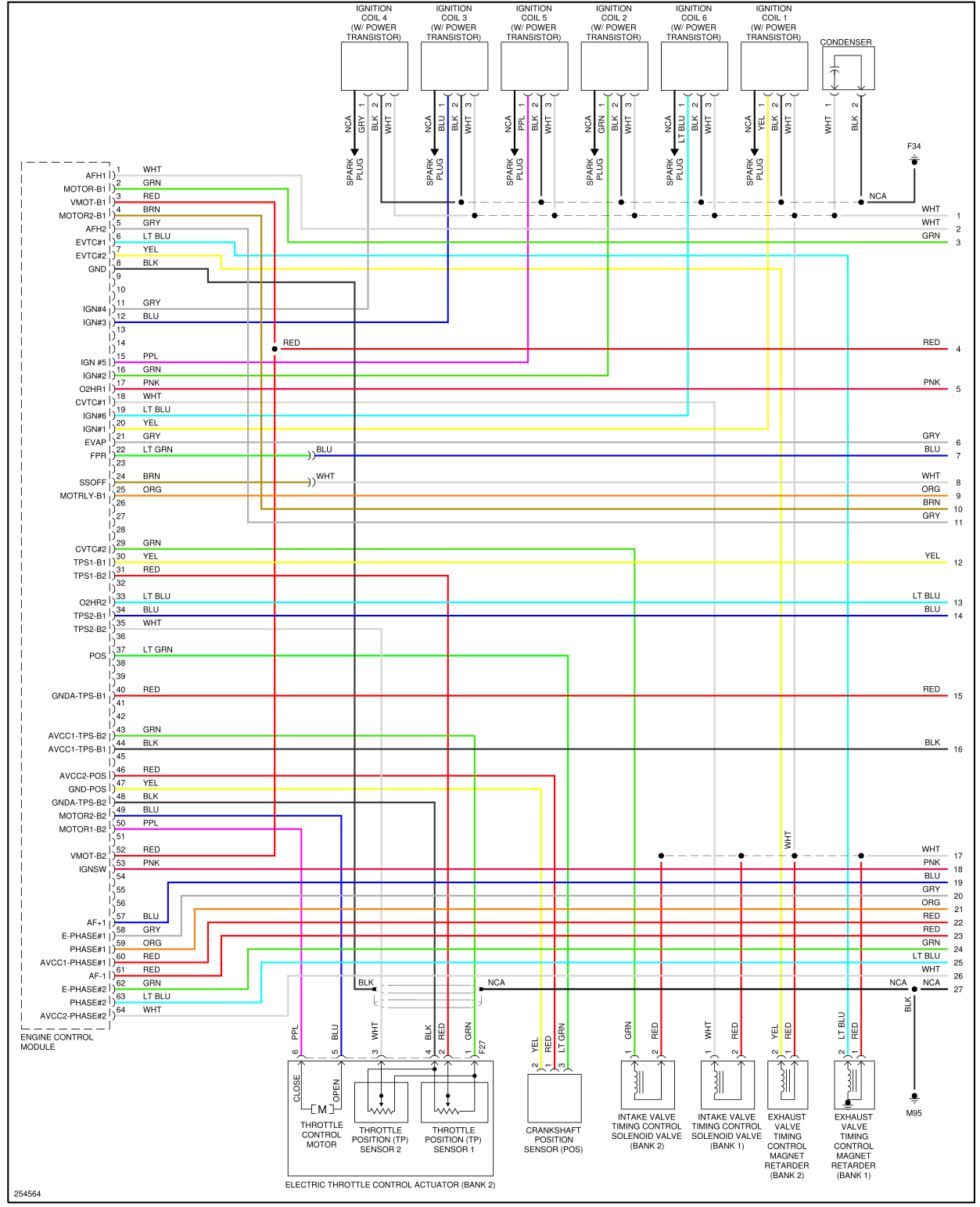

Here is a diagram for your 08 Journey, check the wiring.
Could be the coil plug, the wires on Nissan vehicles are no better than Ford ones after 15+ years..

^^true. double/triple check all the wiring. it gets crusty from all the heat this engine generates. if no dice, then comp test it.

thanks for the diagram. I will start running that down.
