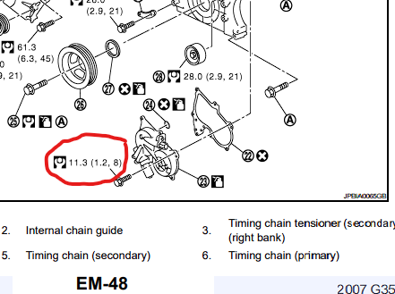

Im going to be replacing the covers with the magnet retarders and looking through the manuals there is an exploded view with each bolt and numbers next to them but im not sure if its in inch pounds or what am I looking at
Can someone explain what the numbers circled mean? Thanks

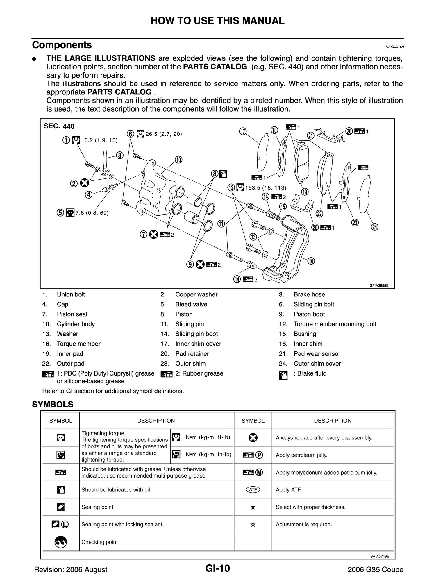

Look at the bottom left of the picture, there’s a key. Black wrench, in. Lbs., white wrench, ft. Lbs.

There's a table in the front of the general information chapter of the FSM.
FSM Symbols
FSM Symbols

Old May 8, 2025 | 10:56 AM
G2B35AGN's Avatar
Joined: Mar 2013
Posts: 2,004
Likes: 390
From: Raleigh, NC
Danger Danger! That's actually backwards. See the FSM page I posted....
Wait Wait! I'm looking at the box, you're looking at the wrench. This is one of those figure ground, what do you see tricks, isn't it?
Hoser is correct!
Old May 8, 2025 | 03:37 PM
HoserG35's Avatar
Joined: Jul 2022
Posts: 205
Likes: 65
G35 6MT “Brembo Car”
Hoser is correct!
Haha!! You had me questioning life for a second there 😂.
