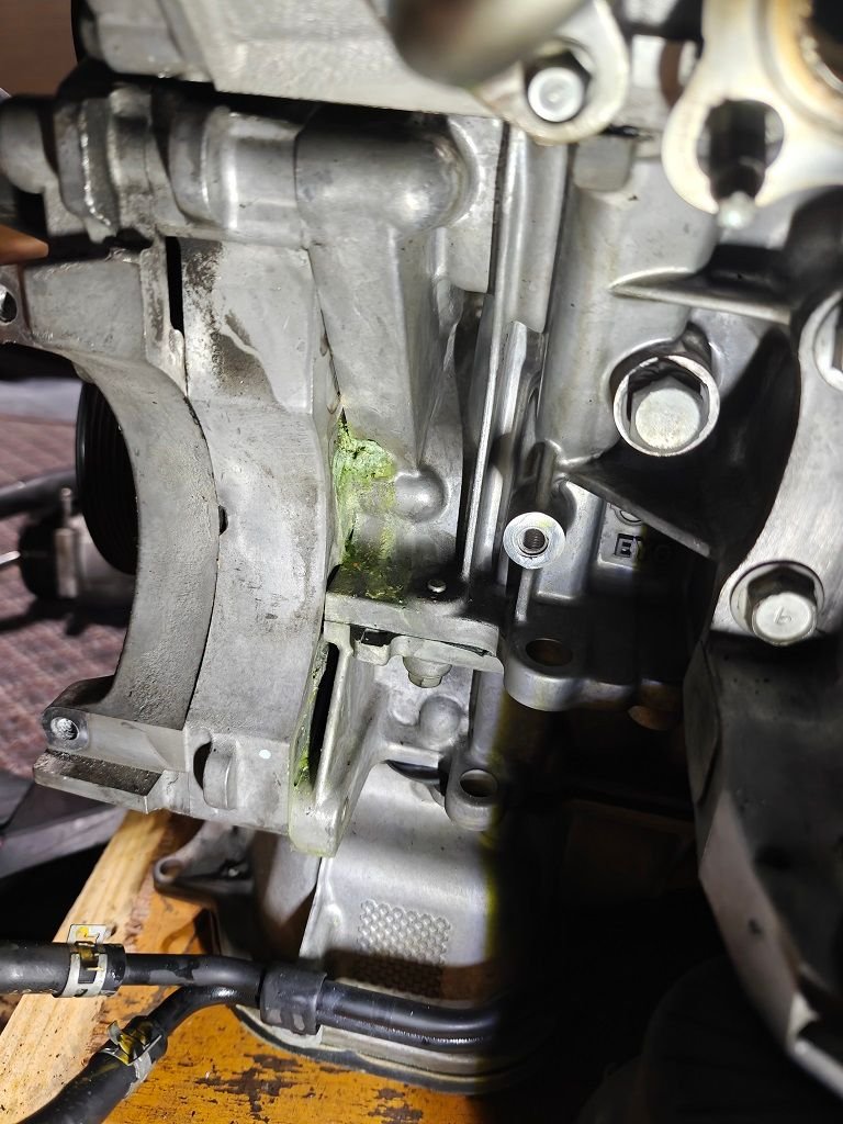

Started swapping the parts around (more on that later) and my ***** dropped when i saw this crusty coolant near the weep hole... I had instant flashbacks to when i did this job on the blown engine 30k miles ago. Wasn't terrible, but with all the time i've already put into this swap, i just couldn't see how i'd pull it off. This is my daily (but thankfully have a spare car), and the prospect of it being down another week or two extra was out of the question. I started looking around and checking stuff and noticed the RTV on the front cover appeared much newer than that of the rear (pics below) and the crank pullet bolt was definitely out at some point. I figured they must've replaced it at some point, or at least had the cover off for whatever reason.
RTV appearing much newer than the other stuff around it:
This def. didn't look like a factory RTV job:

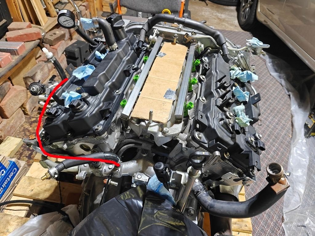

Even tho this engine is "warrantied" for 30 days, i had to find a way to pressure test it. The pictured setup below was then born lol I've used every which way to plug all the coolant outlets and fab up a pressure port for the compressor. Had to retighten and fix leaking unions, but in the end, it held pressure nicely. Definitely no air was coming out of the weep hole. I did some online reading and various car brands had new pumps weeping every so slightly (and sometimes more than slightly) when new. The way this was crusted over told me it was a very slow accumulation. After swapping a new A/C compressor on the blown engine last year, i started seeing some gooey green buildup on the bottom of it, but kinda brushed it off, as nothing ever made it to the floor. Pretty sure that was the OEM pump still weeping ever so slightly after I did the job back in 2022. I just could never see it on the crusty old compressor lol I checked that area now and it did appear a bit wet there. Interesting stuff.

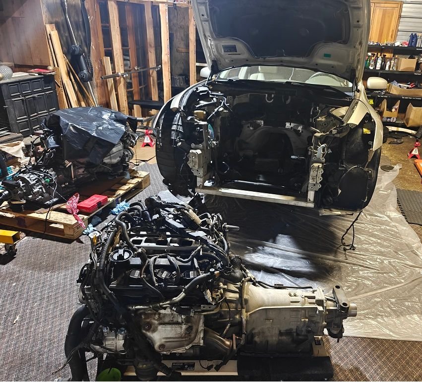

Here's how she's sitting as of tonight. The plan is to hopefully pop it in tomorrow afternoon and go from there. Still need to finish setting up alignment, but that's the job for after.

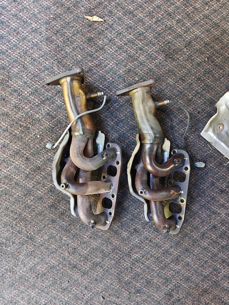

Now for some differences between the JDM and USDM versions.

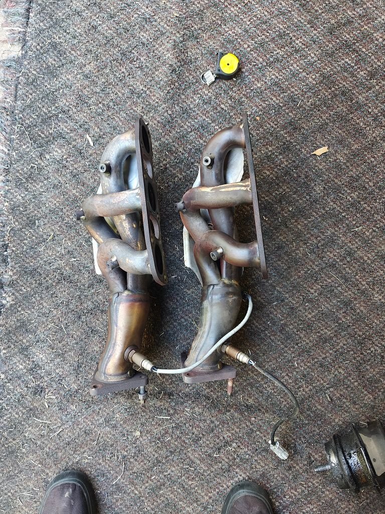

Exhaust manis appeared to be the same. I've measured out the driver side one and the JDM one was like an 1/8" longer, but that's so minute... Still, decided to keep the old manis and reuse the gaskets that came with the new engine. Oxygen sensor connectors are different, tho.
JDM on the left in both pictures:

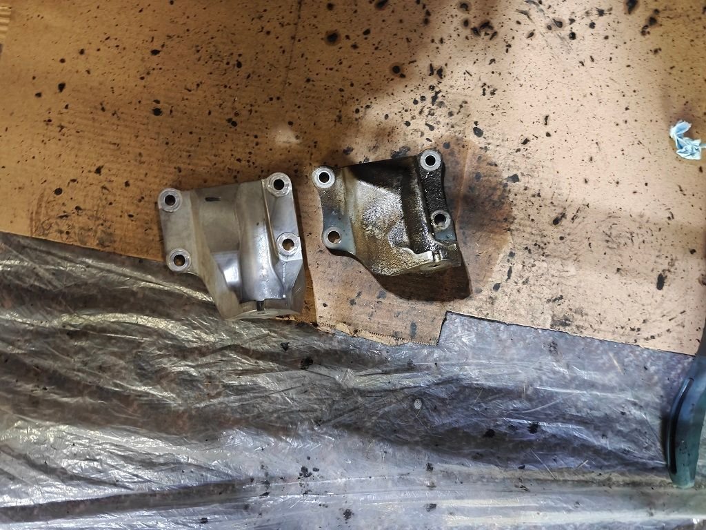

Mounts are different. Judging by the tranny code (3EX2B), this VQ is out of a Nissan Fuga, which, i guess, is an M equivalent here.

We got it back together Saturday. The engine-in part took under an hour or so and the rest of the misc stuff another 3-4. When trying to compression test it, i must've burnt up the starter as it wouldn't shut off when we were priming it. still, for whatever reason, decided to start it up and, of course, the starter just kept going... had to shut the fuel pump off to let 'er die out. swapped the old starter in (major PITA trying to fish it thru the opening) and she fired right up and ran great!

That coolant could be from previous water pump failure OR after someone opened the front of this engine.. Did you crack it open to check since you had it all in the open?
LOL stock airboxes with Z1 pipes (stock ones disintegrated), but this is still a true cold air intake vs some of the ones having the filters in the bay. not like it's worth shelling out $200 for 2hp (if that).
nope, didn't want to mess with the front cover. she's pulling strong. was going to get it aligned, but a coolant leak sprung up when i got to the place. ended up being the top hose clamp was worn out, so took care of that tonight.

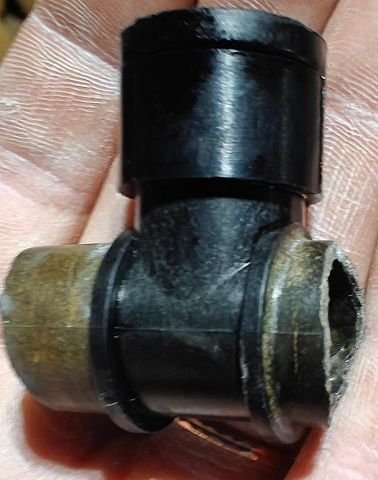

Got her aligned and a/c recharged earlier in the week. Then the plastic bleeder decided to take a dump on me. I've reused the one from the new engine, as it looked much, much better than mine (was seeping some coolant already), but looks like the plastic was no good on this one either (it would crumble if pushed on). Got some aftermarket aluminum one from amazon. The other side already had a metal union installed when we were putting it back together. Never use plastic in your coolant system... Also replaced the upper and lower radiator hoses.

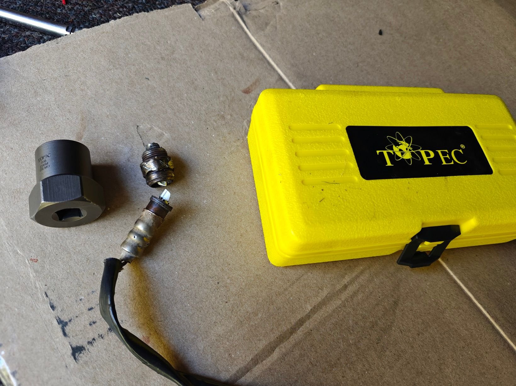

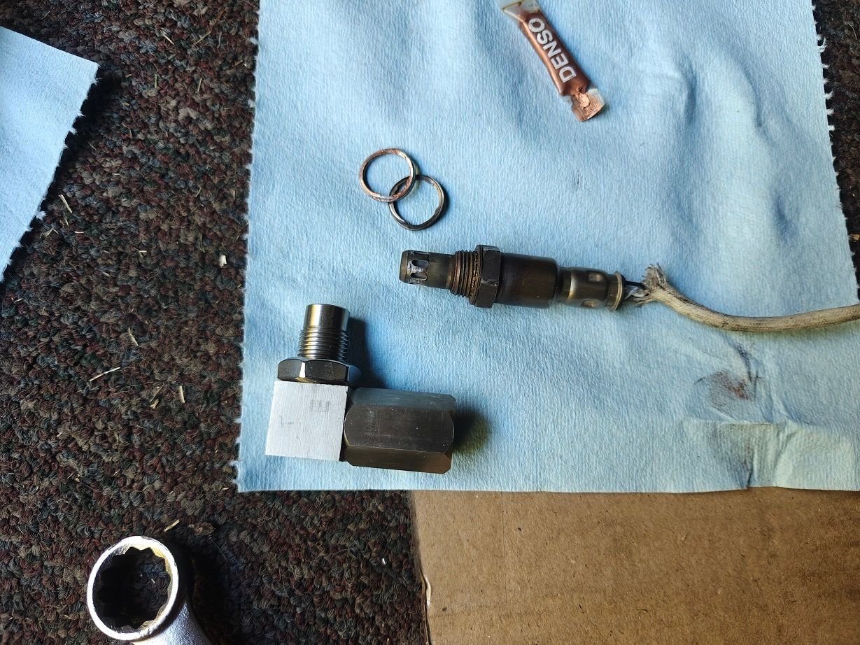

Bank 1 non-fouler wasn't long enough, so had to get a 90 from walmart (out of places lol). apparently, epa or whoever is cracking down on these things and they're nearly impossible to get here in the states. china, of course, doesn't have that issue lol Pretty nice piece for only $10 and a free 2-day delivery. Seems to be working better (it's not oscillating at hot idle anymore).

Well, 18 and 19 year old are still kids and i'm glad i got rid of it.. Now, i can feed my powerful black cat and never worry about 'trying to break traction"..
Wouldn't be easier for you to just contact Seymore in CA and have him disable 2 downstream O2 sensors? I never had good luck with those extensions, the car ran without CEL but fuel economy was horrible and power wasn't consistent.. I tried that in my 02 Maxima, 05 Minivan, 07 G..
do you know how much they charge? i'm sure it's in the hundreds vs paying $20 for these lol
