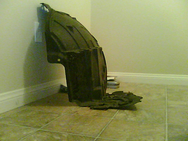

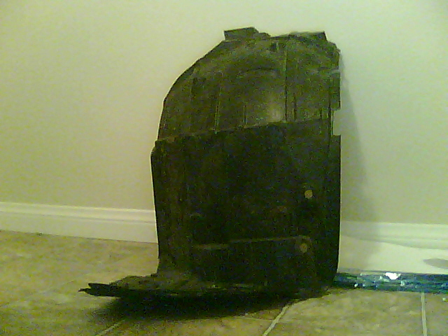

the plastic part covering the front left side wheel fell off, any one know how i can fix it?
Attached Thumbnails Unordinary problem-snapshot_20090212.jpg   Unordinary problem-snapshot_20090212_1.jpg

you need to go to the dealer and buy the little plastic clips that hold it in assuming you havent torn the holes. They are pretty expensive for stupid little clips that prob only cost like 4 cents to make.

aw shucks :[. there pretty torn.. Thanks :]

get washers and put them over the holes

but how will i get the washers to stay? its ripped plastic

You put the plastic where it goes, then put a washer then put in the clips, the washer will sandwich the plastic to the car where the holes are. Unless of course the holes are too big for a washer to cover.

i seee, i forgot to mention i lost all the clips :[ well i guess ill visit the stealerships

I found a lower engine cover on eBay for $50, give it a shot. The best temp solution I can think of is to wrap each hole on both sides with duct tape and form a new hole with a razor knife. That should make it strong enough to make the plastic plugs hold it on till you can find a good one.

zip tie !

thanks guys ive given up trying to do this myself, just gonna pay the dealers
