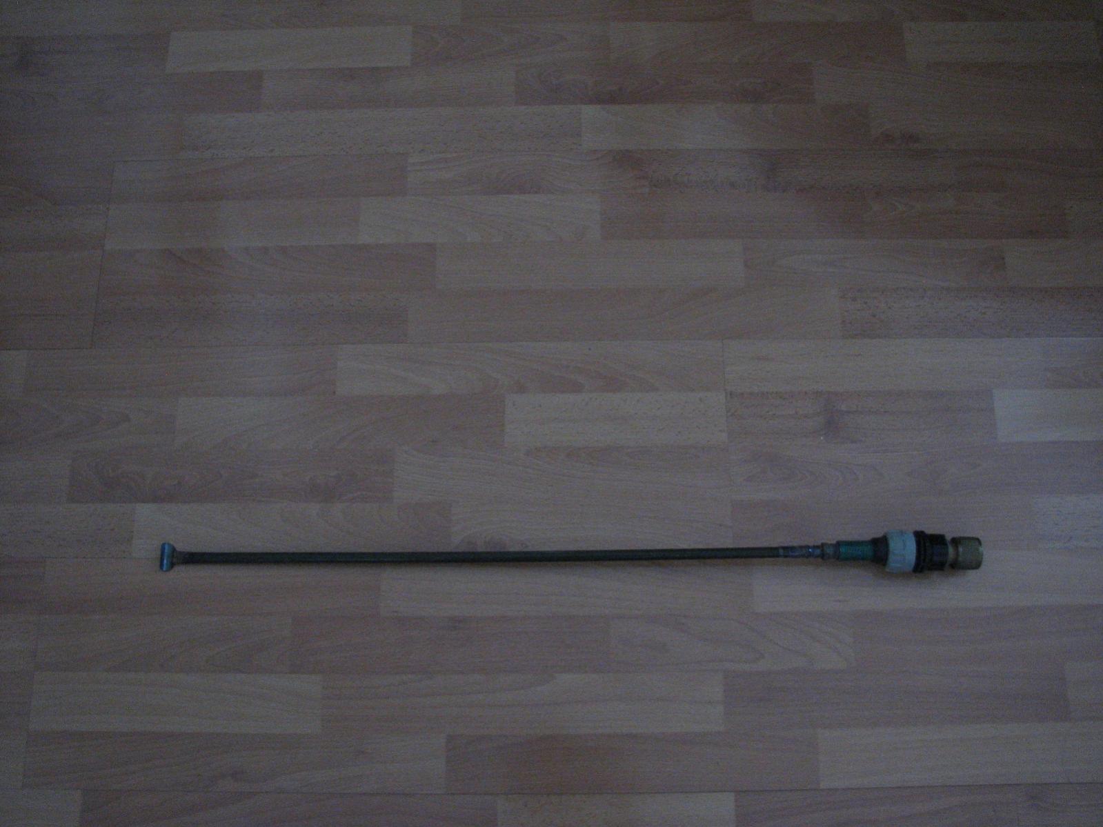

Gord,
Do you have any pics of the wand that you made up to do your flush?
Also, did you spray the condenser cleaner directly over the rads surface? ( that's what I understand from what you said)

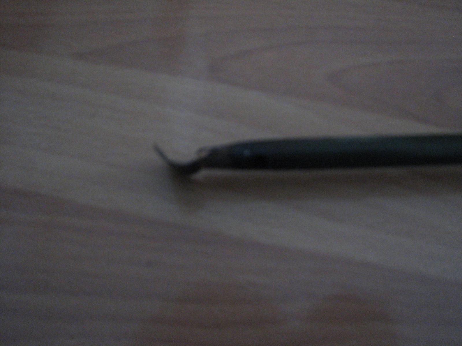

Wand Pics
Originally Posted by 35bills
Gord,
I'm having similar issues with my sedan with all the extreme temps we have been getting in Toronto.
Thanks,
Bill
I just took these (sorry for the dim photos). I just used what I had on hand to make the wand, but it worked great!
Yes, I sprayed the condensor cleaner directly on the surface of the rad and on the surface of the AC condensor, let it soak for a few minutes, and sprayed from behind the rad and then the condensor.
The cleaner got the fins nice and clean!
You'll need to remove the fan shroud and separate the AC condensor from the rad as well as you can to spray between each. Even better, take the rad out completely to do it separate from the condensor.
The first time I did this, I didn't have my spray wand nor the condensor cleaner, but even though I just carefully sprayed with a garden hose and an old car wand (fan spray pattern), an amazing amount of gunk came out of the rad fins. Made all the difference in the world and my temps immediately dropped. Glad I did this before I ordered a fan clutch as I was initially planning to do as well as replace the thermostat and possibly the rad cap.
Attached Thumbnails A/C and Overheating Help Please-img_0161.jpg   A/C and Overheating Help Please-img_0162.jpg   A/C and Overheating Help Please-img_0163.jpg
