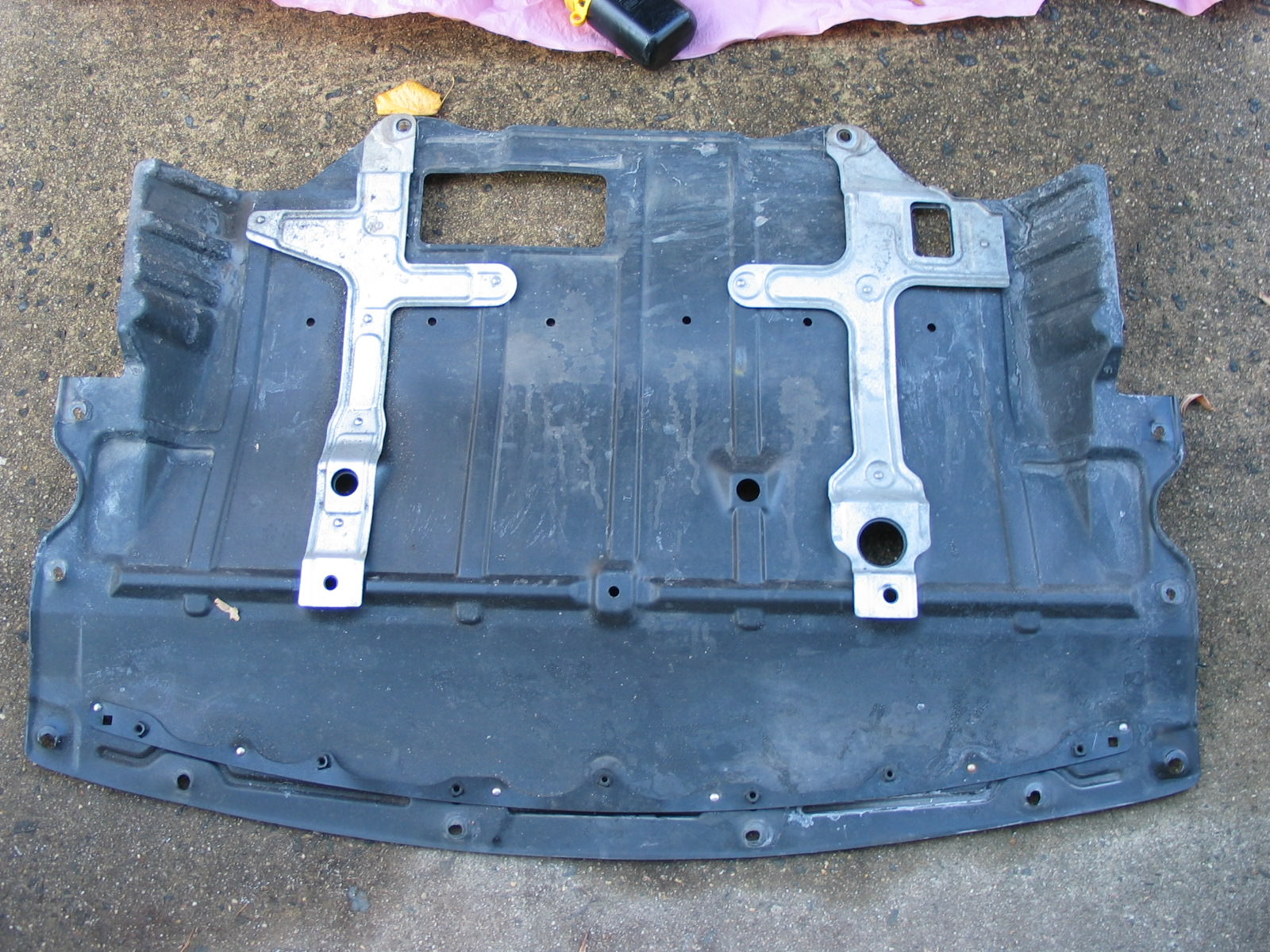

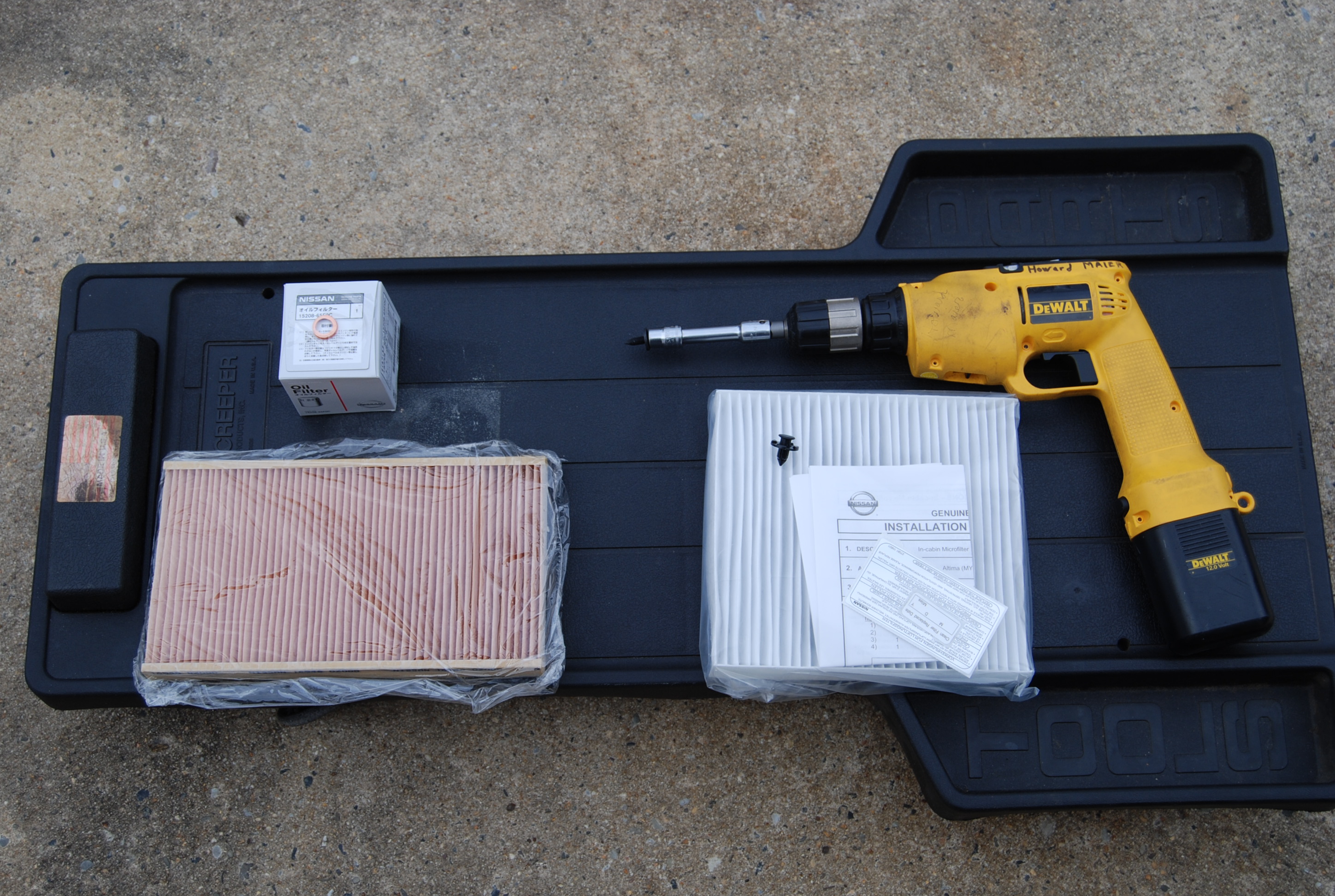

You are making a big deal out of nothing. Use a cordless drill with a 10mm socket. It only takes three minutes to remove that fiberboard shroud.
