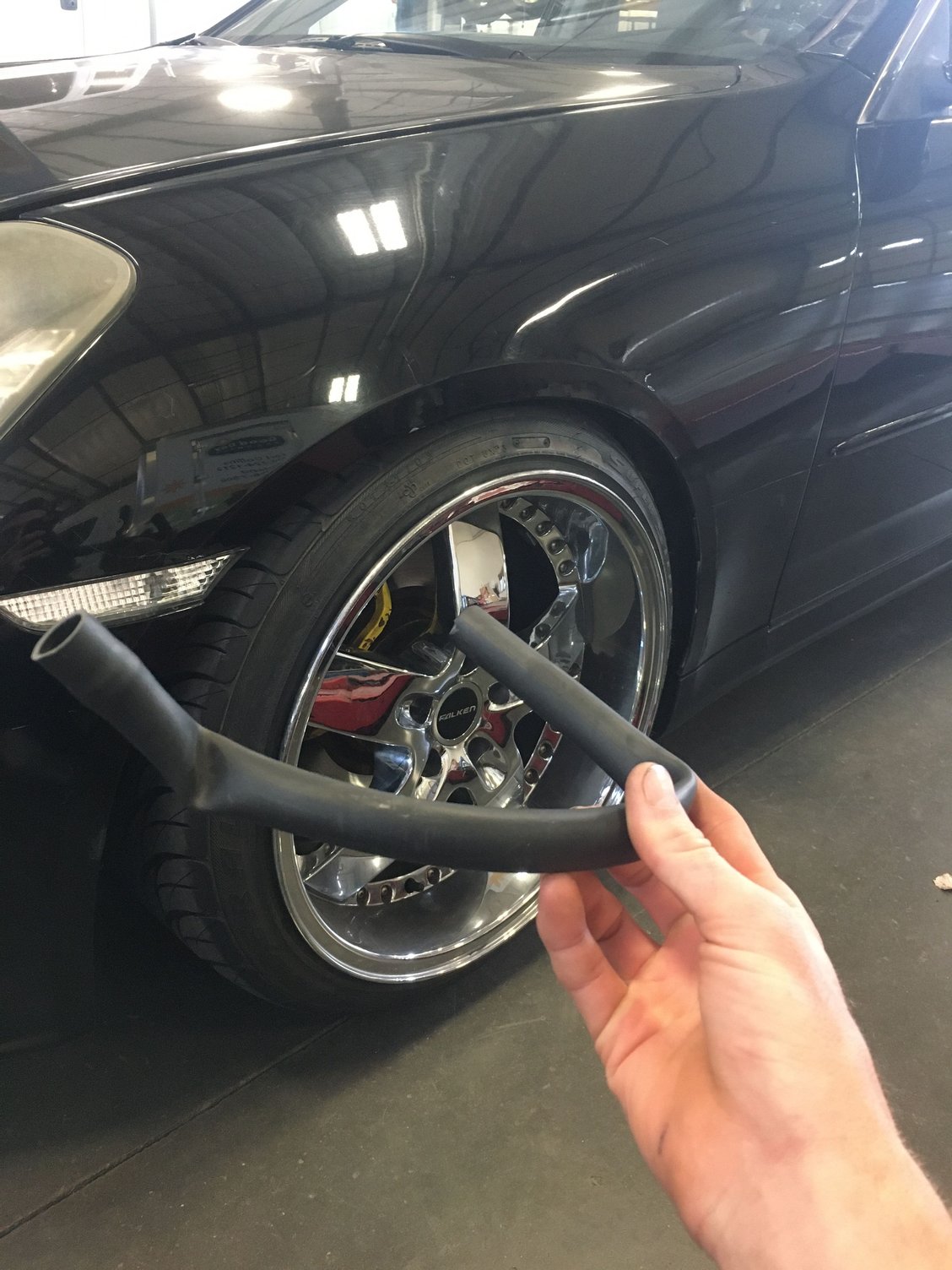

Welp here’s the culprit! The noise started happening right after I put cheap intake on 🙄 this is the hose from the back of the valve cover yo I take on the drivers side. Who knows why I never checked that before 😂 She’s much quieter now that I replaced that junk with a decent thickness heater hose that won’t colapse. Thanks for all your input guys!

Yep! I like to use fuel injection hose (not just regular fuel line it's rated at a much higher psi for injection systems) because it's gas/oil resistant and won't collapse. Glad you finally found the problem.
