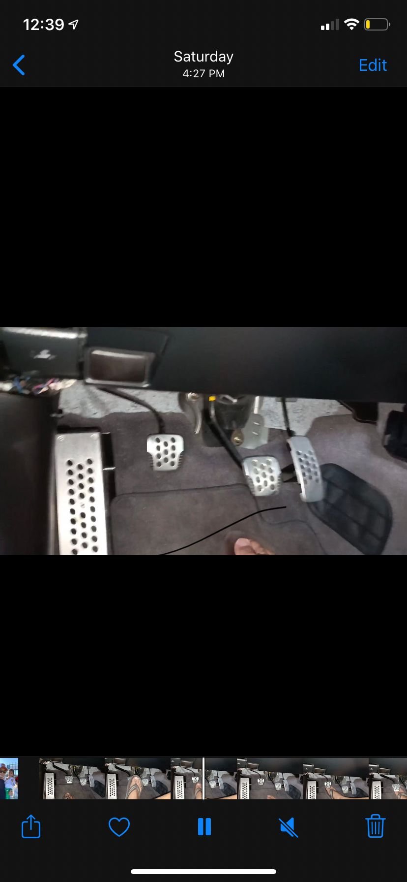

My clutch pedal does not spring back up. It gets stuck down when pushed and I Had to manually pull the pedal back. Transmission won’t engage. Any advise is greatly appreciated. Thanks.

Clutch Slave Cylinder

It's the clutch master cylinder, common issue with the G35/350Z. The best route is to rebuild both the CMC and CSC, when I put in a new transmission last year I bought the OEM rebuild kits and it was under $50 for both. Use Motul 600 fluid and I STRONGLY recommend buying a good stainless steel braided flex line, and some heat wrap because a section of the line is very close to the headers and it's a weak spot in the system.
Total price tag for everything was under $100.
