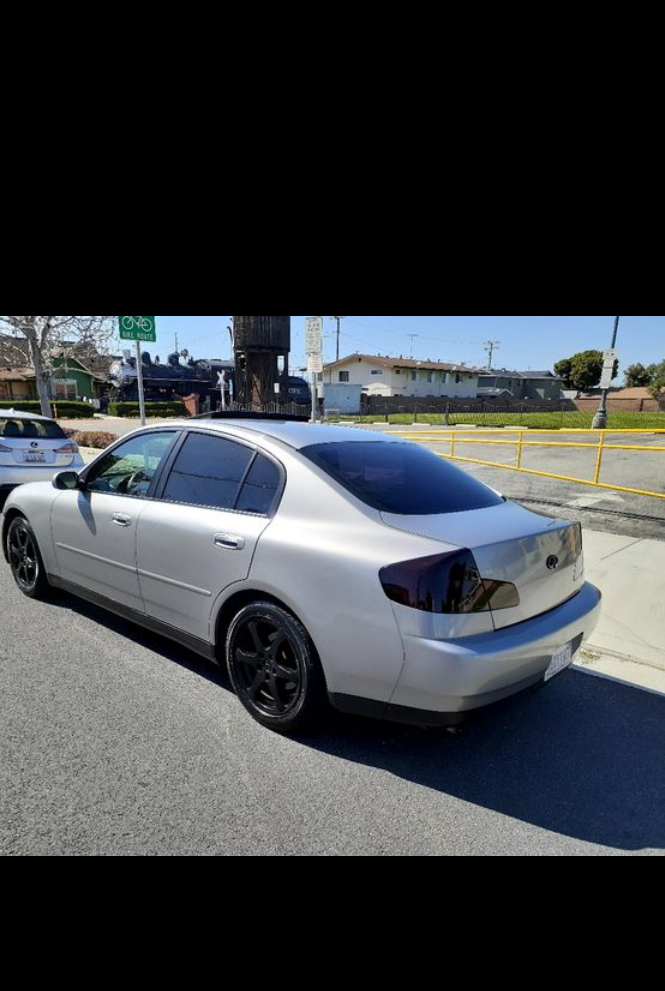

Hello All..I came here because I'm overwhelmed,sad and don't know what else to do.
I promised my 17 that I would buy him a car for his grad gift.Instead, he took the initiative and got a job because I have become ill. I decided to match his 2,000 by selling things on offer up.(sorry for the story but it is relevant I promise)
So we found a 2003 Infinity G35 Sedan.We paid $3600.00
We were told that the car only needed an Oil change,a battery and spark plugs.That was on 4/14/20
Since then,,Changed Oil,Spark plugs,Battery.. Immediately after,the car began to stall and turn off while driving.Especially while turning corners.It smells as well
got a diagnostic with code P0345.
To be safe I changed Bank 1&2 Camshaft Sensors as well as crankshaft sensor. The only results were that it doesn't have a rough start and it doesn't stall anymore and VDC,BRAKE,SLIP lights turned off..So I got another scan and it said Coil pack Sensor.So I replaced all 6..It didn't help,it hot worse. but the Check Engine went from solid to blinking
This is the car I bought
..Now it makes a misfire popping noise over and over,car shakes,it drags,not very much power,and after 10 minutes steam comes from the carpet INSIDE THE CAR! The dash hot/cold meter stays the same,not elevated at all.

First things first, tell your son that some times **** happens and that everything is going to be fine. Nothing about owning a car is easy, In my entire lifetime of owning 30+ vehicles I have NEVER had a vehicle that just ran perfectly all the time, parts wear out, especially when you're getting near the 200k mile mark. Parts break, maintenance requires a lot of WORK, but if you really want it and are willing to work for it even an older vehicle can be brought back to life and run like a champ.
As for the vehicle itself, your CEL started blinking, typically that only happens under powertrain critical failure that can DAMAGE the engine, things like overheating, since it blew steam I'm guessing it was overheating regardless of what the needle on the dash says.
Here is a link to the factory service manual, the actual Nissan/Infiniti textbook that the dealership uses to work on these things, I recommend you go to each section for your vehicle and download a copy of it onto your pc or phone. Store it all in a separate folder and you will be able to click on sections and they will automatically load.
https://www.nicoclub.com/infiniti-service-manuals
Everything starts at the FWD - Forward document, it's basically the table of contents. Some years also have IDX - Index which can be handy for looking up keywords.
First I would get a cheap OBD2 scanner if you don't already have one, you need to rescan the car to find out what codes are in it right now.
The previous code P0345 is for the EVAP solenoid, fairly easy to replace but since you have a 2003 you need to verify which solenoid style you have, read the notes on Z1 Motorsports page about them and it will help you determine which one you need.
https://www.z1motorsports.com/intake...435vudv81hcdj5
Keep those existing cam and crank sensors if you didn't replace them with Hitachi or Genuine Nissan Parts OEM sensors (Hitachi was the OEM manufacturer). These cars don't play nice with aftermarket sensors and you might need to put the old ones back in if you didn't use the Hitachi / OEM ones.
The most important thing to repair right now is the coolant leak, you need to first FIND the leak so rent a pressure tester from an auto parts store and figure out what blew. It's probably the heater core bleed valve on the right side in the engine bay, it's made of plastic and is a notorious failure point, when they rupture it dumps all the coolant right onto the header and creates a ton of steam. If it's broken badly enough it might just be in two pieces and will be easy to see, just outside the battery box between the battery and the engine.
Z1 makes a metal replacement one that's more durable than the OEM plastic, here is what the OEM looks like.
https://conceptzperformance.com/niss...00_p_15693.php
Here is the Z1 metal replacement one.
https://www.z1motorsports.com/z1-pro...e-p-11190.html
Once you have the leak repaired you will need to bleed the air from the coolant system, the most important thing is to add the coolant VERY SLOWLY to the radiator (rate of about 1 gallon per minute) until it comes out the coolant purge valve, then screw the valve shut, then continue adding coolant VERY SLOWLY until the radiator is full. Then you start the burping procedure, lots of people take the easy route and use a Lisle funnel, you can google search a lot of ways to burp the coolant system. If it's still tossing codes get those fixed before burping.
For the future when you get a code try to isolate JUST THAT PROBLEM and not just throw parts at the car hoping something will fix it. For example, the first code you got for the EVAP solenoid you instead replaced both cam and crank sensor but didn't replace the EVAP solenoid. Basically it's just wasting money and you always have a chance that the replacement parts might be defective so you can end up spending a lot of time chasing down other problems without actually fixing anything.
Same thing with the coil packs, the code was for a SPECIFIC coil pack, not all 6. It probably just needed one of them replaced but extra money was spent on 5 other coil packs which are component that typically last a VERY long time and will often outlast the motor.
Using the FSM will help, you can look up specific engine codes at the front of document EC - Engine Controls and go to the specific section on that code to read more about it and a list of items to TROUBLESHOOT. With the exception of a couple sensors like the hall-effect cam/crank sensors that require an oscilloscope to actually troubleshoot there is basically nothing else on the vehicle that can't be properly troubleshooted.
Keep adding your questions to this thread and we'll keep answering them, this forums isn't as active as it once was but there's still a LOT of knowledgeable and helpful folks that will donate time answering questions to help you get this car back up.
Welcome to the forums, make your son help you with all these repairs, get his hands dirty, that's part of owning a car unless you want to shell out $125/hr to pay a shop to do work.
