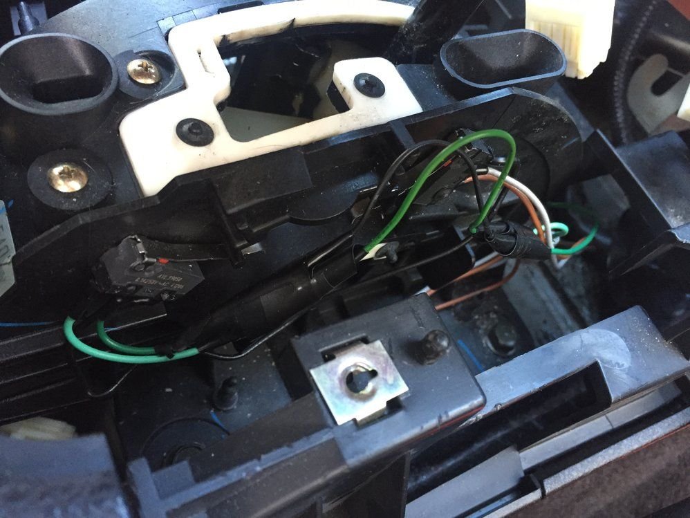

Hmm....I noticed you previously said your car will downshift on its own in MM mode. sounds like your issue can possibly be the shifter microswitches themselves.
Here is a pic of the switches in my car. I would advise u to open yours up and inspect them. Make sure they arent faulty or out of adjustment. U can even go for a drive with the switches exposed so you can manually click them just for testing purposes. If you wanna be 100% sure you don’t have a bad switch you can even unplug(if possible) the switches or even cut the wires to them. U can always resolder the wires after u are done troubleshooting.
I believe I tried shifting with the wires exposed and I could hear the switch for up shifting click yet nothing happened. Does this mean i need to replace the assembly?
If u can hear the switch clicking then its probably good. Im kinda **** about that kinda stuff and wont be satisfied until Ive tested the switch with a multimeter. I like to be 100% sure before I move on.
If the switches are good, then that means the assembly is good. U probably have an issue with the transmission ECU or whatever ECU controls the MM functions.

while you're in there messing with the switches, it's a simple matter to swap the wires to reverse the mm shift pattern to pull for upshift, push to downshift. so much more intuitive than push to upshift. i did it so long ago i can't remember exactly how i did it but there's a diy on this site about the easiest way to either cut or unplug the wires to execute the swap. if you've gone to enough trouble to get the thing open that far and fool with the switches and wires, might as well finish it off with a nice mod.
Check out my pic I posted. Its one of the first mods I did when I got the car haha.
