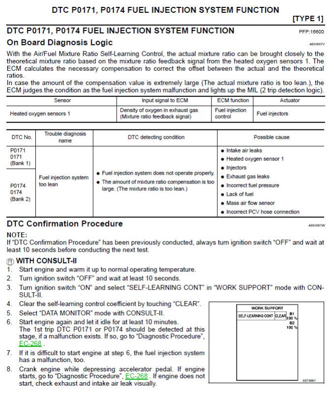

i think my light came on because of the fujita intake. since its not carb legal and stuff. and the code said too lean which means too much air not enough fuel... i dunno.

yes the light went out.. iono why prolly cuz of sucky gas or since i cleaned out the maf sensor. knock on wood it doesnt come back!

The manual says, the first thing to do is clear the self-learning in the ECU. The car probably just has to re-learn to operate with the new intake. After clearing the ECU, it should take 10 minutes to learn. As long as nothing else was changed or damaged around the same time, you should be OK. Look at the possible causes on this page...
