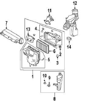

In my haste to test these mods, I did not remove that plastic bottle located under the stock air box. It is bolted to the chassis with two 10mm bolts.
Refer to #8 in the G35 intake system diagram below.
For more detail check out the AEM Cold Air Intake instruction pdf.

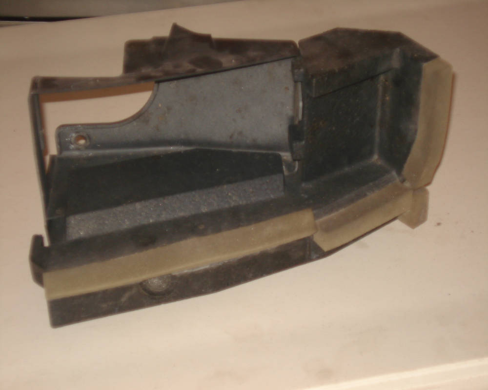

There are two parts. Separate the two parts.

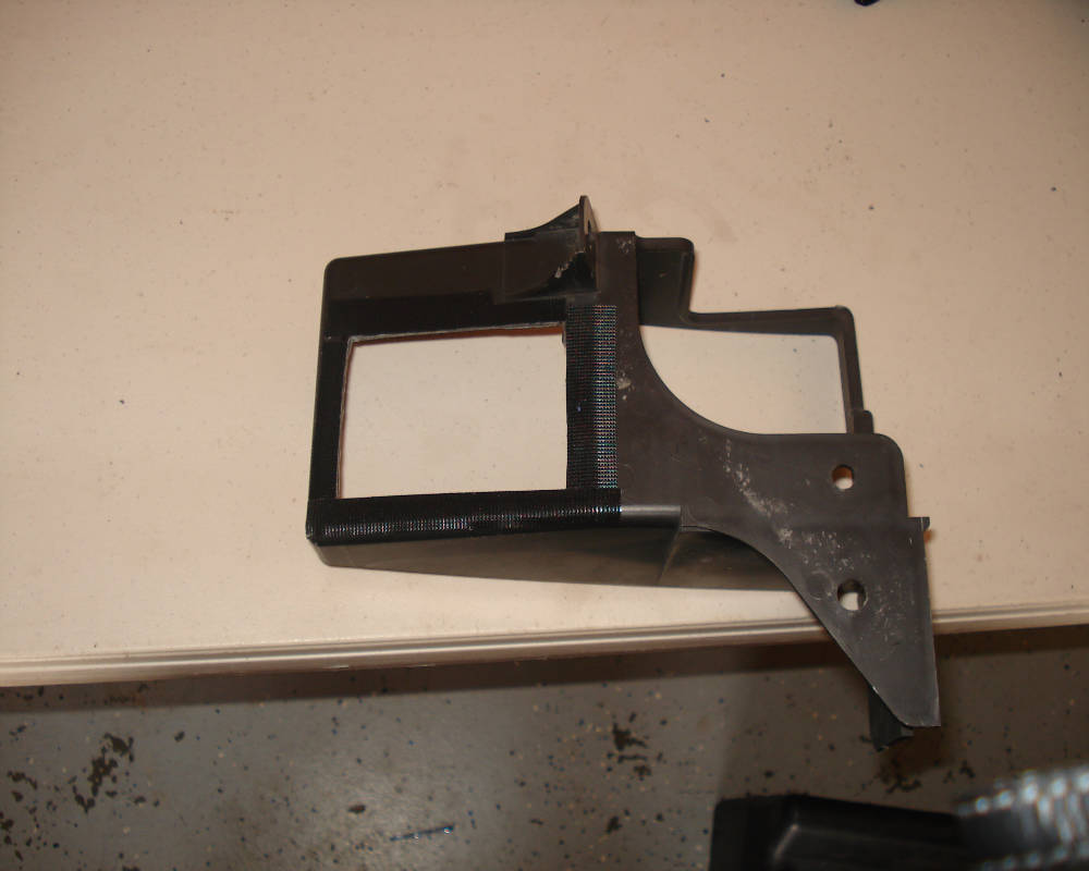

The plastic bumper piece will be modified.<O</O
Use a rotary tool to cut out a rectangle about 3”x 4” from this piece.<O</O
Apply Velcro to the back of this part. Save that 3”x 4” rectangle you cut out and apply Velcro to it. If need be, you can stick it back on.

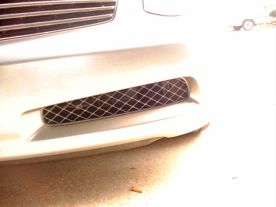

You can see the opening behind the bumper grill.

Now, I'm a little confused here. Is that before and after cut/modification on second and third pictures?

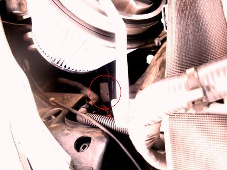

The second pic is the foam and plastic pieces that fit together. The third pic is one of the bumper opening taken from under the hood. The fourth pic is one of the plastic piece after a rectangle has been cut out.
