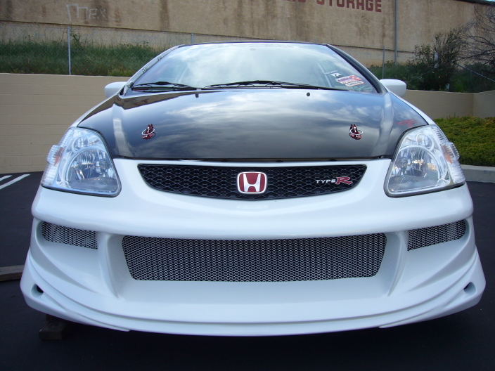

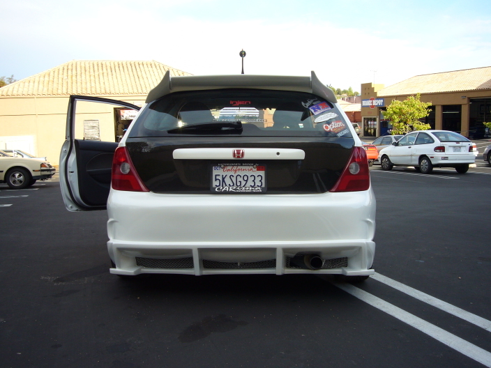

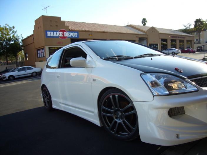

Here are some pictures of the Type R that I destroyed.... was surprised by a flooded road and turned my car into a submarine
but it worked out because I bought a G and my car life has changed for the better!!!

anyone a honda fan...
if so, what do you think of the pics i posted... its an eX HIN best in class winner

except for all the unpainted Carbon fiber, I like it.
