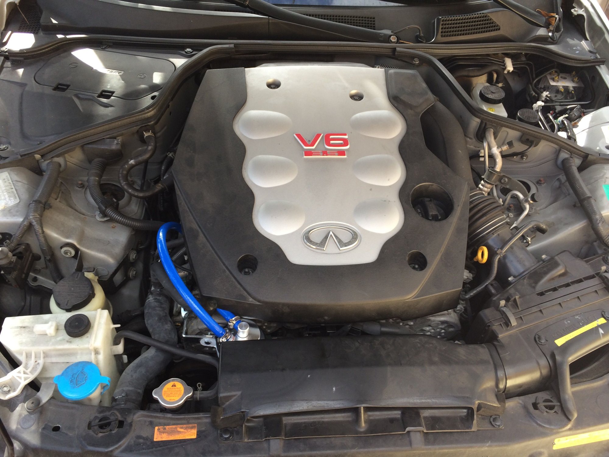

took a different approach with the bracket. no mod necessary lol.
just wish it came with those fancy fittings you got.

so ive been reading more on these and other forums about catch cans, and one thing that is pretty important that I overlooked was the strength of the vacuum hoses.
the ones supplied by simota collapsed under vacuum (specially the one leading to the plenum). I drove around with it like that for a couple of weeks or so until I came across a thread that their hoses were collapsing.
check your hoses people!
