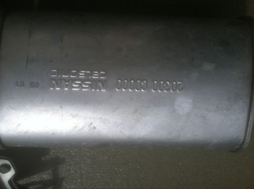

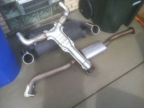

Sup Fellas,
I managed to buy an OEM HR Y PIPE, the Mid Pipe, and the Coupe Muffler from a guy with a 06 G35 Coupe.
I attached some pics. I know the Mid-Pipe is a Direct Fit on my sedan, but am really unsure about the Coupe Y Pipe. Will I encounter some difficulty with the install?
Some issues that were unclear to me were if I can use the coupe Muffler, or just reuse my stock muffler.
Need some advise.
Tks,

Hey PJ,
The only thing you'll use is the mid pipe. The Y pipe is the same as yours and the muffler won't fit w/o serious modifications to your trunk.
Slap on that middy and enjoy.

don't think that's an hr-y pipe you have there lol go back and get a partial refund

def NOT an HR y-pipe and the muffler is also worthless to you

Bummer. I tried calling the guy back, but dude won't answer my phone calls. I got my neighbor to bolt the Mid Pipe without any major issues. I am stuck with this Coupe Y pipe and muffler.
I need suggestions on a specific Y Pipe or HR y pipe to cop.
Some help on what I should do with the muffler part will be deeply appreciated.

the 350z HR y-pipe is the only one worth a d@mn

The HR Y pipe has longer arms. That Y pipe is the same as the one that you already have.

Heres the difference between the DE (stock) and the HR (stock)

Just like everyone stated the Mid pipe was the only thing worth it. I can only recall one sedan with a coupe muffler but he cut into the spare tire well as he has an enormous whole in his trunk, NOT worth it nor looks good.
If this dude flakes on your just put the other two up for sale. I just hope you didn't get ripped off cause they aren't worth much.
