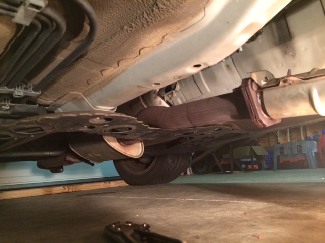

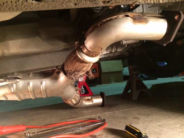

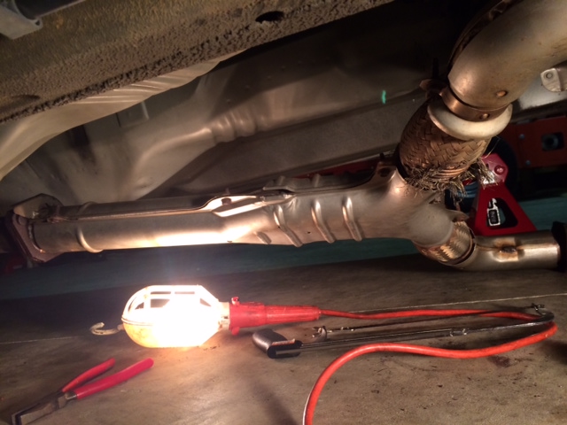

Here's my situation...I'm installing ART pipes and a catback exhaust on my G at the moment. I've got the entire exhaust off the car...one problem....the 2 nuts connecting the y-pipe and mid pipe are rounded.
Does anyone know the name of the bracket preventing me from dropping the entire exhaust? What is it's purpose? Can it be removed?
Hacksaw isn't working so I'm all out of ideas. Heading to Harbor Freight to buy a reciprocating saw now but hoping my forum pals can help me out.
Any suggestions???

Its a rear subframe brace and yes it can be removed..
Thanks for the reply Frankie. How tough is it to remove and should it be removed?

That im not sure, id soak the bolts so u dont fukk them up.. U shouldnt have to remove it to take the exhaust off or on though..

It's officially called a "tunnel stay." Yes it can be removed, just put it back when you're done.
I'd just saw the stock exhaust since you're replacing it anyway.

I'm not getting anywhere with this saw. The car is only a foot off the ground and the angles are impossible. Have you removed this tunnel stay before? It looks like this may be my only option

UPDATE***
Tunnel stay is off. Took 10 minutes max. Wish I would have figured that out before I did all those unspeakable things to my oem ypipe. More to come...
