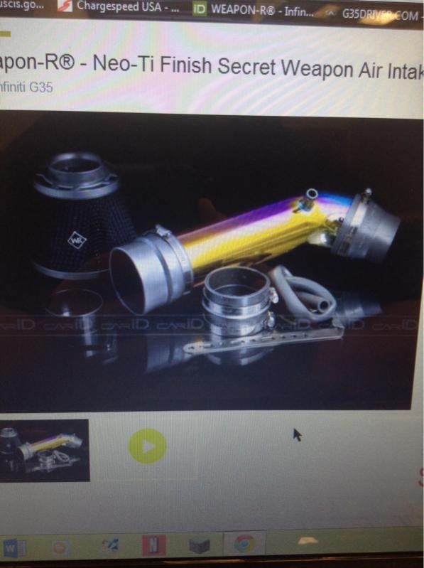

Hey guys I really want to get an intake and I've been leaning on the (Weapon-R Neo-Ti finish secret weapon air intake system) can I get any advice on that or any suggestions on what I should get?

It looks like its aluminum. I would stay away from it. Aluminum suffers from heat soak. I would get a 350z oem z-tube or stillen. You dont want aluminum.oem $109 stillen $64

Best sound comes from the aftermarket Short Ram Intake without issue of hydrolock. Look at the R2C intake, that is a dry filter that has a wonderful sound.
I have never seen anyone run that Intake but it looks mean! I've yet to see a neochrome intake, but like above posts say it would increase your intake temp more then a few degrees. I think you should get it and report in on the sound, feel, and longevity of it...!

So you're saying.. To be the guinea pig lol I think I might go for it

Looks like they are out of stock, but that is quite expensive for a neo-chrome painted intake. Plus they make some ridiculous claims of increasing mass air flow by 3 times... YEAH RIGHT. Reason I say this is because choke is still the same size at the throttle body.

Its cheaper on Carid and they supposedly they have some and I didn't think so either.

I second what seymore4 said. If you get the aluminum z-tube you will need to use the connecters from your g tube. They say when you stop the aluminum tube will heat up! Heated air robs performance!

I was the guinea pig and got it anyways lol
Looks great and sounds great
Here's a pic!
