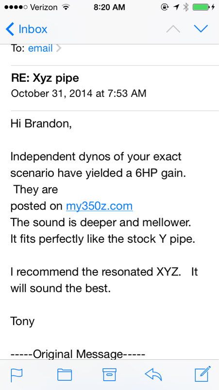

Yeah I'm in Cali so can't do HFCs:/
u be the judge -
And I bought the car the way it is so I'm not sure on price.

Sounds good for just a quick res delete. I think the XYZ would sound good with your current set up. I did not realize the gains were 6HP. I can for sure feel it though.
