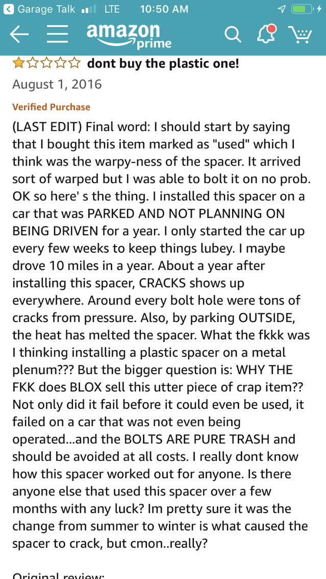

I haven't had any problems with my plastic Blox spacer and I daily my G in Maine winters. Just make sure you're careful with installation torque values, if you just tighten it as much as it can go you risk cracking the plastic spacer hence the negative reviews on amazon.
IMO heat sink issues with spacers are either minuscule or invented by tuning companies to sell their overpriced "engineered" spacers. If it raises the intake plenum by 5/16 inch and seals perfectly it's doing its job, you could make a spacer with a CNC router and a 5/16 thick wood board.

There's no doubt a plastic part is less durable than a metal one, if you over torque the screws it will crack around the bolt holes, and the guy in that review should have thought twice before installing a warped spacer that sounds like it was exposed to a nuclear meltdown in a past life. I
All I can say is my plastic spacer has held up fine for years and years on my NA car despite being aggressively driven daily in conditions ranging from -10 F to 100 F.
It's your money to spend, if the extra $250 for peace of mind is worth it to you then go for it.

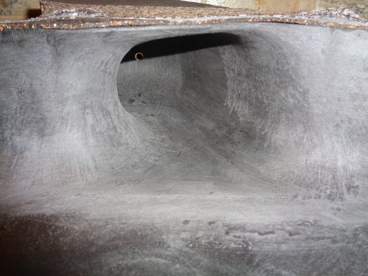

Yes, for sure BUT you can greatly and easily enlarge the neck on the V plenum to match a 3" throttle body. Can't do that with the stock plenum, at least not easily. The Kinetix is the more fragile choice though, so if you're a brute, stay away. (It's been opened up even more since this photo. Had to take it off to replace cam sensors.)
Then you can enlarge the area from the neck and into the plenum, removing more of the pressure drop caused by the radical bend in the neck, out of the equation.
