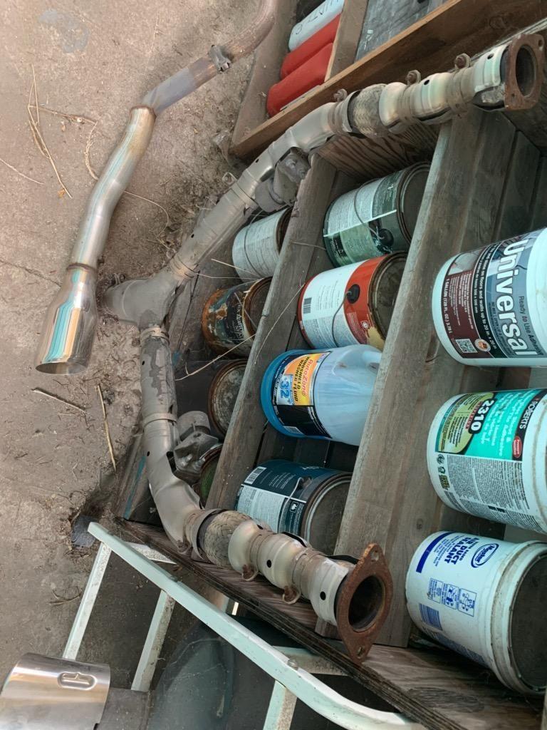

Does this look correct? https://offerup.com/item/detail/652418461/ I realize it's not a very good picture. I'd offer like $30 bucks. Also gonna try and find a coupe midpipe. In that case, should I try and get one that is the same year as my car? Or should it match the y-pipe?

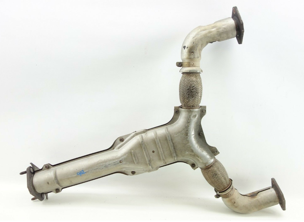

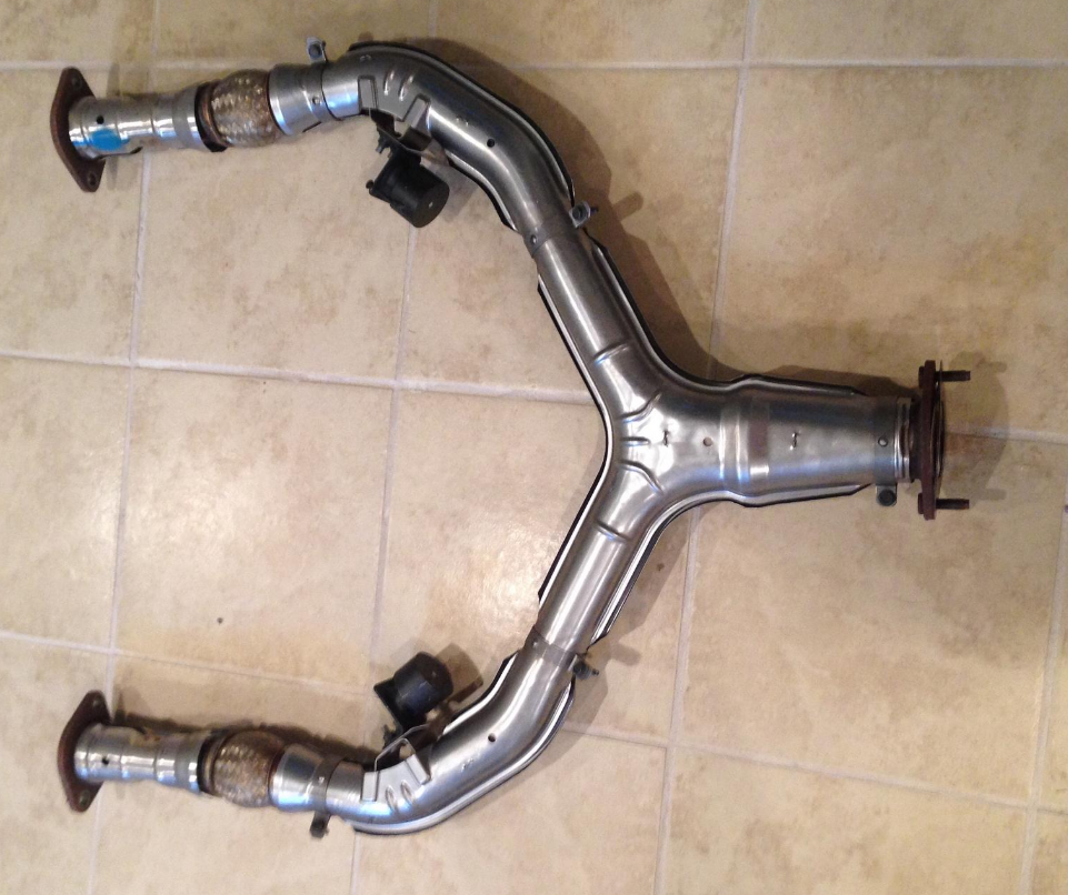

Yeah the coupe/sedan DE y pipe has a longer pipe once the two converge at the Y, the HR pipe has a very short single pipe past the Y.
Here's the stock DE Y-pipe
And here's the HR Y-pipe

Yes, it appears I am looking at the HR then. He wanted 50 I offered 30, we met in the middle at $40. He is local but I might make him bring it to me.
Since it is so much shorter after they converge, what does that mean for install? Will it not be compatible with my current (stock 2003 G35 Sedan 6MT) exhaust? Will I need to get an adapter or extension of some sort?
Also, for the coupe midpipe, you said it does include the resonator above. If I get a coupe resonator/midpipe will I need to make more adjustments? Or should I wait and do them both at the same time?

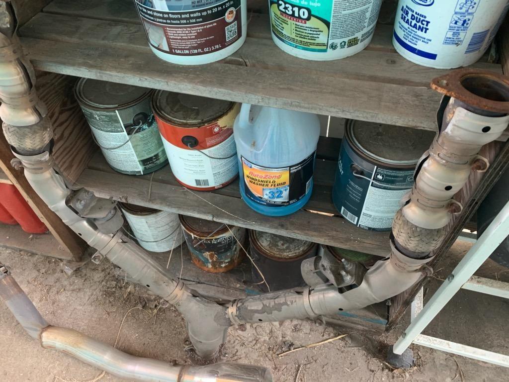

I decided against the DC I feel better staying as close to OEM parts as I can. This is a y pipe guy wants 40... it's local I thought he flaked out but I guess he was just busy. I wanted to see the pictures since he says there's no holes or cracks but the rust on the ends worries me a little. Could I just CLR them or steel wool or something? Or does it matter? What do you think would you do 40 for these?
Also, I won't be doing the work myself, I am hoping to pickup a coupe midpipe/resonator and then probably a new muffler/exhaust tips. I plan to have it all installed at once and with new gaskets and my mechanic said he will do it so probably cheaper than a muffler shop but I will shop it around. Also I will do the pb blaster I get what you're saying with that.
