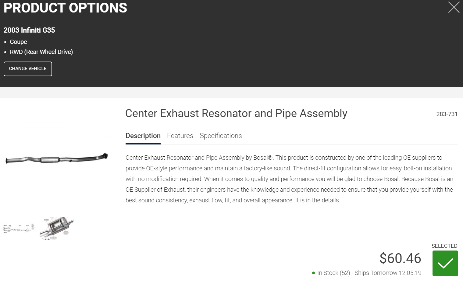

Soooo......if I want the coupe's midpipe (everyone says it sounds waaaaayyy better), should I go OEM or just fudge it and go aftermarket? I've seen coupe midpipes from Borsa or Walker for like $60-$40... I do want to stay as close to OEM as possible but still eek out a tiny performance or tone change/increase. What's your opinion?

That's a good deal on the Y pipe, I'd jump on it, plus it looks nice and clean.
Hold out until you can find a nice clean coupe mid-pipe, most of the aftermarket ones either have a very small resonator or none at all. The OEM coupe pipe has a fairly large resonator and it's proven to sound great on the sedan.
