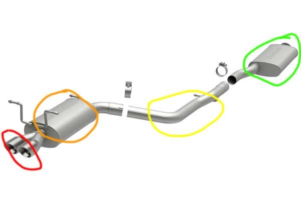

Here's what I think I know right now: I'd be replacing the red and orange parts; and the muffler has the inlet(?) on the right hand side, so I should probably choose a replacement muffler with the inlet in the same place.
Magnaflow cat back
G35 sedan exhaust diagram

1. No, catalytic converter is by FAR the most restrictive point in the entire system.
2. No, pipe diameter becomes an issue and the 2.25 in diameter stock pipe is fairly restrictive by nature, hence why dual exhaust setups make more power.
3. More of a rasp issue if swapping just the axle back, noise = rasp and a well tuned system is finding the balance between the two.
4. No, unless you somehow chose a more restrictive muffler, but the most congested part of the entire system is the catalytic converter so almost always, no.
5. No comment
6. No, a dual tip setup is typically used because it doesn't protrude any LOWER on the vehicle, entering and exiting parking lots will rub the tip on a large diameter single exit.
7. No, but you will need a muffler shop to do the installarion
8. Sure
9. Yes, but each time you replace components you have the risk of unwanted drone/rasp and will require more exhaust tuning to "fix" the issue.
Here's what I suggest, since you apparently want to make both MORE POWER and SOUND BETTER I think you should replace the OEM midpipe with the coupe mid-pipe, this adds a lot of good exhaust note to the sedan. Next replace the factory catalytic converters with HFC, this frees up the most restricted point of the entire exhaust system as well as adding more volume to the exhaust. You will be sourcing a used coupe midpipe which if you can find it locally should only be about $75 and is an easy bolt on you can do yourself, try to find a pick-n-pull wrecking yard to yank one from. The HFC you can also source used and will probably find for around $350 shipped, this is another easy to do mod, if you do have to pay a muffler shop to do these mods for you they will both be cheap since they are 100% bolt-on components that don't require any other work.
After you add the HFC if you do have a little drone (resonated HFC probably won't have this problem but are harder to find, see if you can find the Fast Intentions RHFC) then you can add a Vibrant resonator which will eliminate the problem.
This setup will give you a good clean exhaust note that will NOT be raspy and have no drone, it can be pieced together as you can afford it and has proven results in sound quality.

Thank you for such a quick response and so much information. I was unaware the cats were the most restrictive part. Unfortunately I live in California and we have stupid CARB... so I haven't wanted to mess with the cats at all because I need to pass emissions testing. I will look into high-flow catalytic converters, but I'm guessing they are out of my price range.
I do have the 5/16" plenum spacer and that was a fun and easy mod. I have a drop-in K&N filter as well. Didn't know about the rev-up air box... I'll look into it. But yeah, that's about the range I can afford to invest you know? I'm not looking to make this thing a nuclear rocket, just a little bit more power and sound. If the axle-back does nothing but looks and sound... I may put the whole thing off until/unless I have to replace other parts of the system due to corrosion/leaks. Mine's 16 years old at this point. Another thing I may do is to Frankenstein it, and basically do a cat-back system, a piece at a time, until the the cats fail and at that point I would replace them with high flow ones (I could more easily justify the expense at that point -- especially to the wife and cats!)
Perhaps a stupid question, but the coupe's midpipe... where is this/does this go in relation to the schematic I posted above? It is behind (closer to the rear of the car) the resonator?

Yeah the resonator is in the midpipe.
