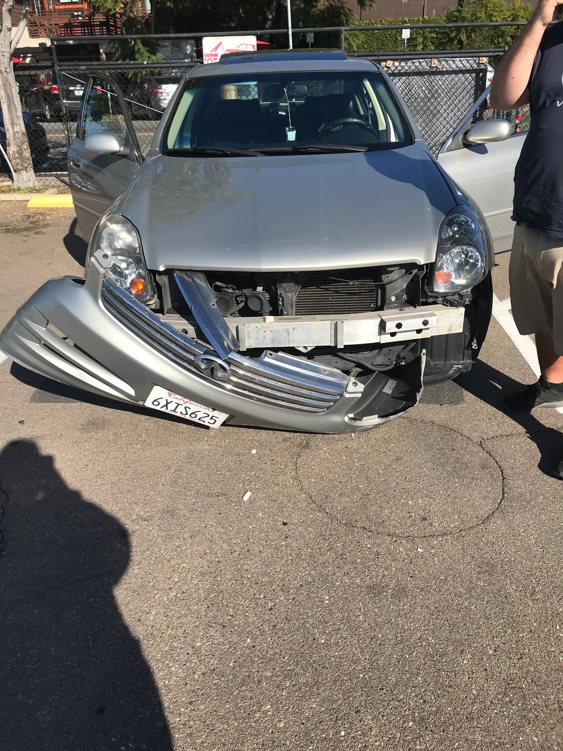

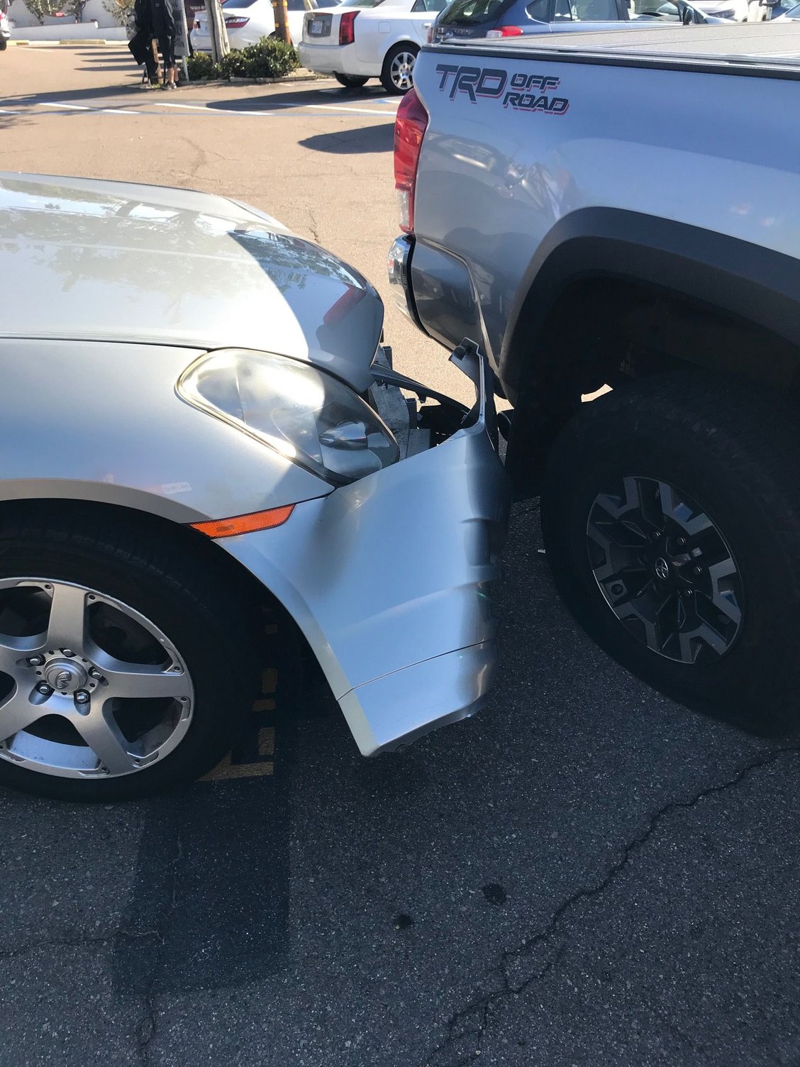

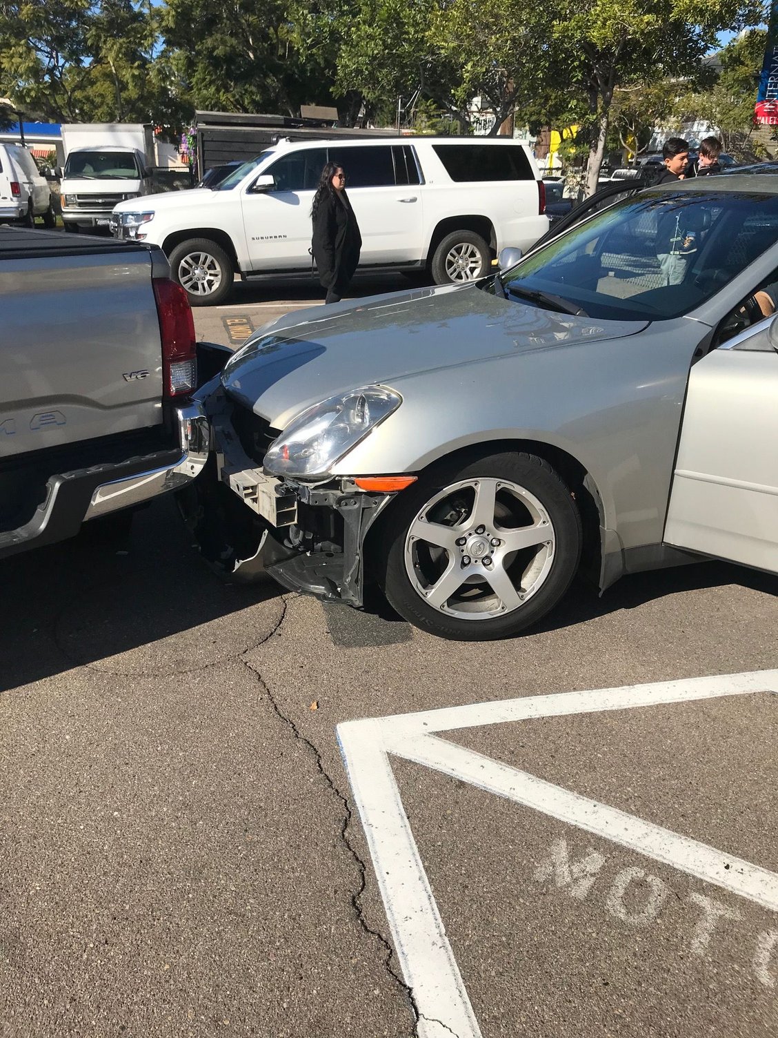

Some dumb broad cuts it too close in the parking lot. We were just sitting there parked like "this chick is wayyyyy close".
Here's the aftermath:
Almost the exact same injury/accident I had just a month after owning the car.
Sigh. At least this time, I have coverage. The lady is trying to say it isn't her fault... folks, always call the police. No matter. Just call em.
