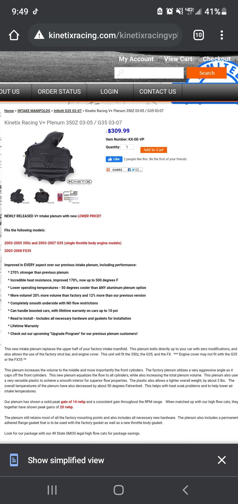

Is this better then a plenum spacer?
Does anyone know if this would be better then a plenum spacer and if so how much better? Is it worth buying?

It's not better, the Motordyne 5/16 plenum spacer has a long history of being the best option and has TONS of dyno runs on hundreds (or thousands) of G35/350Z to prove it.
