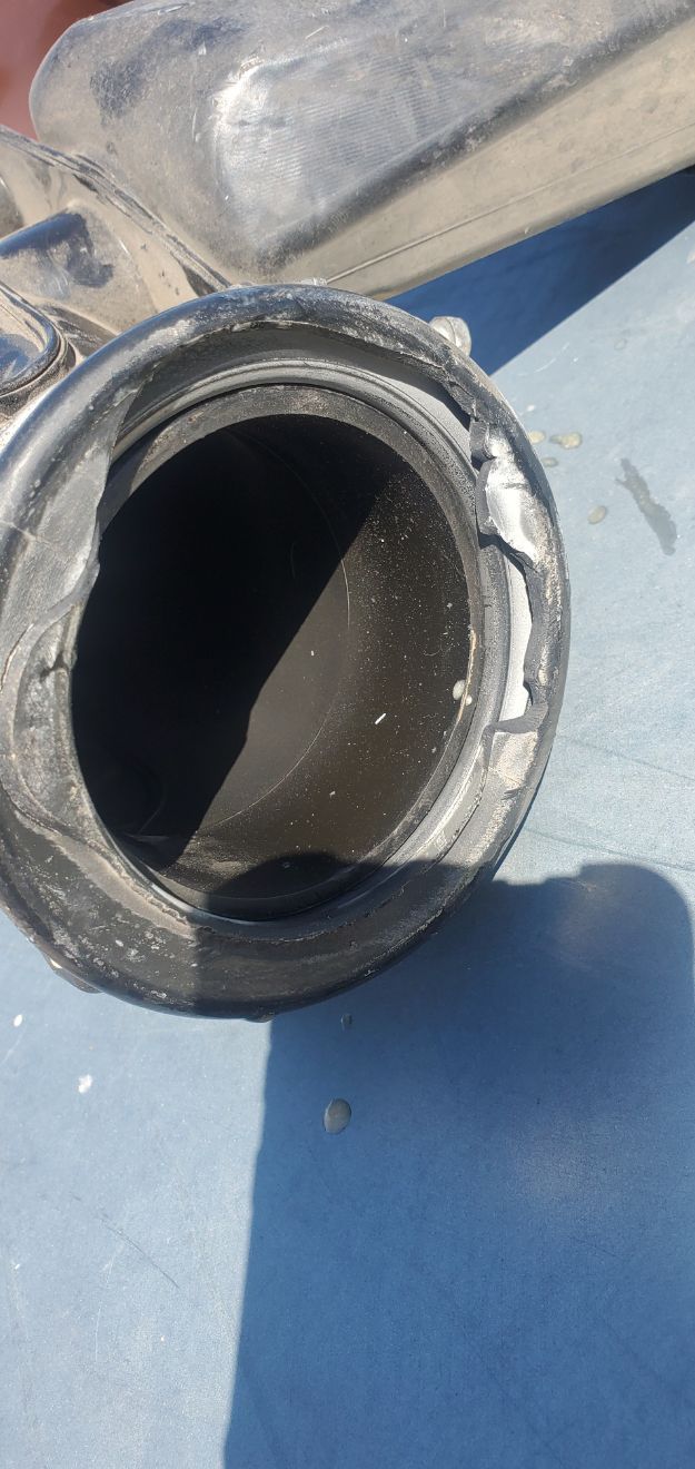

I am sorry that I do not have pictures of the intake its self, but only the two couplers. But the condition of the rest of the plastic is not much better than the two couplers.
I do not have the original intake anymore as it was un-usable after being removed from the engine bay. It shattered into pieces at parts.
Stillen Z-tube does not come with the section that houses the MAF(Which broke).
Only Pick-n-pull near me currently only has a '08 G35 which runs the 6-pin rectangular MAF. I can keep looking but its a crap-shoot when they may have a '03 G35 and HOPE it has the round MAF and not the rectangular. Since they thought it would be smart to have both on the same years.
Even if I had the original I don't think tape would have helped unless I just made a new one out of tape. (the box cracked in half, and there were multiple holes through the section where the MAF would go, I grabbed it to separate the corrugated coupler and fingers went through the plastic.)
Thank you, Not trying to be difficult. Sorry.

First line stated that I don't have images of the intake, ONLY the two couplers. I wasn't thinking about maybe needing them. Since everything I bought showed that it was compatible.(Like that ever happens correctly lol)
Part 1 (Filter Box and MAF housing): Box split slightly near where the metal clips lock it into place. Tube was punctured by my hand when trying to remove(plastic was extremely brittle) Not repairable. Tossed.
Part 2 (The one that the Stillen Z-tube would replace) Small crack, would have been repairable. Was tossed with the rest.
Both couples, as the images before show were completely destroyed.

I am sorry, as I stated on that last post, I only have images of the couplers. I did not think about taking pictures of the damaged tubing, as the coupler pictures were to send to a friend.
Nothing except the MAF was salvageable from the original intake. ( Small inlet near throttle body with the PVC hose snapped with about half in the hose still(Doubt I could repair it.), small crack in that section on the top like cover thing(could be repaired or patched.), The section with the MAF housing, had holes from when i removed it from the engine bay, It was brittle enough that I punctured the plastic when trying to remove it.(Could cover it I guess, but would mostly be an intake made of tape) Slight cracks in the filter box.(repairable/patchable))
