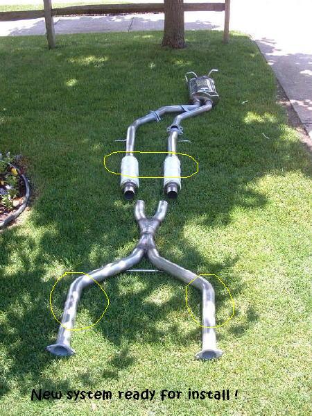

For everyone interested, here is an update. I have played around with this thing and adjusted, shimmed, banged, etc. on everything I could think of to make it fit properly. As a last resort, I took it to a couple of exhaust/performance shops and they played around with it, however, in the end the banging always came back after about 50 miles or so. The exhaust always seems to revert to its "sweet spot" which is too close to the car.
I called Stillen and they swear they have never heard of any fitment issues with the exhaust (and in their defense neither have I). The exhaust warranty, however, does not cover fitment because according to Stillen it fits.
The problem lies in the X-pipe I believe. As far as I can tell, it comes off the cats and angles up toward the bottom of the car rather than angling down or running parallel (and no you can't put it on upside down as someone at Stillen suggested I did because of the way the bolts come out of the cats). As a result, the resonators bang on the bracket under the drive shaft (there is less than a finger's width of clearance between the resonator and the bracket). In addition, after one particular adjustment part of the X-pipe actually banged against the bottom of the car frame. There is only about a pinky's width of clearance here as well. I think it is a matter of time before the torque of the engine causes this to hit again.
As a result of all of this, the exhaust is now sitting on my garage floor pissing me off. I really miss the sound but I could not enjoy my car with the exhaust on. I haven't really decided what I am going to do. I am sure that I can take it to an exhaust shop and they could bend/weld/whatever it to make it work, however, I really do not want to put any more money into this thing (especially if I am not getting substantial performance gains).

What then would you suggest is the problem? I can see where the exhaust has bumped against the car (it has rubbed off paint both where it was hitting the body and the bracket below the drive shaft). When I checked for clearance I had about a tight pinky's width in these two spots.
I have completely reinstalled the exhaust numerous times (both on my own and by a shop that has installed mulitiple Stillens on coupes). The install is pretty simple I do not think there was anyway I or the shop could have botched it. All bolts were torqued to factory specs when I personally did the install (except the clamps which were tightened without using a torque wrench). I did not over tighten the clamps for fear of not being able to remove the exhaust if I ever wanted to sell the car, however, they were most definitely snug enough to prevent any movement. When the shop did the install, they tightened everything tighter than factory specs (including the clamps) while shimming the exhaust in hopes of eliminating the problem. It did for a while but after a few days it was back to the bumping.
Anyway, I either have a one-of-a-kind exhaust or a one-of-a-kind sedan because the thing just doesn't work. Once the exhaust was removed from my car, the problem was solved.
If anyone else wants to try it on their car, come pick it up.

Well put everything together. No one else is having a problem except you. Your ypipe looked slanted which indicates either your engine mounts (one might be broken or not right) but I doubt its the exhaust.
Take a look at all my pics here and compare them to yours....
http://www.sah2o.com/russ/stillenexhaust1/part2/
Damn and I was just in Dallas!! Wish I knew about this or I would have stopped to compare yours with mine.

After taking a look at all of your pics it is hard to compare because the x-pipes are completely different. On the Gen II, the x-pipe is much longer. See JBX's pic below, I have circled the areas on my exhaust where I have the least clearance. These are the areas that bang or make contact (based on the fact that paint has been rubbed off the bottom of the car and where there is the least clearance).
The x-pipe hit the bottom of the car near the bends (not consistently just twice but I could really feel when this was happening because the whole car shook and it scared the crap out of me), the resonators bumped on the bracket below the driveshaft (this was more of a thud that I felt up through the center console armrest and once it started it happened each time I hit a bump).
Just in front of where the x-pipe bends there was only a finger widths clearance between the pipe and the car. I can't take the chance of the x-pipe hitting again because it was so violent this surely would have eventually caused some other damage to the car.
On your motor mount theory, I would hope that's not it seeing as how the car is only 6 months old. Is there some way I could check that myself? Wouldn't there be other symptoms of this separate from the exhaust? Sounds like this would have to cause other problems. I am open to any possibility.

Well, you can do this but be careful. Have someone in the car and have the parking brake up and the cars wheels up against something solid. And start to release the clutch to force the engine to flex which will cause the exhaust to flex as well. See if it flexes a lot. Really you can only tell if the mounts are bad by clunking or visually looking at them.
