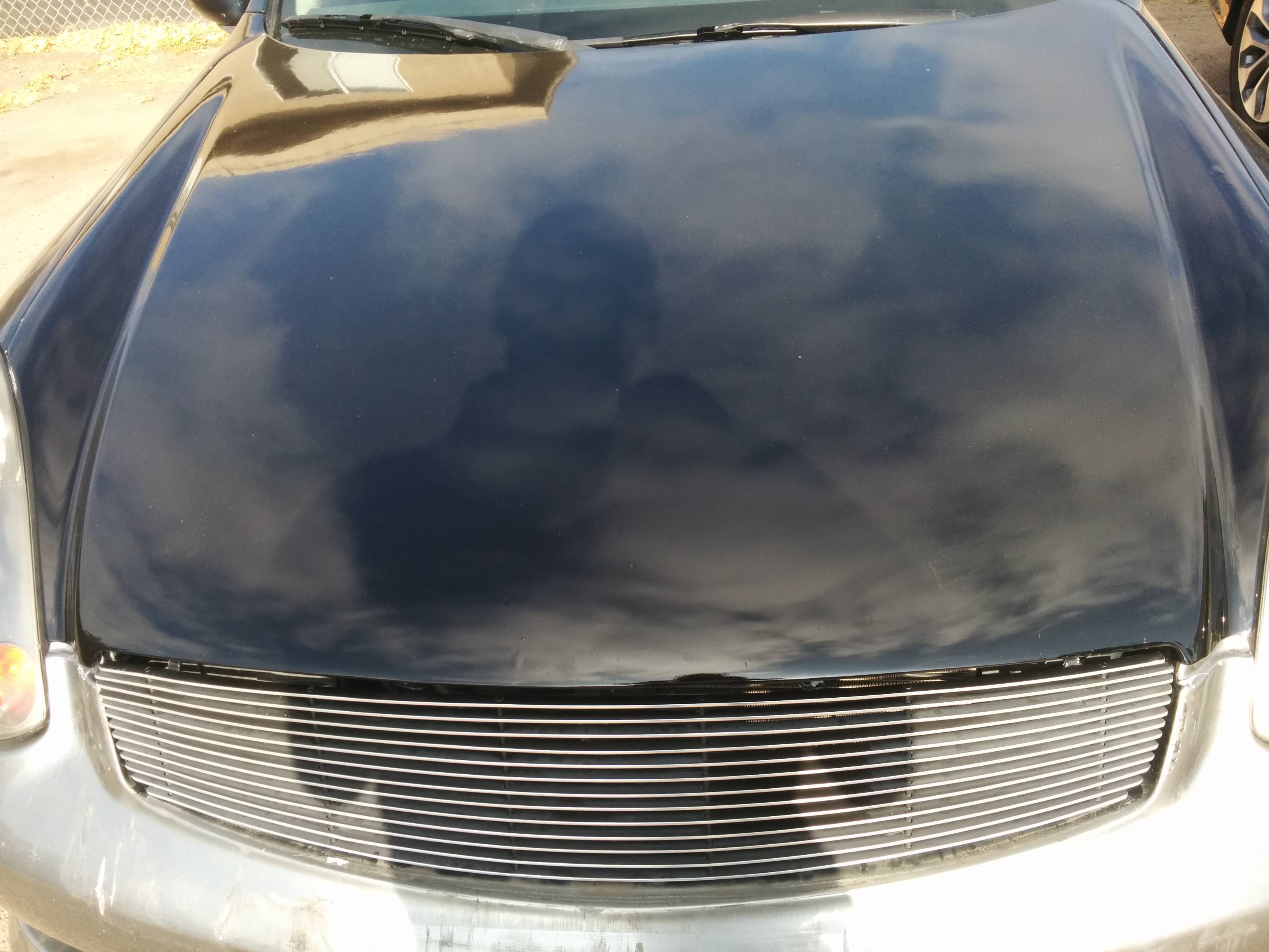

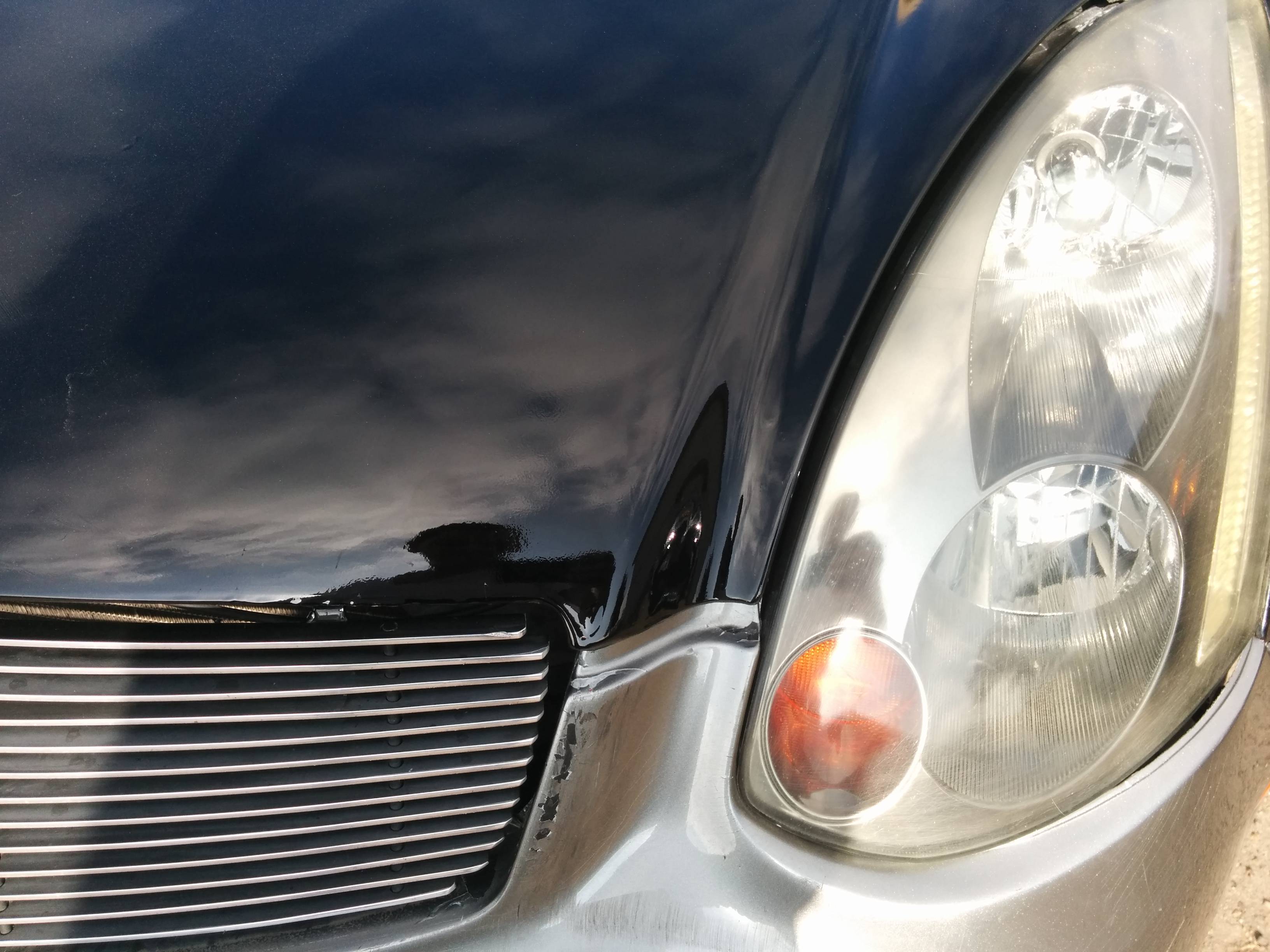

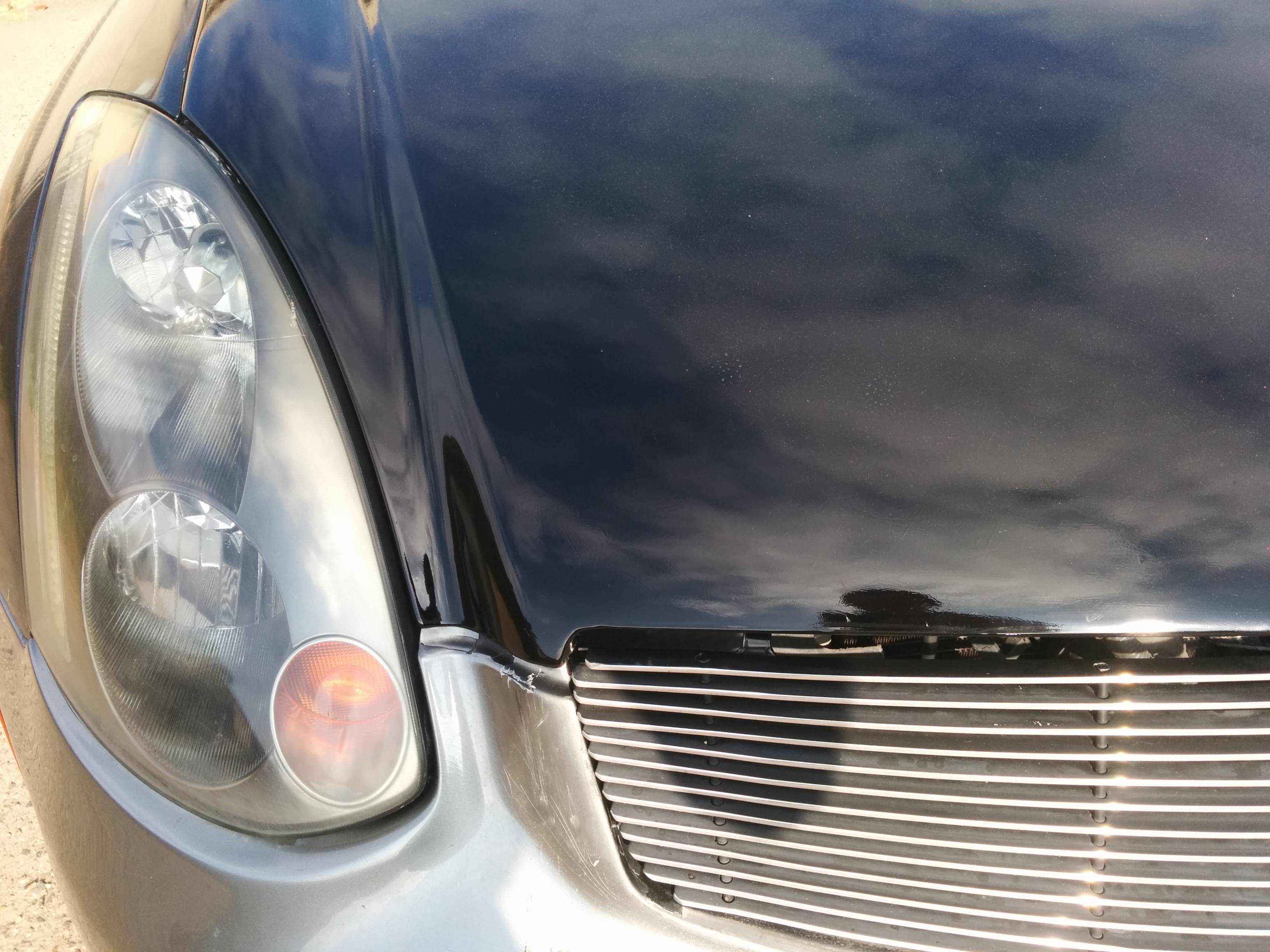

Over the weekend, I installed a Poly K2 Remix front bumper from AI on my '04 AT Coupe. It is almost an exact fit, aside from 1 thing that is bugging me: There is a gap on both sides, where my hood comes down into my bumper. I was thinking this is from the grill, because I don't have the OEM grill, but it was also there when I had the K2 Fiberglass. I guess without pictures it will be hard to explain, but I can't be the only one who had this issue. To try to explain it better: there is a gap on both sides, where the bumper meets the hood. If the grill was gone, it would be where the hood and bumper would meet on both sides. The area is close to the headlights. I will upload a picture when I get some time, but haven't had any lately. Anyway, if anybody knows what I'm talking about, or how to remedy the issue, please let me know. I had to remove the foam bumper support to install the fiberglass K2 that I had, maybe that is the cause?
EDIT: Sorry about the confusing post guys. So, I have uploaded a few pictures of the area. Basically, when I got the car, it had the OEM front bumper. It was in disrepair, and I needed a new one. However, the OEM bumper sat lined up perfectly. I changed out the bumper for the Fiberglass K2 front bumper, and that is when I saw it didn't line up perfectly. I had a body shop try to fix it, and it still didn't sit right. I decided I would try a different bumper, and found the Poly K2 Remix. This one lined up perfectly, aside from these 2 gaps. The same gaps were on the Fiberglass K2 bumper. I thought maybe it was the core support was pushed down, but the original bumper sat perfectly. Any ideas would be taken into consideration, and maybe tried out.

Thanks for not blasting me. Updated with pictures.

I would fix the fitment of the hood/fender first, than worry about the bumper.

So, I think this might be a clue to my issue also. The hood lines up with the fender good, but when it is close (and latched), it seems like it is still open about 1/4in. I'm thinking it is indeed the core support pushed down, now that I put the puzzle pieces together. The hood closes proper from the back, but when it gets towards the front, it looks open the 1/4in. I thought it closed proper before changing the bumper, but maybe my memory is not good. I think I will have them check the core support and lines when they get my car for paint next month. Until then, it still drives right, and it isn't really noticeable.
On another note, the guy I got the Fiberglass K2 bumper had pictures posted of it on his with the same gap. I'm just gonna have to tell my body shop when we go to paint, to make it look like it rolled off the lot, even if it costs a little extra.

I was referring to the area above the passenger side headlight, looks like the hood is hitting the fender and you could easily tell the the pieces don't line up. And if the height of the hood is off than adjust the latch assembly, its only two bolts.
Ohh, I see what you are talking about, it's just that picture. I will try the hood latch. Thanks for the advice.
