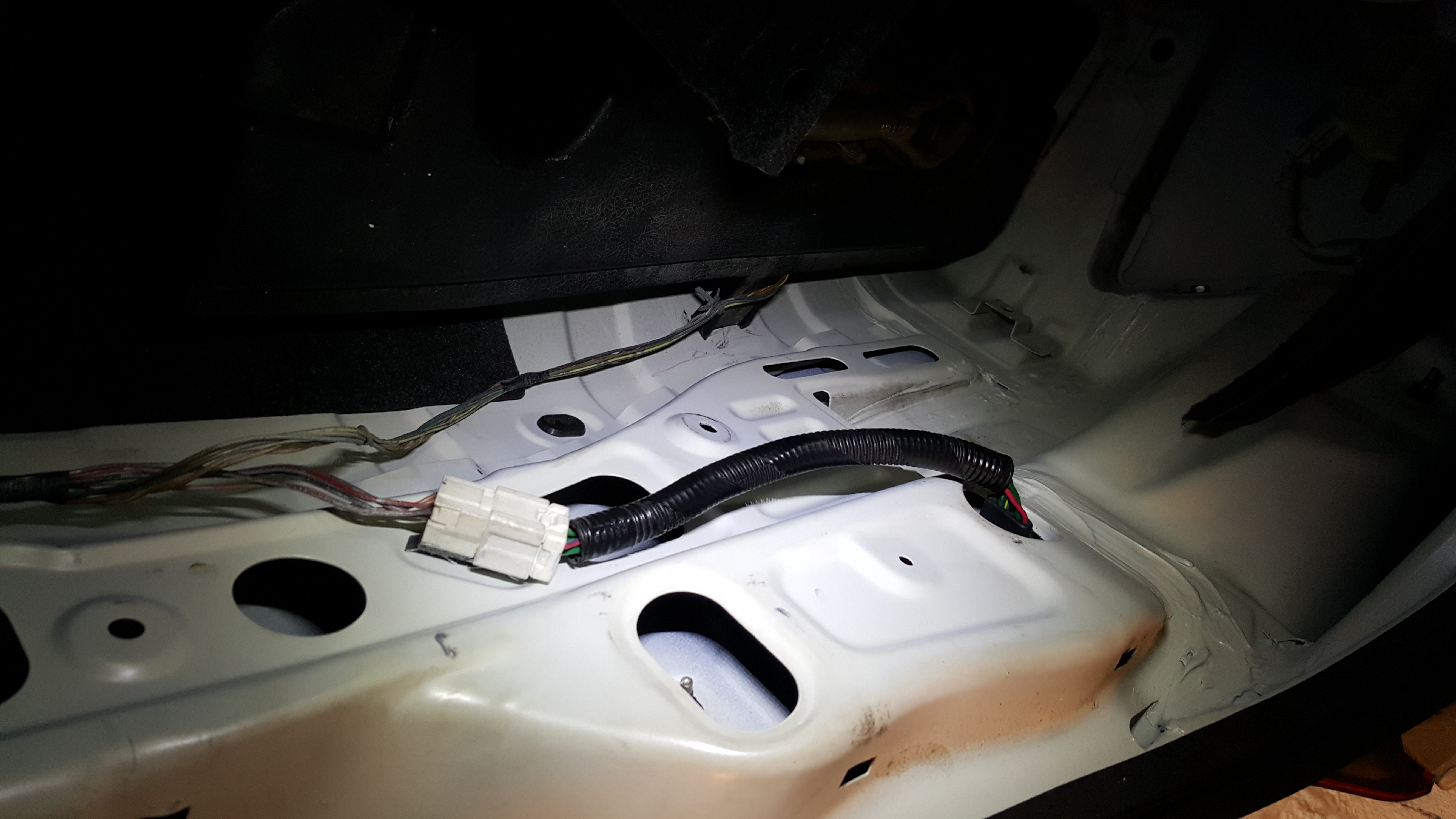

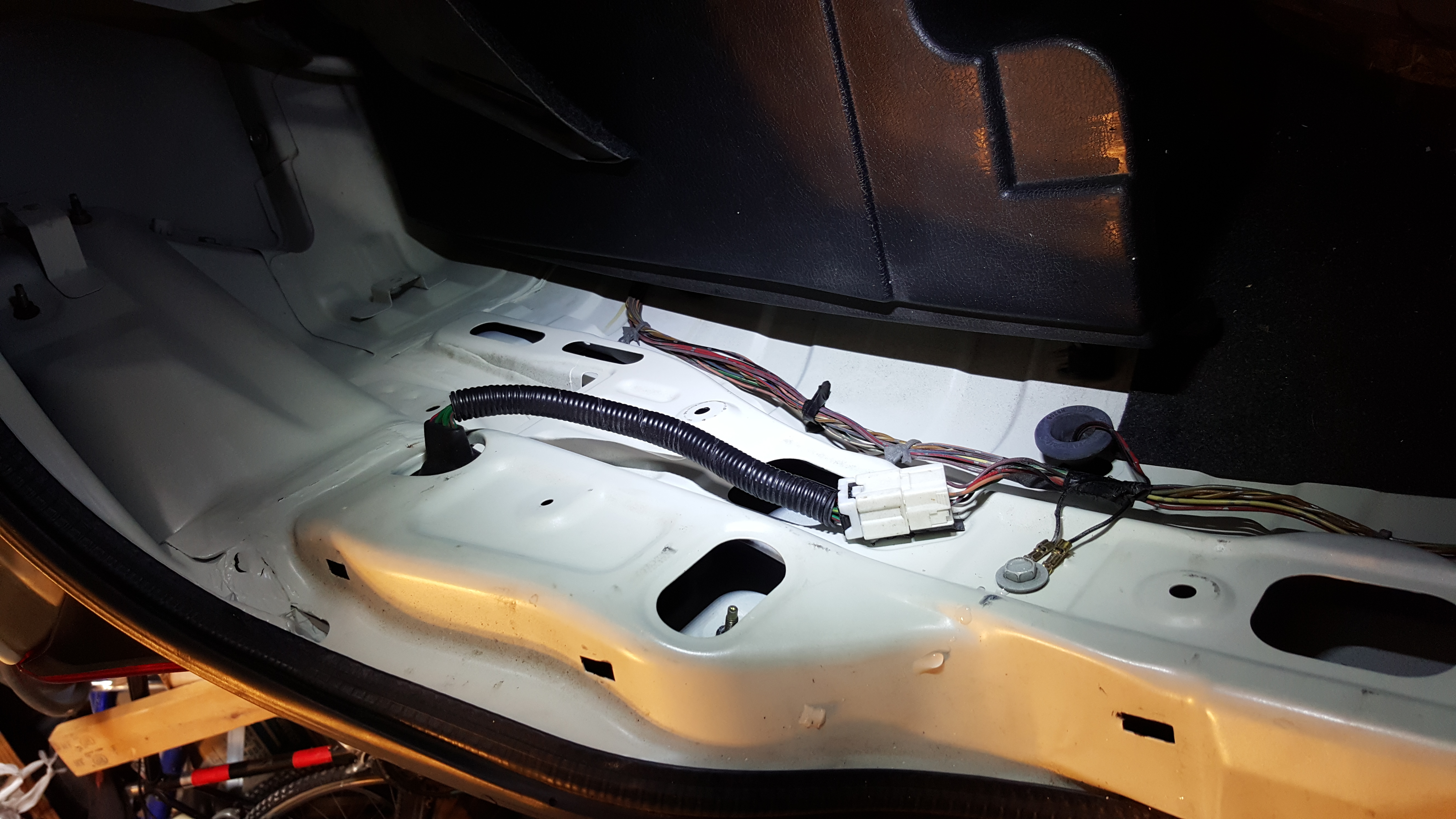

well i guess i would take the rear lights off and make sure the wires look intact and that nothing is spliced into the lines.
also i would check your grounds. bad grounds have made other cars i have worked on do some crazy ****.

I second hurley, I immediately thought that a harness mod from diode dynamics or something similar is plugged in the rear led wiring. Pry out the plastic cover and inspect the wiring.

It doesnt look like there is anything connected to the tail light harness : ( see attached pictures. Any other recommendations or suggestions would be much appreciated. Im very lost.
Attached Thumbnails Turn Signal / Hazzard light issue! Any help is great!-20160210_124427.jpg   Turn Signal / Hazzard light issue! Any help is great!-20160210_124415.jpg
Old Feb 10, 2016 | 10:07 PM
Homamk's Avatar
Joined: Feb 2016
Posts: 6
Well i cant figure this out. From what i can tell.. something has been done to the car to get the brake lights to flash. I dont think that is standard for these cars. The brake lights never flash during hazard or signal light. However, nothing is connected to the harness of the tail lights. Im at a total loss. There was a relay in the trunk but when i unplugged it.. nothing changed. Any suggestions help? Completely lost. I cant drive the car because of this.

Maybe your BCM is hosed?

Yea, certain things can work completely normal and other things get fubared. You'll need a wiring diagram and check for power from BCM to lights. Then check wiring continuity to make sure the wiring is good. There are some ground connects as well that can cause issues I think. There is a couple of fuses I think also. Look for the FSM at thenismoclub.com and start from there.
If you do need a BCM you'll have to go to the dealer to have your keys reprogrammed.
