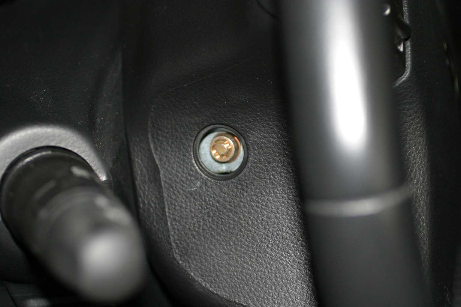

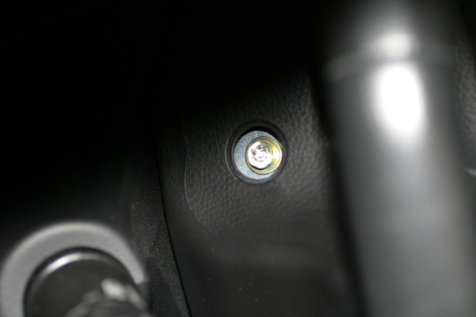

So I got the Nissan airbag cover from a friend in Japan, and I'm trying to take off the airbag so I can replace the cover. Problem is the bolts holding the airbag in place are strange, almost like little wheel locks... anyone know how to get these off? I did a search and the only thing I found said to use a t30 torx bit, but that doesn't fit. Oh, and both bolts are totally different -

looks like a torx bit

Go to kragen auto or a auto parts store. They have a set you can buy for about 10.00. Its a security torx.

I bought a set of them at a local auto supply store. The guy knew what they were and said that they were pretty common. The 5 heads cost me $30 CDN. Also some store rent out tools, you might want to try that as well.

I bought my TORX bit from autozone. There's different sizes, so I would suggest trying them out before you leave the parking lot of the store. This way you can return them right away if you got the wrong size.

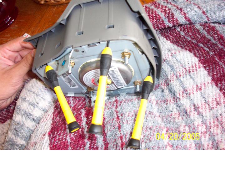

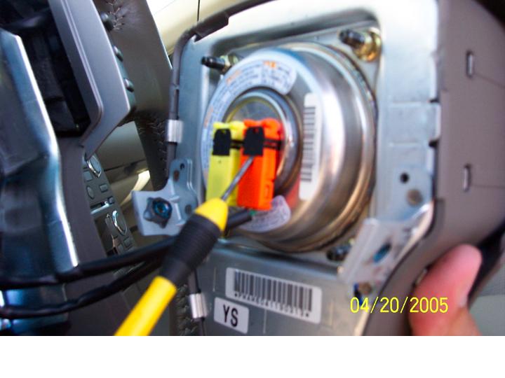

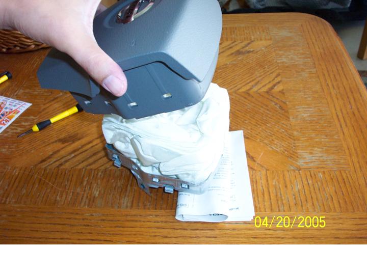

Here's some pictures I took when I swapped mine out.
Good luck.

Thanks guys, I got it off. The pics were a lot of help -
