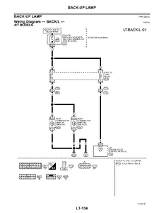

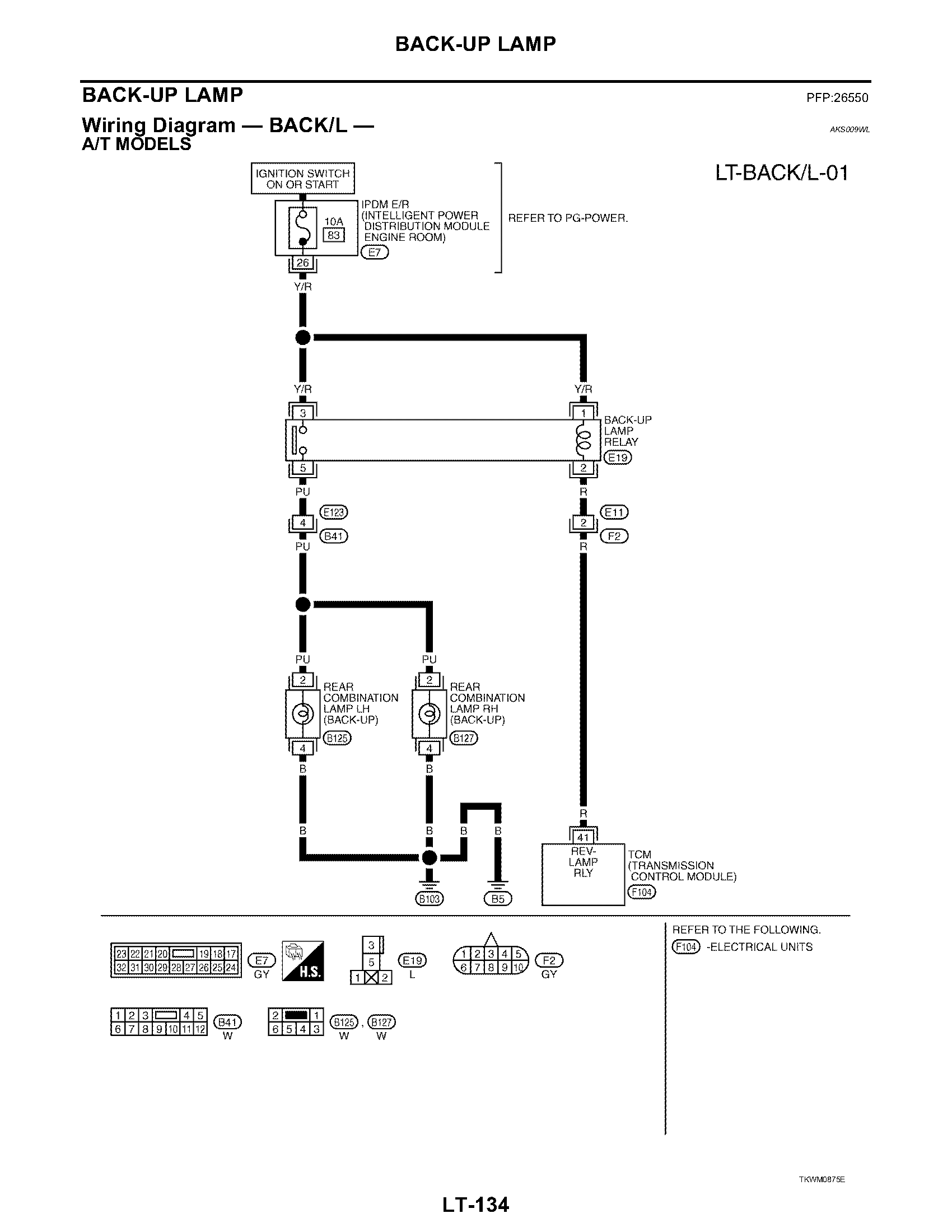

It isnt missing. 6mts dont use a reverse relay, it gets feed directly from transmission. Only 5Ats have a reverse relay.
Refer to electrical service manual.

I already posted the service manual and wiring diagram. It is either the relay, the fuse, or the bulbs. Check each one by one, if all are ok, then you have a ground or loose connection somewhere.
