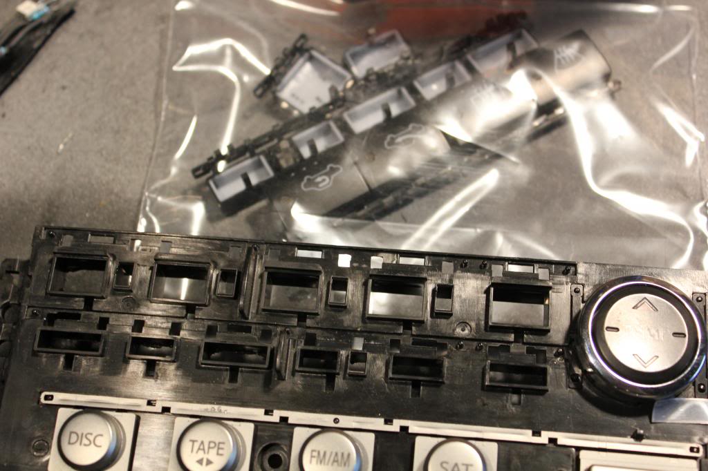

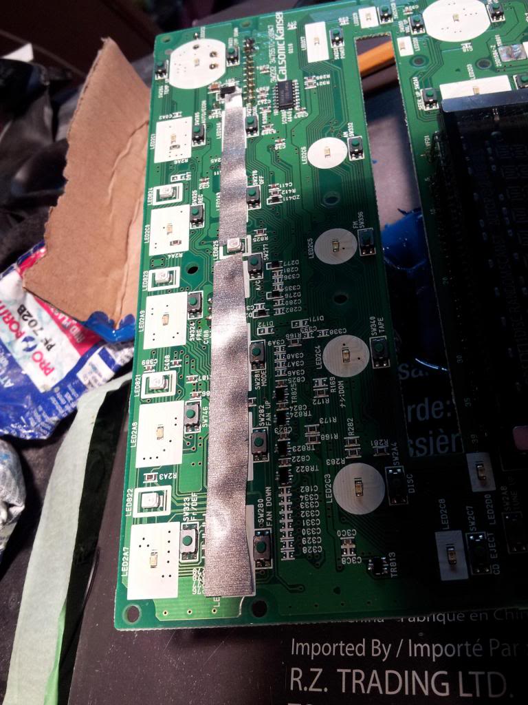

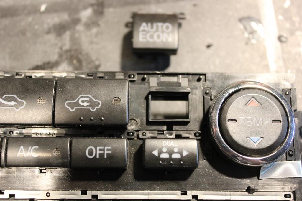

The buttons DO come off.
I had to shave the plastic down considerably more for clearance, and removing the buttons made a ton of sense to try and save from damaging stuff!
Going around the little Indicator light spots is going to be a royal PITA, but a little bit more got done last night either way, and eventually, I'll get there:

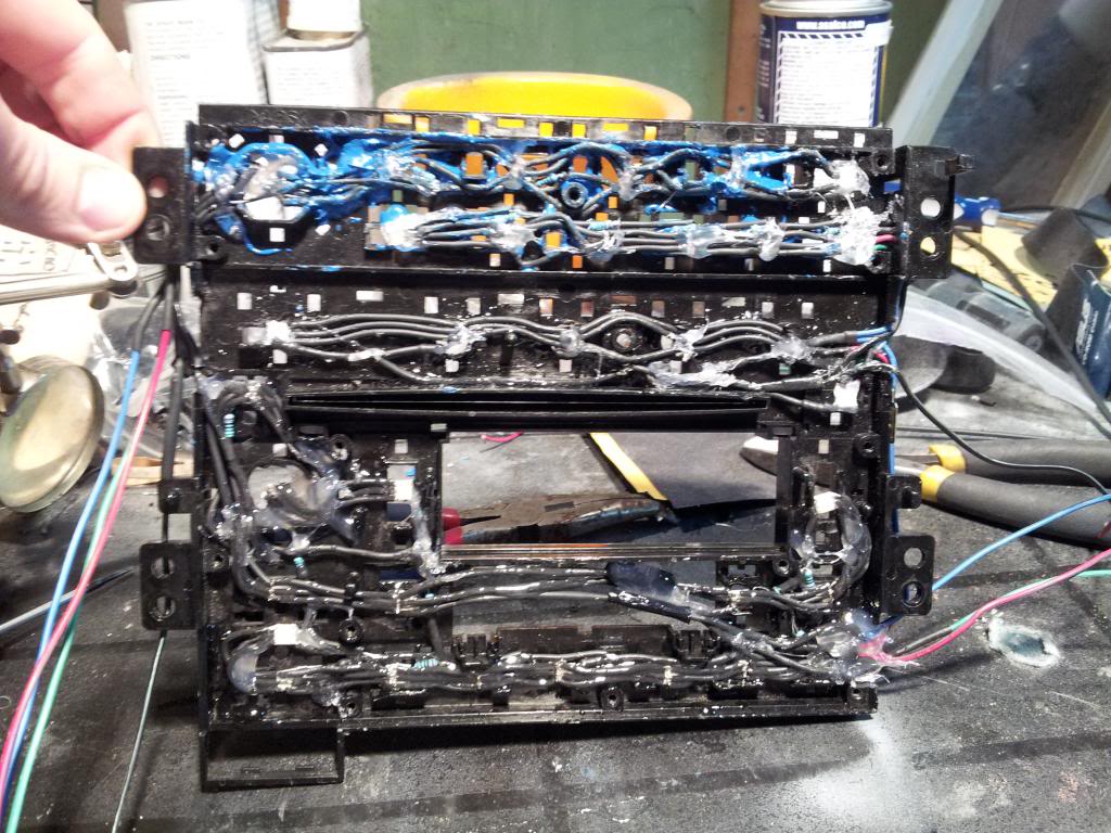

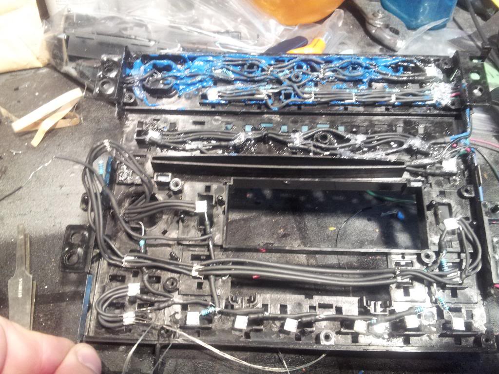

Feb 10 Update
One row done and epoxied in place.
Just used some high qual. vinyl to try and lower the chances of a short

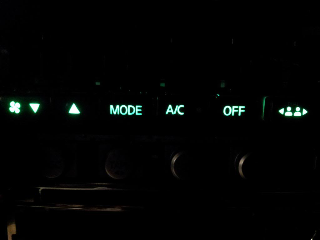

Buttons on and test:

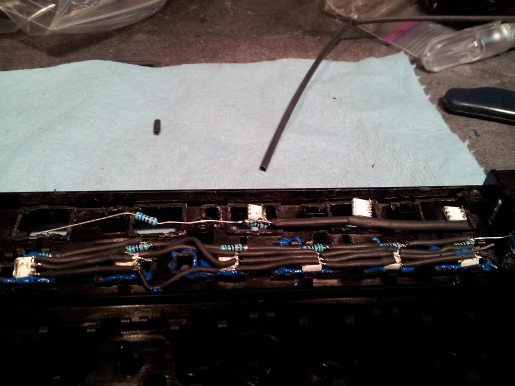

2nd row started.
And almost done painting some of the interior pieces

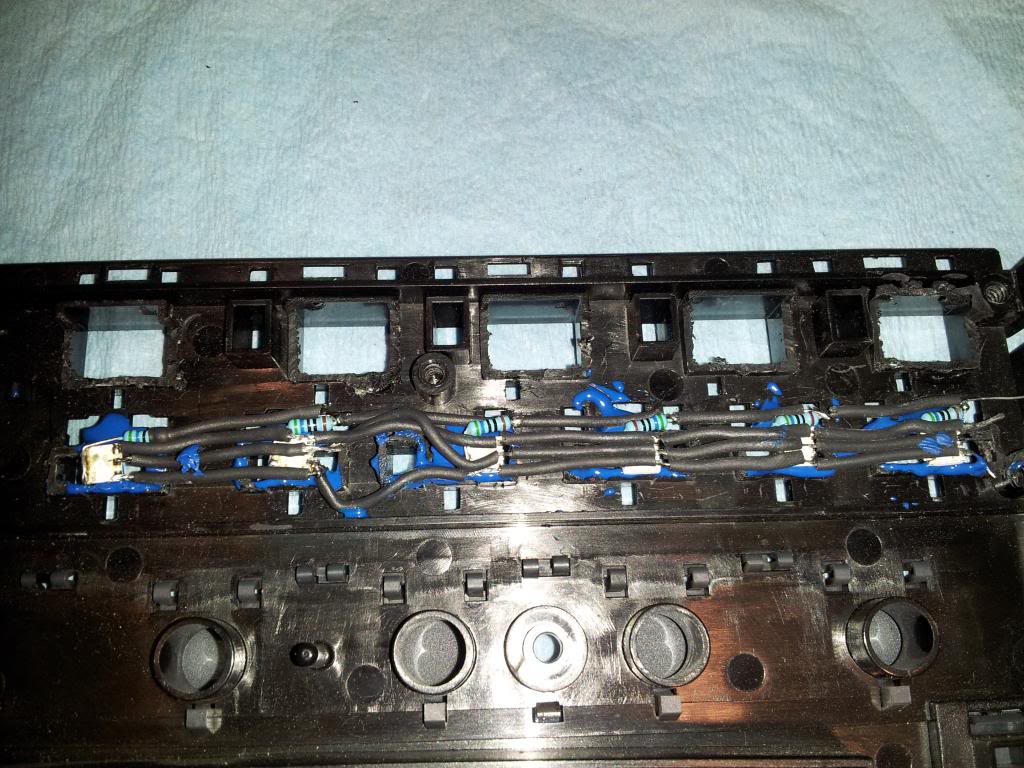

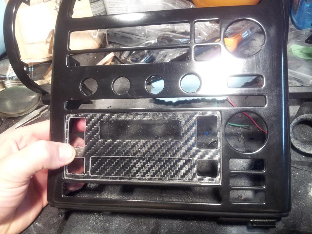

End of March

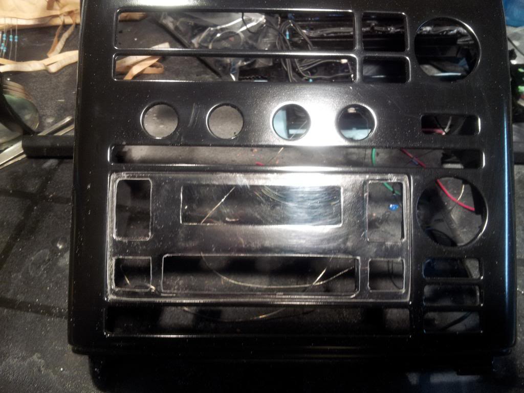

Crappy celly pictures, apologies, the camera is out for repair.

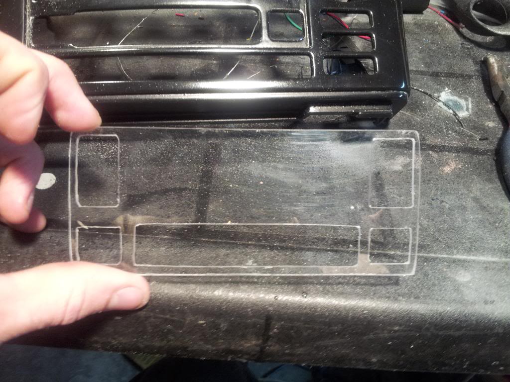

An idea. No idea where I"ll take that.
Also the clear piece I made is getting re-done because I've decided to delete the Tape track completely. I'm going to decide on some sort of emblem to go there. V35 is on the list of potentials.

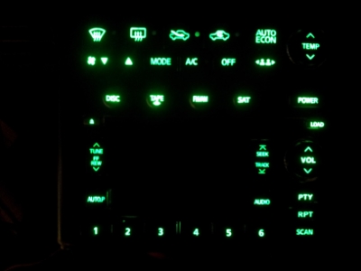

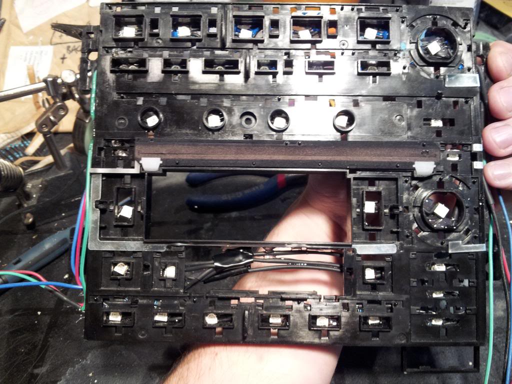

Very surprised that this actually came together and all works, considering the ridiculous wiring and customization involved in it (imagine 4 wires to every little LED on a tight-*** circuit board, all connected to each other, with resistors on every one, and all the buttons have to work, etc.
Very happy it's finally done. If it ever fails I'm giving up
