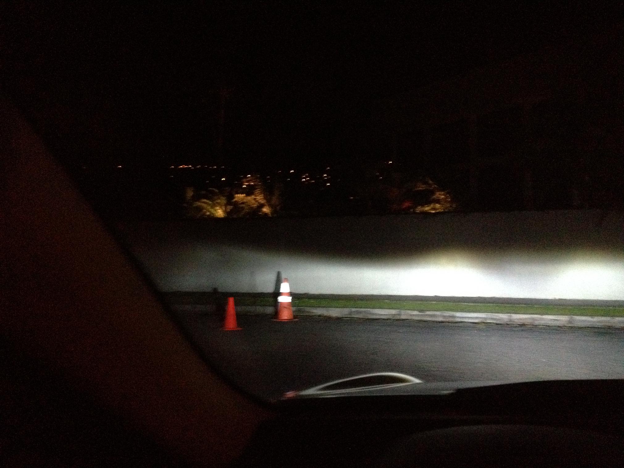

i cant get a clean cutoff on my projectors this is what they look like any help would be great thank you.

Did you just upgrade to those? looks like the heat of the lights is not far enough spread out, there is a DIY for aiming your lights and that should help some, oem projectors suck and people do the TSX lense swap and modify the lense shield and get that crisp clean cut line.

the heat spots are where the light looks the brightest [ focus of heat] they should be more spread apart. So instead of narrow they should be opposite of that,

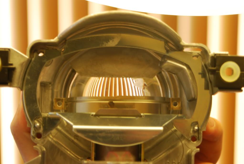

this is what peeps are doing. this is involved but gives a great look. i did this too.

what exactly is he drilling in the third pic?

which way is the cut off shield suppose to face? is the cup side supposed to face foward or backwards?
The cutoff shield curves forward. If you go through with taking yours apart you will see stuff will fit one way. In the third pic he is drilling to top "lip" in the projector housing but that is not a necessary step if you are looking to even out your cutoff line.

it looks like the guy drilled the whole thing off http://smg.photobucket.com/albums/v6...3337-K1024.jpg but in this picture it look like its still there? http://img.photobucket.com/albums/v6...Y/DSC_0700.jpg so what do you suggest? i can push the shield forward without opening it up, should i just do that? also the whole thing seems to move around a lot inside the housing idk... thanks for the help.
