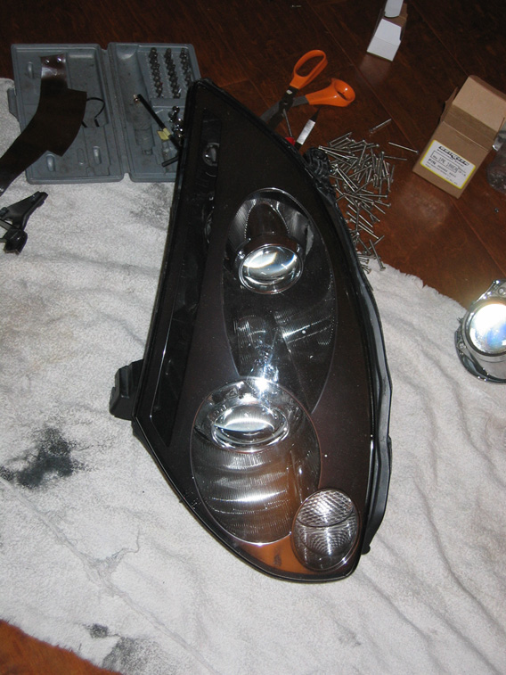

Here's a dual projector set up in the works.
The shroud for the lower projector needs final fitment, then they have to be aimed. The wiring also needs to be done. It's TSX's in the low beam, RS6 bixenons in the fog/high.
If all goes well, the clearance strip will be CCFLs.
I would upgrade to projectors for the cutoff line. For me, the sharper the better now.
Oh man E_K I dig! Lookin sweet. Did you shroud the complete TSX projector or only the front half? It looks like you didnt use the reflector as a mounting point.

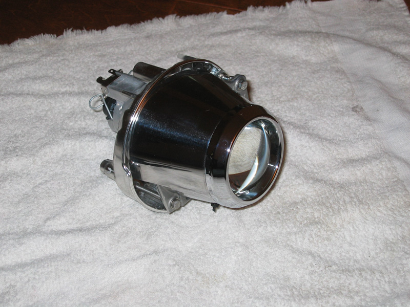

I shrouded half the projector. It ends up sticking out the same amount as a E46 or E39 projector.
I finally gave in a realized that I needed a clear lens projector for the low beams. You can see how clearly the reflection is in the lens.
The shroud is polished metal sheets. The sheets are only $1 at the hobby store, but it took an entire evening to polish one of them to this degree of shininess.
