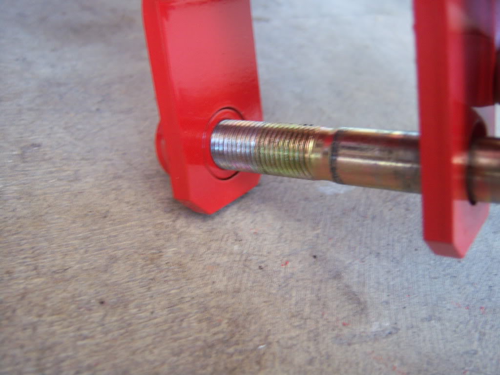

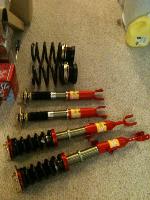

Big pain in the butt weekend getting this one, due to a problem with the oem bolts not fitting in the new rear strut and because of a seized nut that ending up being cut off. But, they are on and it's getting aligned tomorrow.
The goods.

Bolt FAIL.

Looks great, do you think i will have the same bolt issue if I got a set for my G35?

^ yup. If you got the newer batch of coils that has the welded bolt at the end. i would just ask the vendor if the coils come with welded nut.
It's an easy fix if you can find the correct bolt.
I would say 99%, I just got mine and I talked to people who got these a good while ago and even told f&f about it but obviously there was no change for my batch. It isn't a problem you can't work around, it just really helps to know about it before you have the car up trying to put the struts on. If I were to know before hand I would order another of the oem bolts and take the bottom of the new struts into a machine shop and just have them drill it to open it up. This shouldn't cost much and your car isn't gimped because of a partial coilover install.

Loving the drop ! Fandform needs to supply the correct bolts. Lucky for me member la13 had a few extra bolts that fit.

great coils but they really need to supply bolts.
