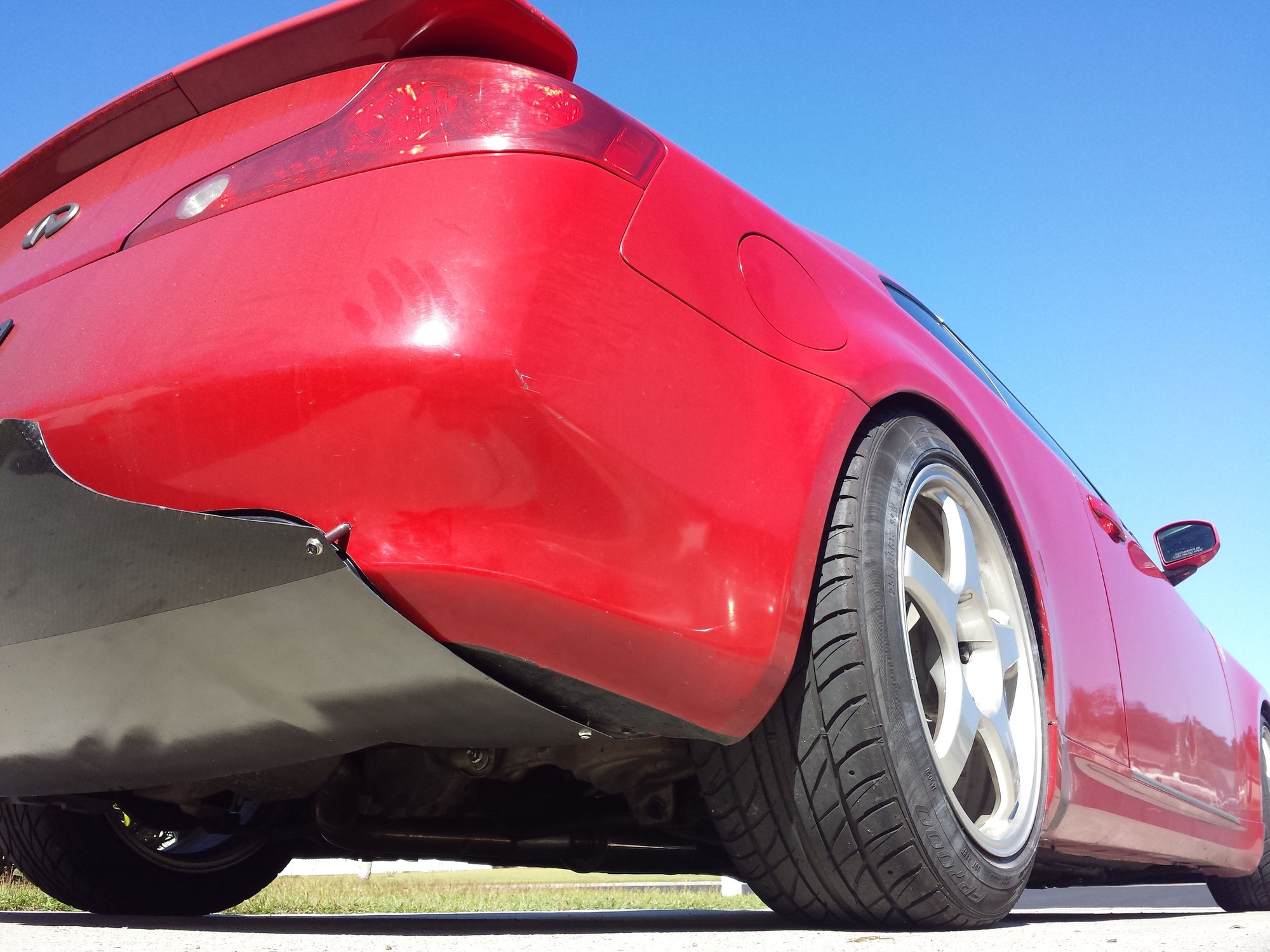

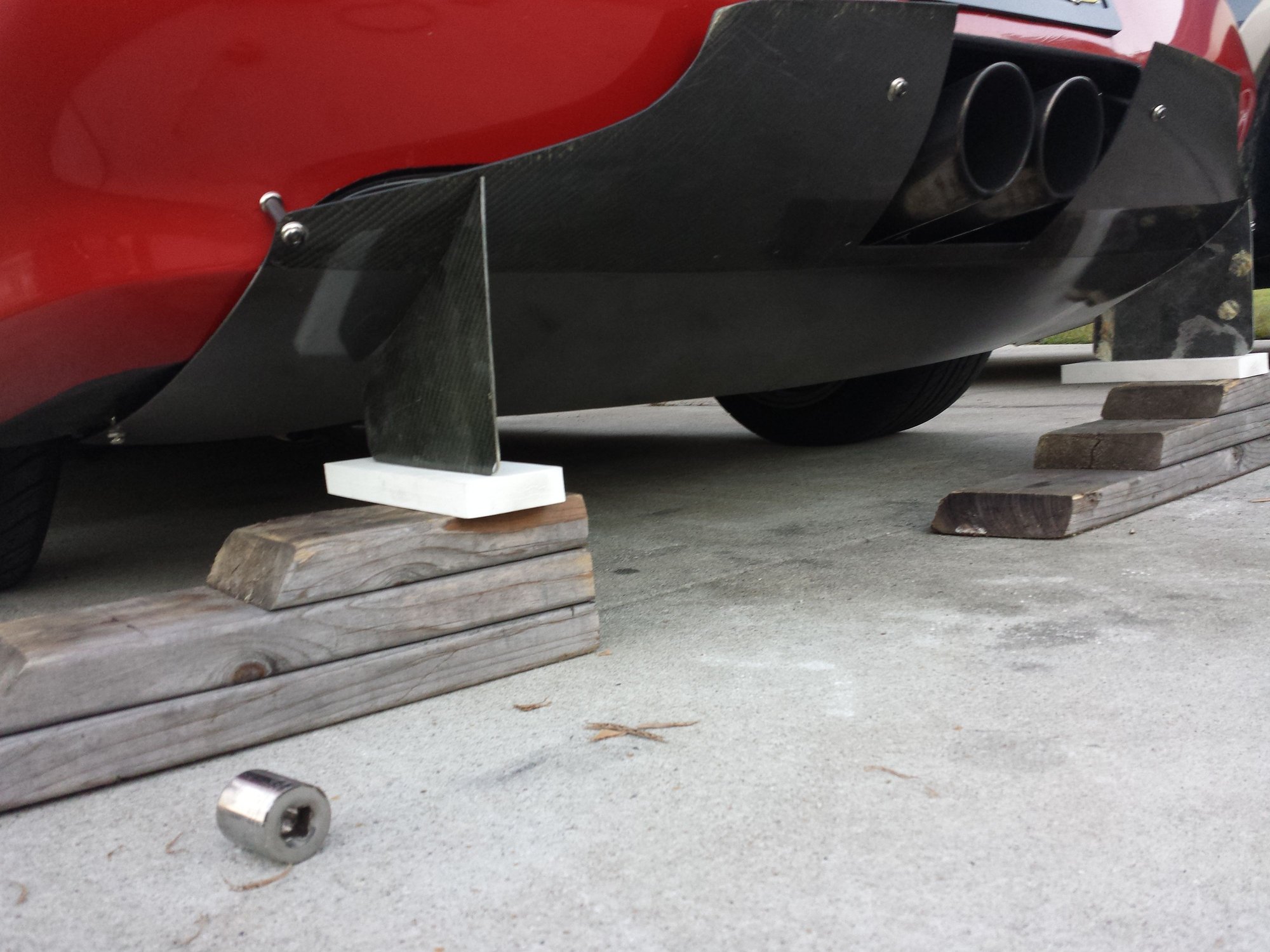

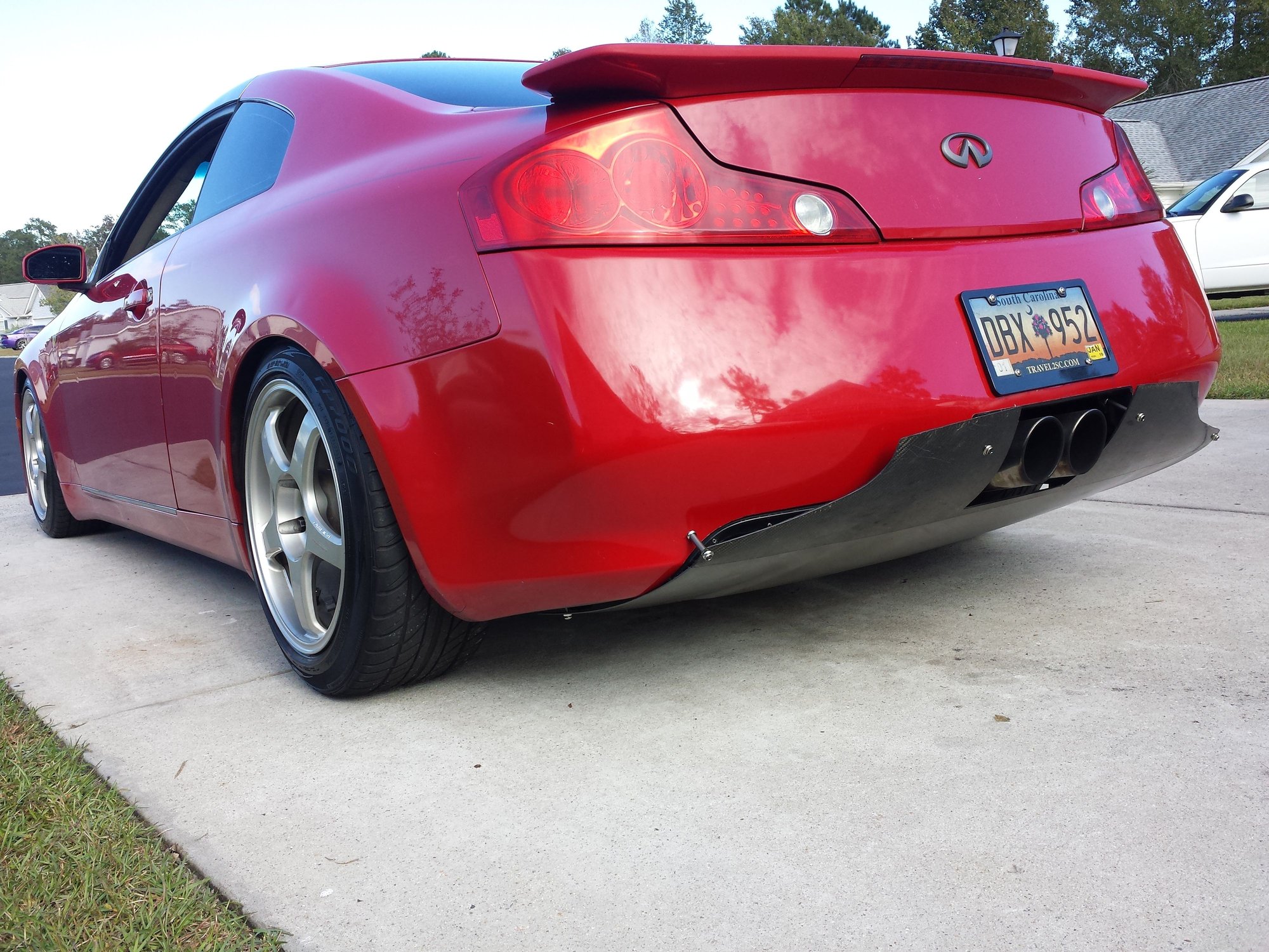

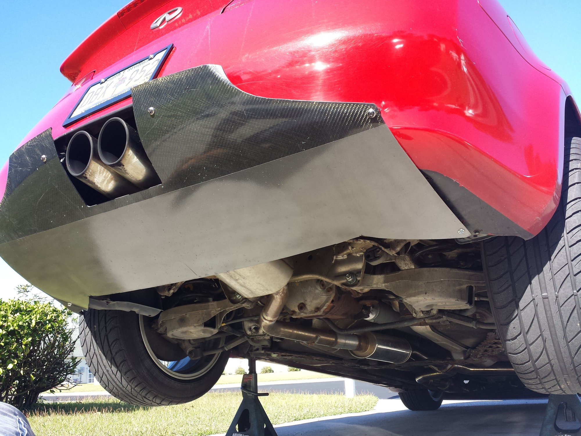

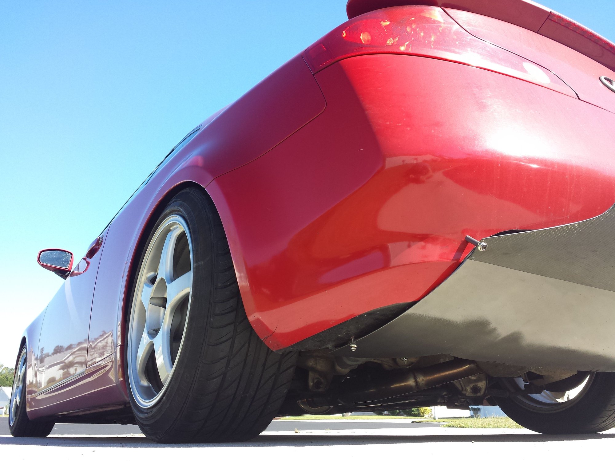

Did some more work on the diffuser today. Fiberglassed over the holes from the hood pins, and sprayed a coat of undercoating on for sound deadening. I've got some nice pieces of cardboard for fin templates on the leftover cf that I hope to get to this week.
Ordering 50mm rear adapter spacers for the new Enkei wheels. They are on, but sunk in the back and I can't handle it..lol
They are SO LIGHT.. the twists were so heavy in comparison. I can feel the reduction of weight in the wheels even in turning effort and the rear tires will spin if I'm not careful...

getting late and I need to get to bed.. I'll just leave these here.
planning to build the fins tomorrow

still working on the fins. I have 2 smaller ones finished and painted, they will be on the lateral portions. The medial fins will be longer and I haven't started them yet.

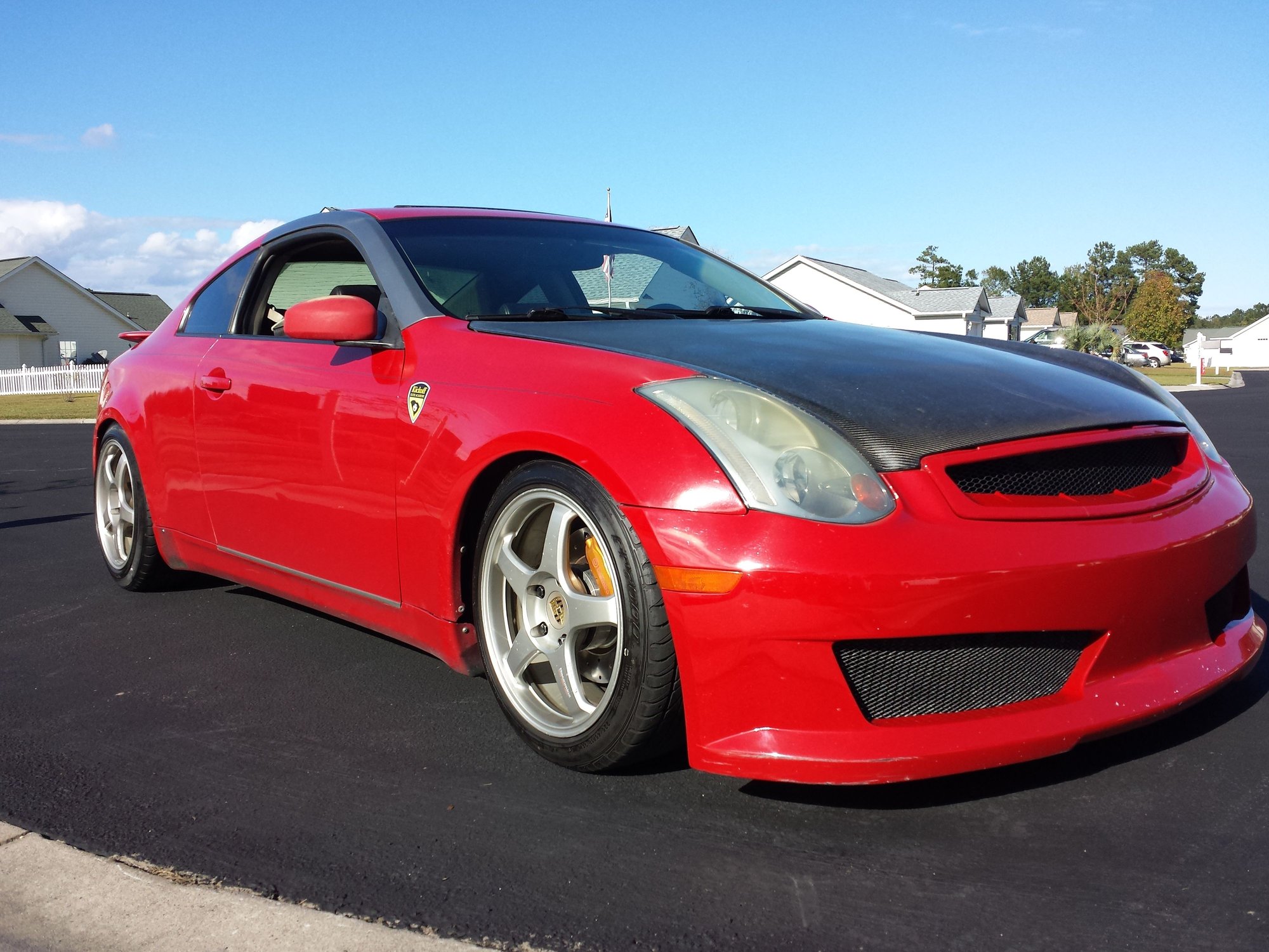

I'll put up a few pics from the other day to make me feel better. Lol

The diffuser with some vertical sections really looks nice. Keep it up?

Another major change is coming soon. I had my brother pick up some new headlights for me in GA. The seller says that they are 2006, and that will be awesome if they really are, but even if they are a clean set of 2003-04 I will still be winning for the price I got them. My 2003 headlights were clearcoated long ago and it has chipped and now is peeling in sheets. My night vision sucks as it is and has gotten worse lately with the lights. looking fwd to replacing them hopefully this week.
