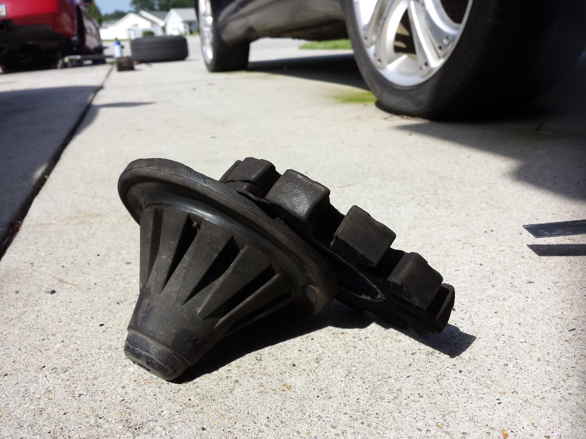

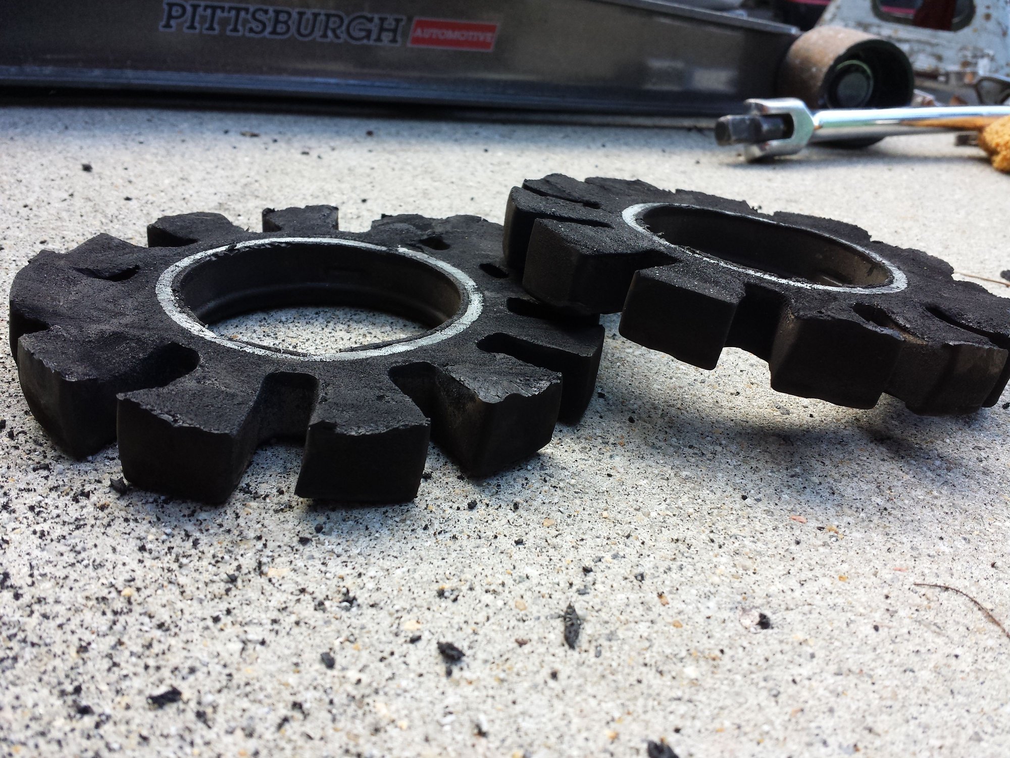

-chopped the rear spring upper rubber mounts to level the drop on the car. Took about 1" off the top of the spring rubber mount. No more rake, looks GREAT now, and the handling changed for the better..not as tail happy and more planted.

had fun driving to work tonight in the wet. This car is a blast on damp empty roads. Since I brought the rear down it is very predictable controlled oversteer when I want it, and on wet roads the tires break loose thru 3rd if I want. Yes, the car is finally running up to par.

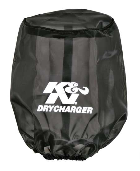

I have the same thing I just run one of these
Attached Thumbnails the 00 6mt Craigslist Coupe... uhhh...build?-photo608.jpg
