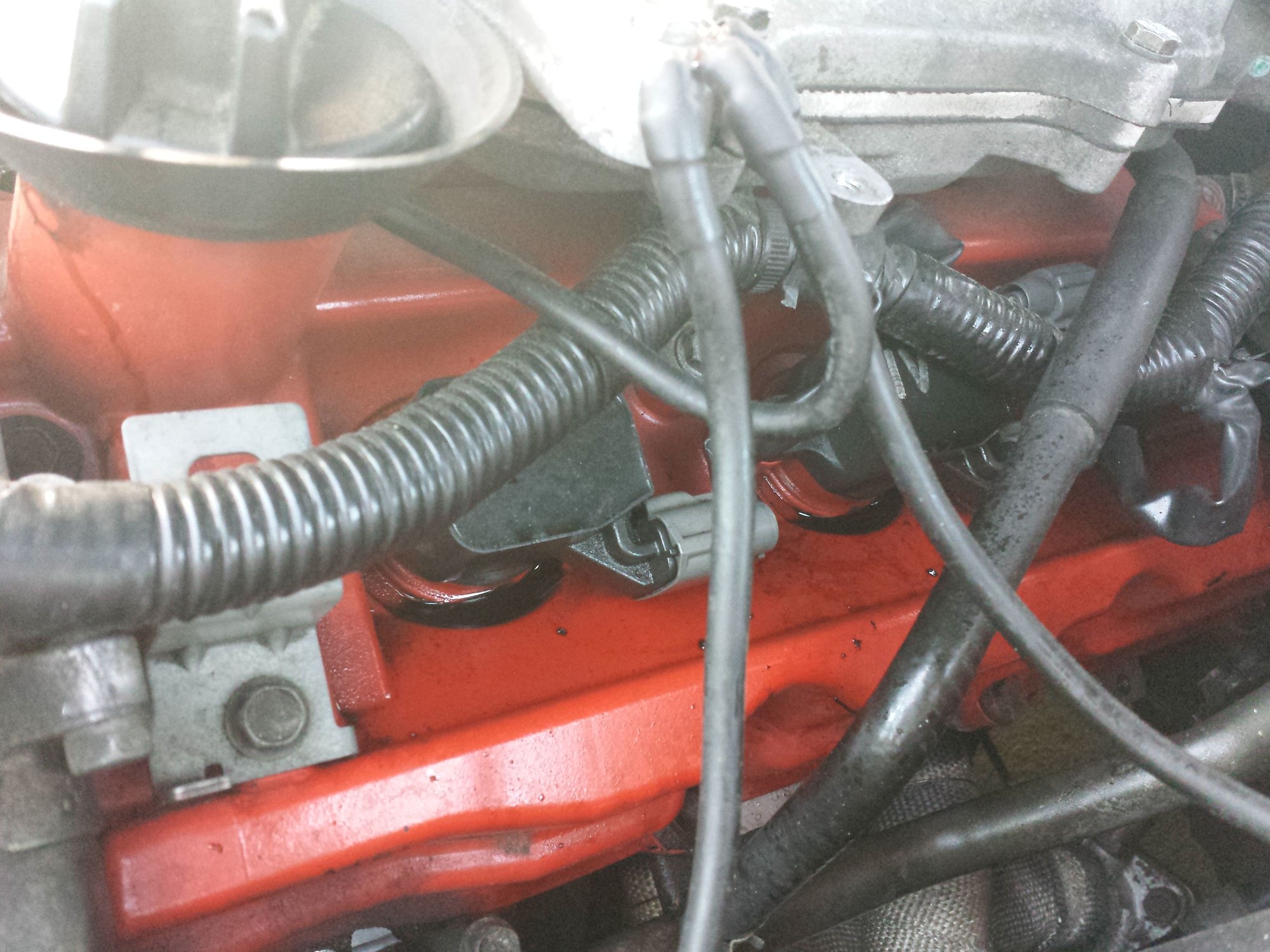

I dug back into the car last night. I have MAJOR issues with the PCV system so I spent a long time researching PCV routing and have concluded that I'll be changing my can design.
I never actually got any oil in the can, but a ton of condensation mixed with the oil vapor.
I have the plenum removed right now, I can see oil on top of the valves. 4 out of 6 spark plug holes are FULL of oil, yet the car never misfired. There was considerable smoke from the exhaust, and the oil was actually spewing from the valvecovers and spilling onto the (wrapped) headers causing a loty of smoke there too.
First thing I'm about to do is clean out all the spark plug tubes and then pull the plugs. next is a compression test.
I emptied over half a liter of combustion vapor water from the catch can last week, and the hose to the intake was pulling a lot of suction at WOT. And I'm at WOT a lot. I'm wondering if G forces on the turns at WOT may have sloshed the water over and I sucked in some. A self contained hydro-lock. I haven't noticed any rough running, no check engine lights.. other than the obvious smoke.
So.. compression test. If that doesn't reveal a big drop in compression, I'll chalk up the problem to catch can R&D and take it back to stock configuration until I figure out a re-design. Good few hrs of work ahead..
Stay tuned

So the compression test results were positive, from 207 to 220 cross all 6. the cylinders were wet with oil from taking out the soaked plugs but I was looking more for consistency so it's good.
the spark plugs show good burn on all six also. no carbon or oil was there.
moving ahead with the idea that my pcv design was a major fail and the engine is ok.
Old Jun 9, 2017 | 04:04 PM
  #156
EPiK's Avatar
Joined: Oct 2015
Posts: 703
Likes: 53
Pulled both valvecovers and still looking good. The gaskets were both still sealed, but it looks like the spark plug tube seals were spewing the oil.
Cleaned and degreased both covers and while they are drying I took a break and went to the park with my son and the dog.
Feeling confident that the engine is healthy and should go back together and be great again.

Bad news. Spark plug tubes full of oil

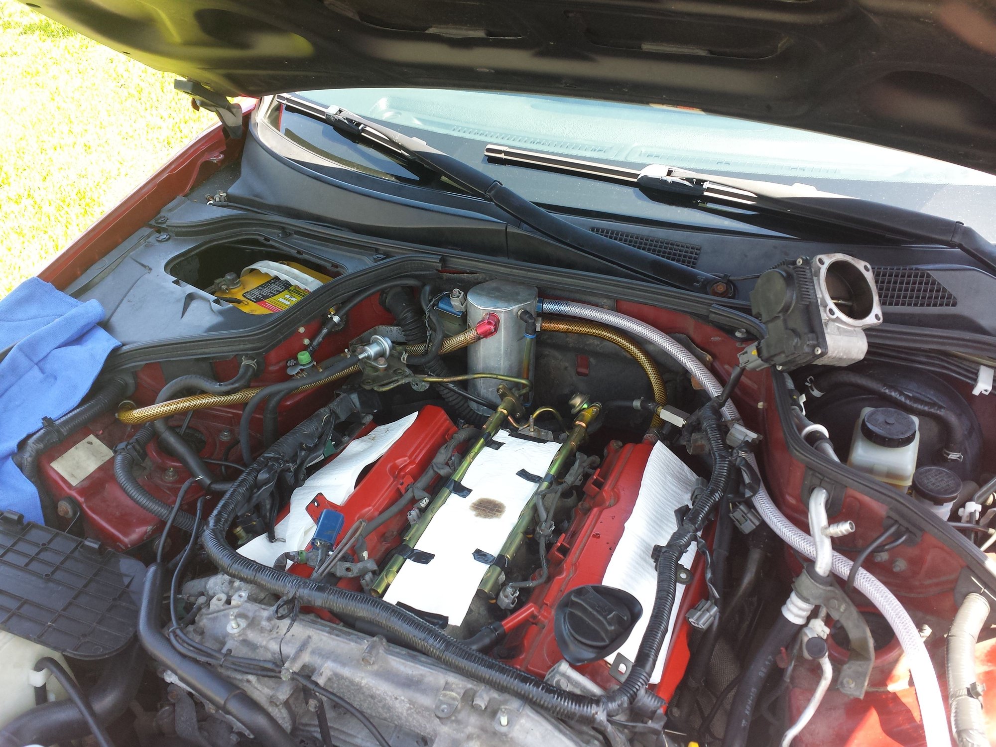

That catch can is coming out. Needs more work.

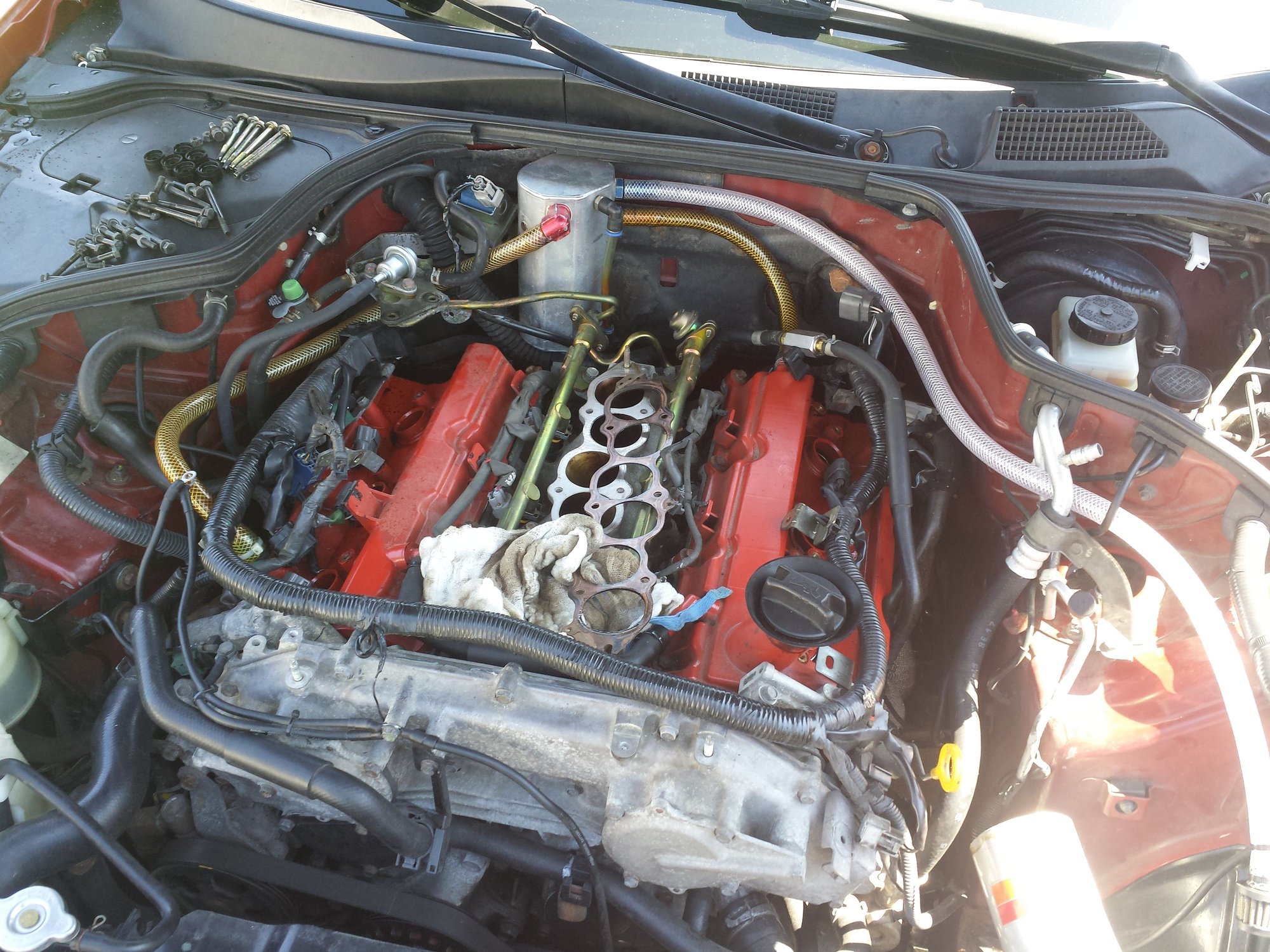

Compression testing. See the TB plugged in.. the paper towels are so the oil in the cylinders and spark plug tubes didn't spray. I pulled 40cc of oil each out of 4 of them.

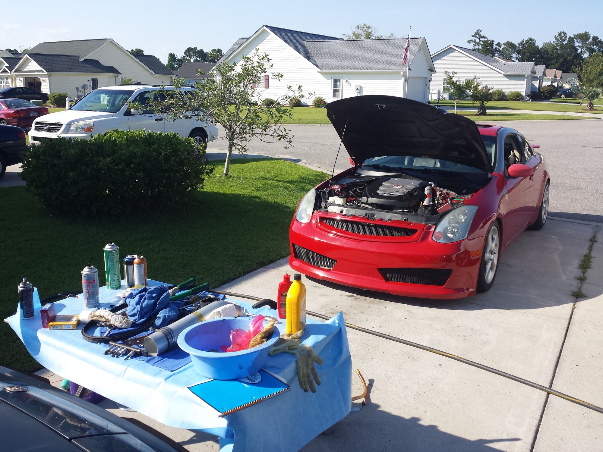

Looks like I'm at work. . OR table
Organized chaos.
