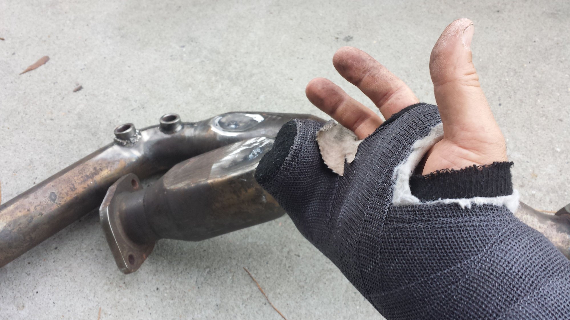

WTF?!
Buhh bye

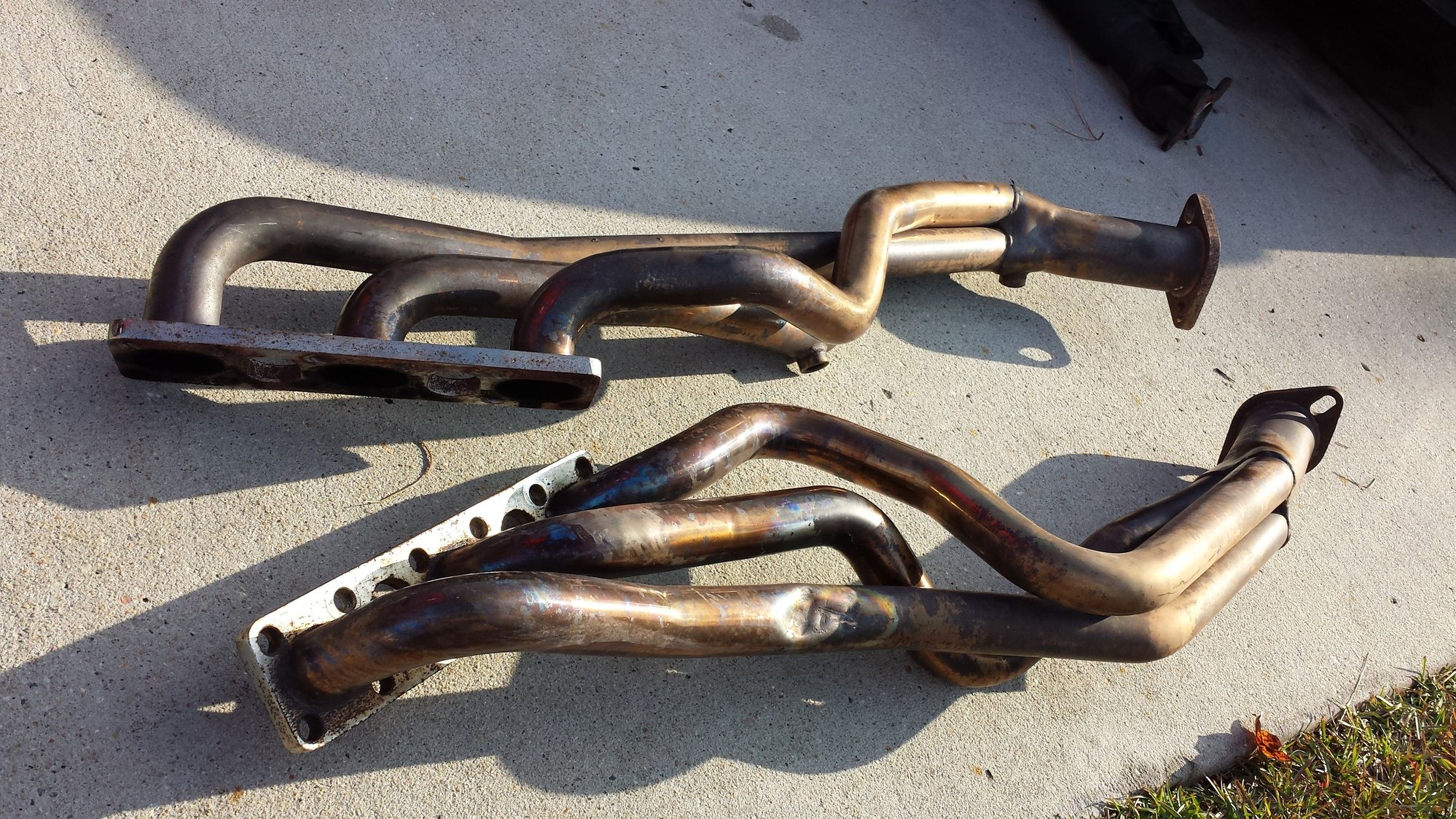

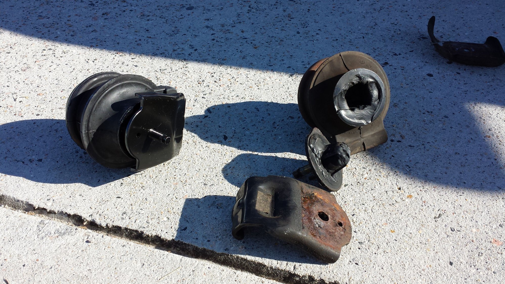

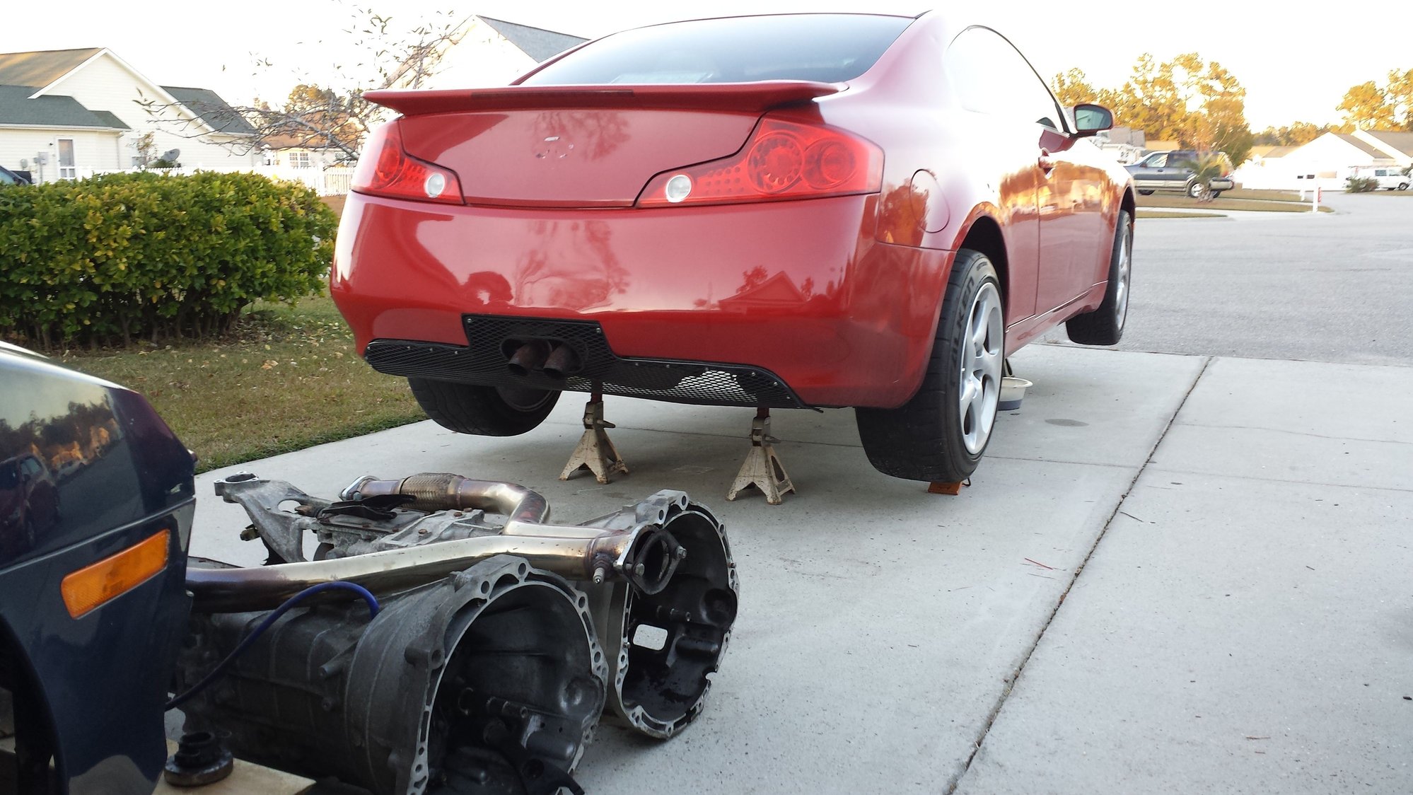

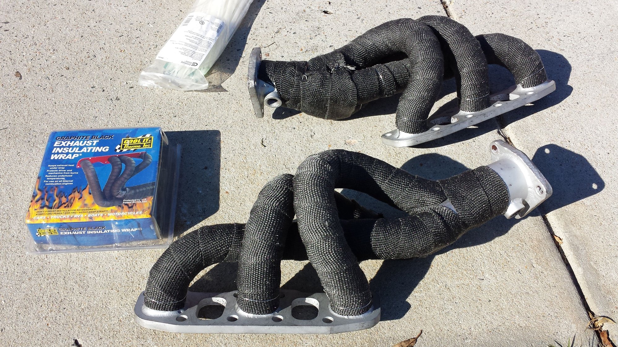

Driver side motor mount came apart in my hands when I took it out. good time to replace them. I took out the long tube headers because they kept me from getting the last transmission out and made a mess. Installed some shorty headers that are wrapped with resonated test pipes.
This is how she sat for days.
Broken right hand
Still doin'work. ..a little slower.

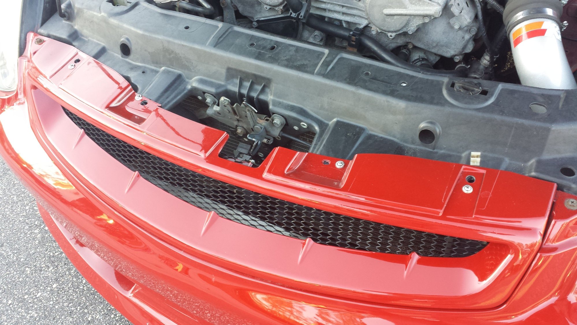

Originally Posted by TheNurse
Looking good epik, haven't been on for a while just saw the older posts, I really like your fitment on your grill, I got a matte black one and don't like it too much looking to get rid of it or throw it away lol
It just bugs me that it needs a little double sided tape on the bottom or it might be that I'm not installing it right.
Loving the whip, looks happy and flying haha
my grille was flat black also. I had it painted along with the bumper. Fitment took awhile.. I actually ended up using stainless screws and washers. Can't see unless the hood is up, and looks fine if you do see it.

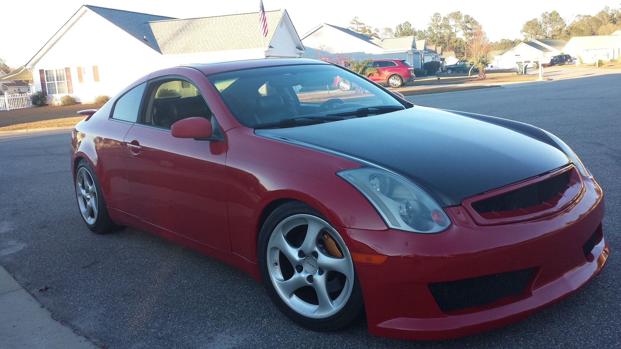

What a beautiful sight. ..back on the street
Hey Nurse..here is a shot of the grille mounting

i have always been a fan of those wheels. i like em a lot on the g, though id prob run em with infinti caps. are you running spacers on those? are they light?

Originally Posted by Tyke420
You need some nicer wheels to compliment those B-bos. Color match the hood would be nice too. Just my opinion. Other that, seems like you've put some TLC into it. Nice work, and keep at it!
Great work man. It turned out a lot nicer than I imagined.
At first I didn't like the wheels and black hood like Tyke said, but on the ground with the drop and the front bumper, it all flows pretty well aesthetically. I didn't notice the rear bumper/exhaust setup before as I haven't followed the build thread, but it looks very unique. Although I would've gone with a straight tip instead of the downward one. But overall, great job on the build. Looks like you put some time, effort, and $$ on this.
btw sorry to hear about your injury.

The exhaust is a work in constant flux.. the downward turned tips are for a few reasons, to try and keep the rear bumper less sooty, and to give an exotic flavor. The borla muffler is canted up at about a 30* angle in the dead center, so the tips work with that too.
There are 2 versions. mine are the non-hollow (heavier/cheaper) but they are Porsche OEM from a 97 C4S. The high$$ ones are the same size and spec (18x8, 18x11) but made by BBS and have hollow spokes. Those are the wheels on the Turbo..somebody before me put the turbo caps on.
I had spacer adaptors made from US Adaptors, they are perfect and even had them fit OEM Porsche 14mm lug studs in them. Using Porsche Fuchs lug nuts now too. Well spent $200 for that set of adaptors. Best thing is, there are ALOT of Porsche fitment wheels that are wide open now.
I can always use them on Porsche 944 also if I get bored on the G

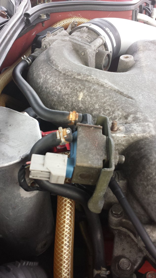

I drove it a little last night, trans shift nice and smooth. I cleared all the fuel settings in Osiris and romped it a bit. Butt dyno says a little more low end, which it should be.
I got a CEL on the way home, so booting up Cipher tells me that the evap solenoid I replaced with one from a newer Z, does not work on my 03 G. code p1444
I broke mine removing the trans.. because of where I hid my catch can, when the engine rocked backward. I fixed mine last night, out of town right now but I will toss it in the car when I get home and give it a run.
