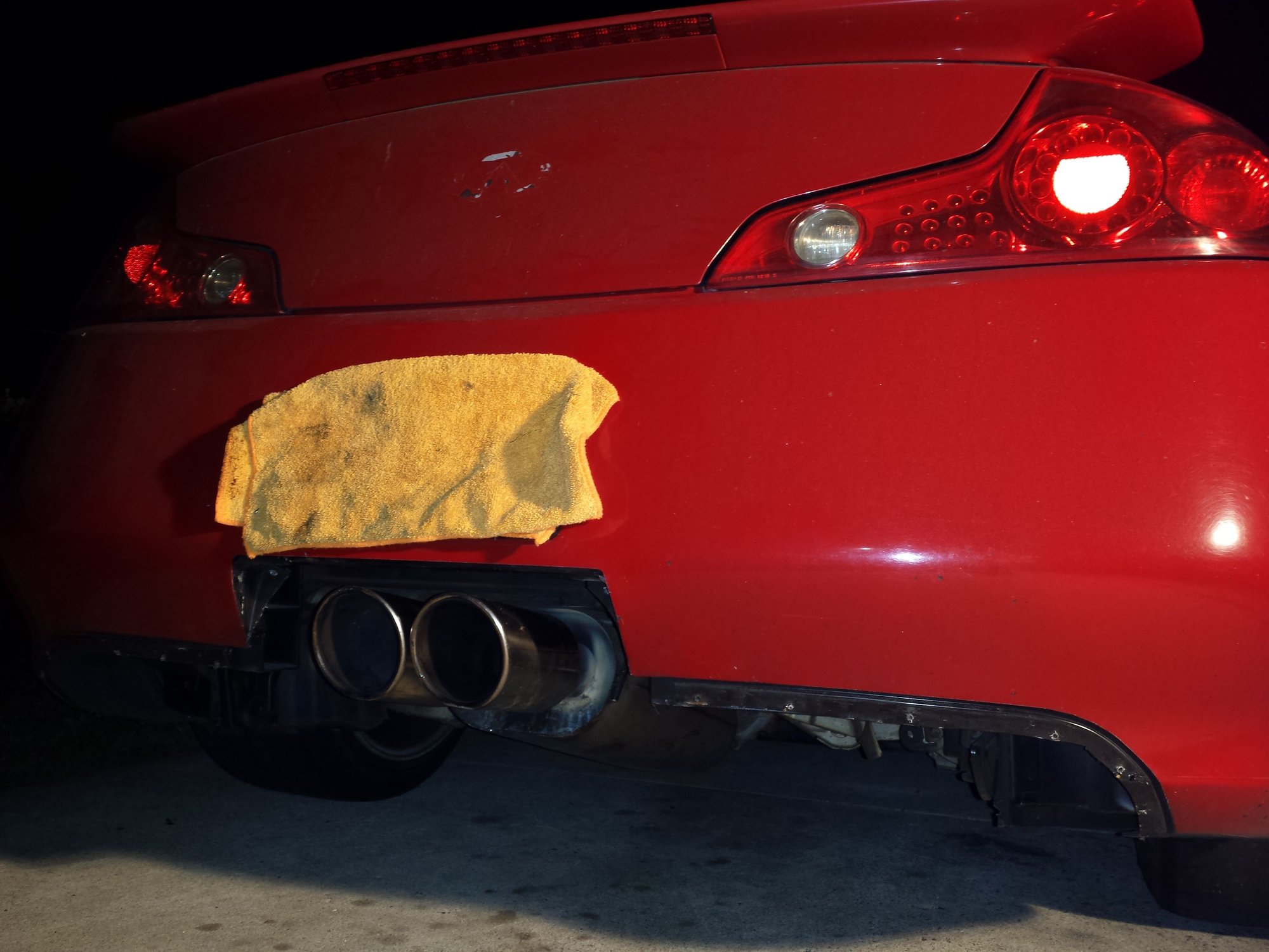

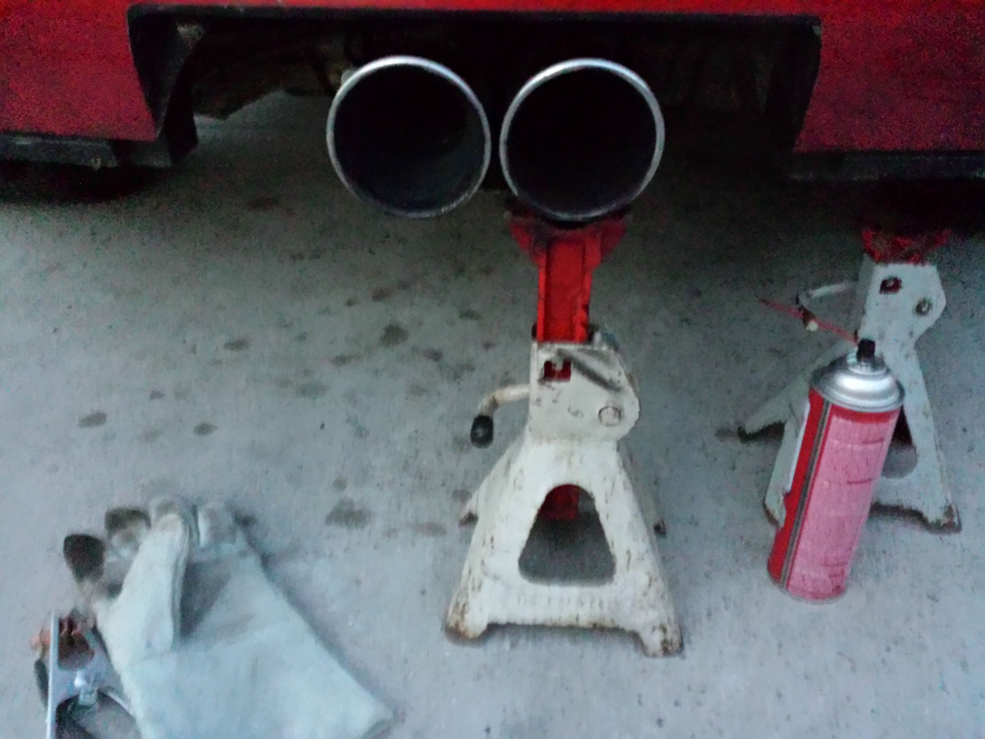

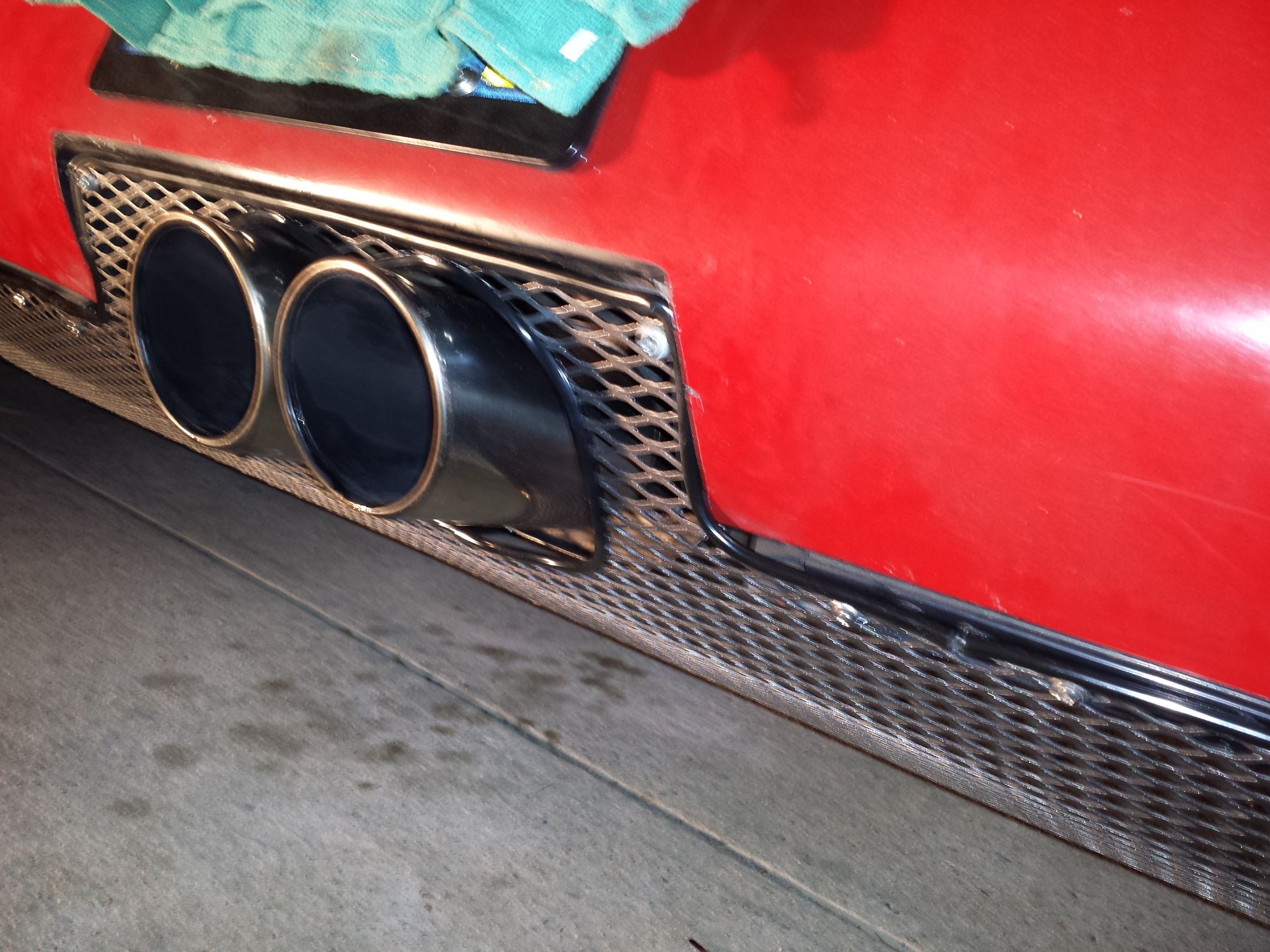

Decided to do some work on the exhaust. Finally found the tips I wanted to update from the bent tips.
I need to refit the diffuser grate to finish it off.
BlueD... the car feels great now. The handling is tight as a drum and the alignment is _near_ perfect, but I have some ideas to improve it some. I like driving the car again, that's why I'm showing love on the exhaust today.

Also finished the grill trim for the exhaust on Sunday, so that is a positive update.

so does the license plate not have any external lighting then?
